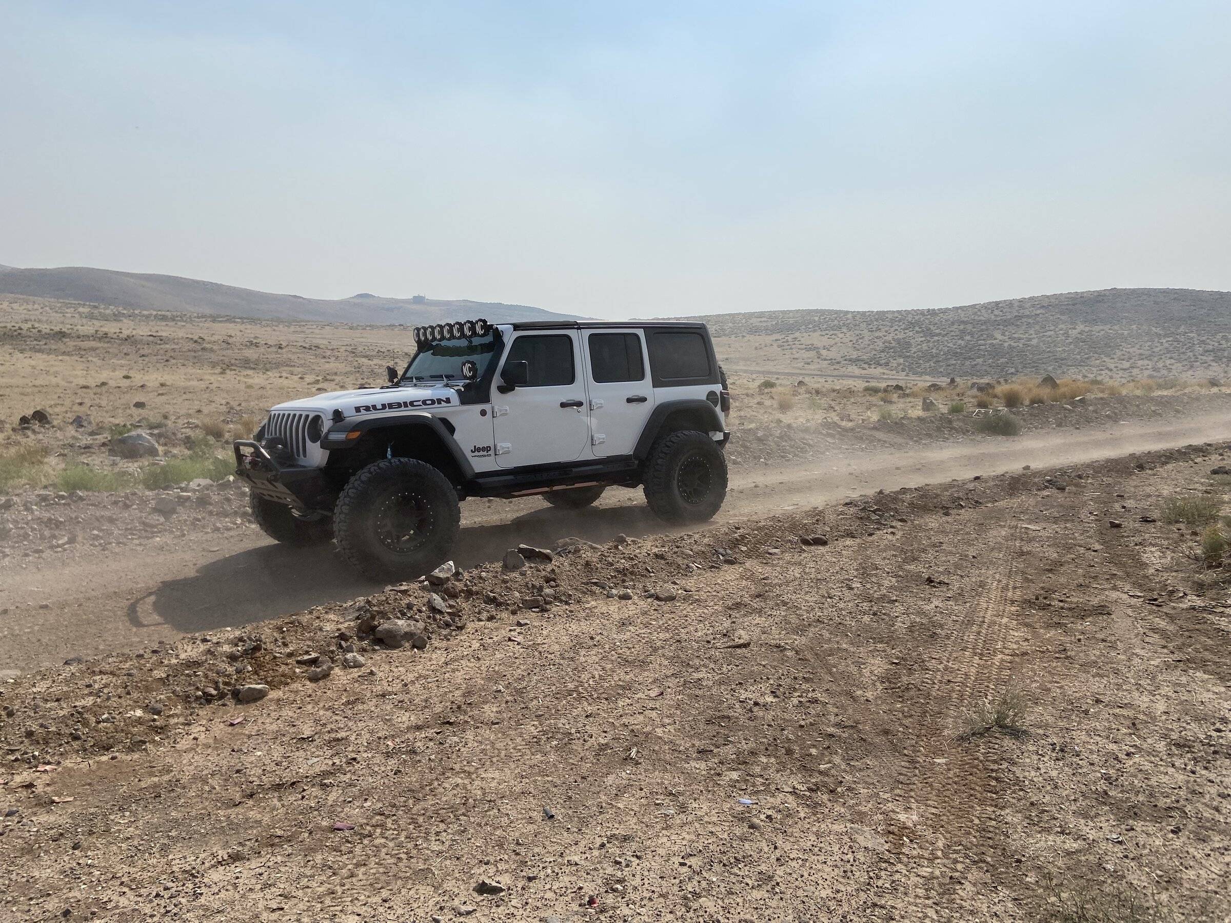

I take my jeep out a lot on very dusty roads and trails here in Nevada. I learned to keep the hard top on and windows up when driving faster. If you drive slow you can have the drivers window down and maybe the passenger window also. Dust will get in and cover everything with a fine layer. I use either compressed air or micro fiber towels to grab all the dust.
Jeep Wrangler JL Dust galore in interior 86A1FD40-5382-4D81-8990-4D7CCB440179
