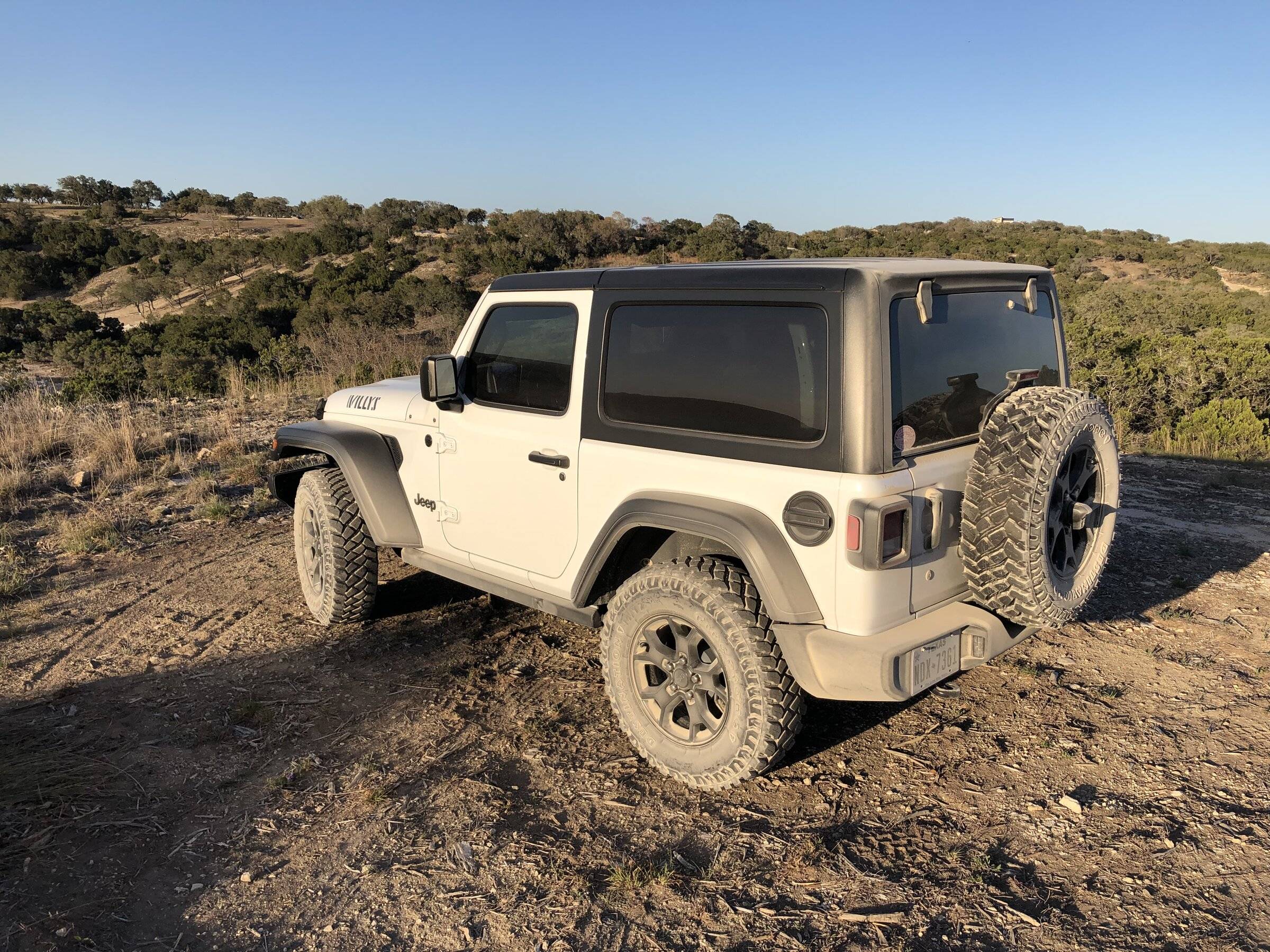

You have a leak somewhere. A couple of weeks ago I was on some seriously dusty trails. Very dry, fine powder. My interior was very clean afterward.
Jeep Wrangler JL Serious Dust intrusion on JLU. 4A66E2BA-7A1F-4D2B-9CDE-480E3EB85564
