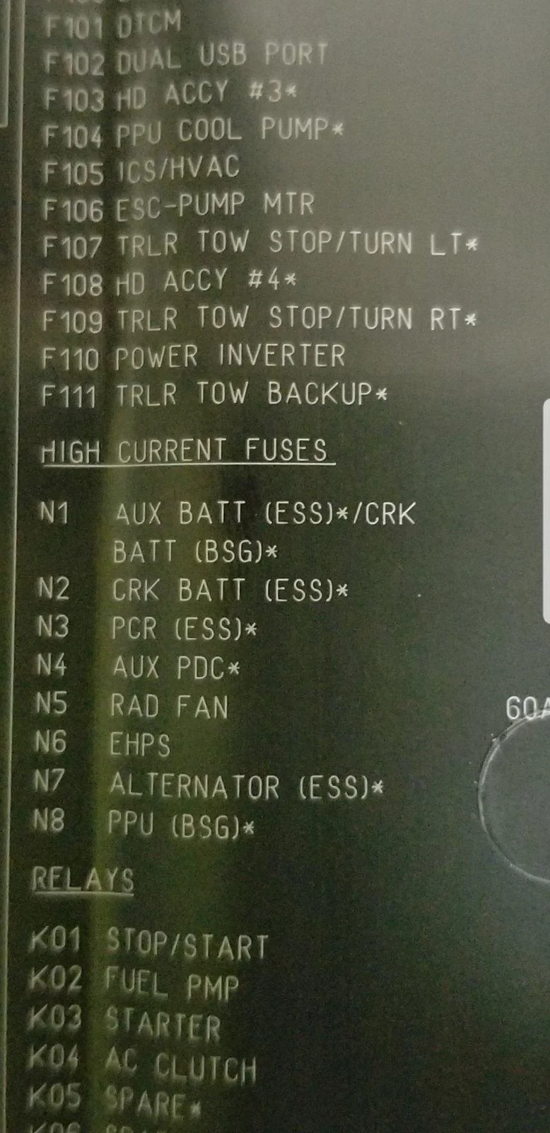

Found N1 and N2 with very low voltages.
Dont recall exactly like 11.1 and 4.2
Under the fuse box has these identified.

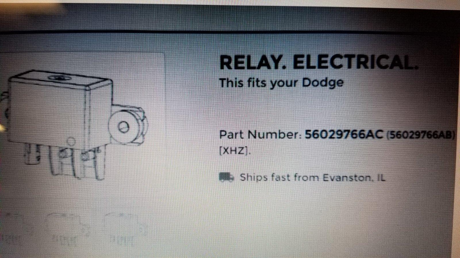

Next day dealer replaced ess relay.

On the fuse cover it lists N1 and N2 as the main and aux batteries.

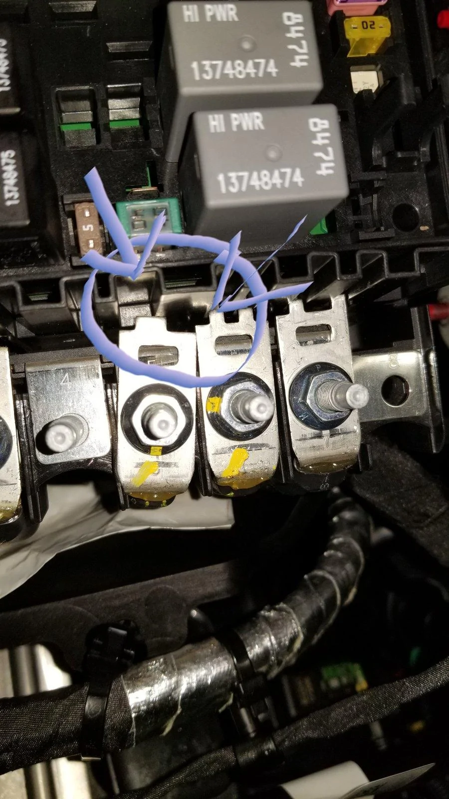

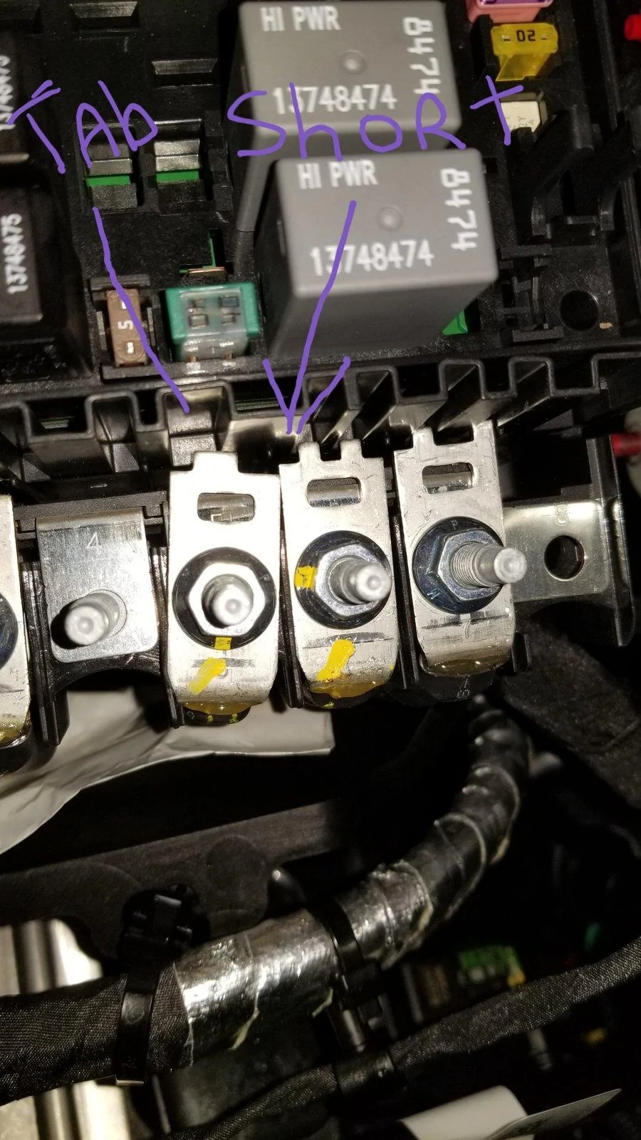

When i had a no start condition had 11.3 on N1 and 4.2 volts on N2 only after slow charging both was i able to get it to start.
If you look closely at the pix posted, i has N5 and N6 terminals touching and tab on terminal not seated in groove.
After ess relay was replaced. Had 13.2 and 13.8 on main and aux battery after good trickle charge.
I did reseat the touching terminal properly.

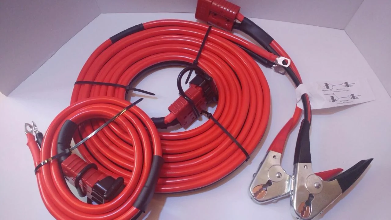

With no disrespect intended to your findings Jebiruph, this was the YouTube video--maybe you the same--that lead me to believe that terminal 5, a.k.a. T5 in the PDS (Power Distribution Center) has a cable connected to it that leads directly to the smaller/auxiliary ESS battery.
With this in mind, I own a bunch of charging cables with either alligator clips or eyelids at one end, and quick disconnects at the other end. They look like this.
Jeep Wrangler JL Drained Battery, Any jumpstart tips?? quickconnect
Yesterday I connected the smaller cable's positive to T5 in the PDS, and the negative to the main battery ground and left the cable under the hood that way.
I have no idea, should I run into a dead ESS battery, if hooking the larger cable to the smaller, and the alligator clips end of the long cable to a 12V DC source, dare I say, even my own main battery, will it allow the rig to start. Honestly, I'd rather not tinker with a $50K piece of gear to find out my answer and risk damaging things.
