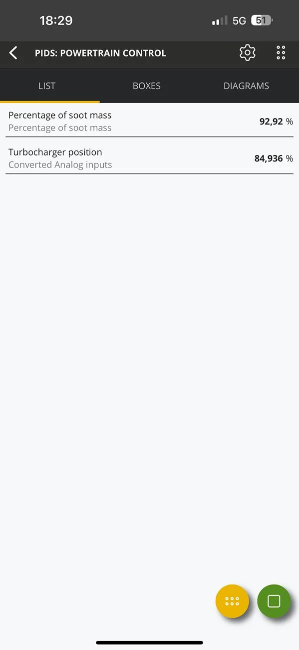

At wich soot percentage does the 2.2 diesel do a regen of the DPF? I am currently at 92% soot mass (Jscan).

I was completely unaware that there was such a thing as a 2.2 diesel so my opinion may be way off. I would assume a regen would've been triggered before 92%; seems a bit high.

I have a 3.0 eco-diesel and it triggers at 80%, I think you should be similar. If you have the J scan app, you should be able to force a regen

My 3.0 would not regen at all, I had to use jscan to regen it. The level was 89% when I finally got it to regen after 10 tries with jscan. The stupid thing would error out every f-ing time.

I am on my second DPF as my previous DPF broke because it never did a regen. Since it set me back €3000 I monitor the soot level. At the dealership they told me it did not do a regen because the DPF was to full. I hope it will do a regen soon, otherwise it will throw a engine code and it will go into limp mode again.

I did a drive today and it went up to 95%. After i checked the soot percentage after the drive it dropped to 20 %. So I think it triggers a regen at 95% what seems high

You may not have been driving long enough to get the system parameters set for a regen. I have found with the 3.0 that short drives fills the def up fast and won’t trigger a regen. It will also trigger a regen on very long trips even of the def level is well below the 80% mark, as low as 20%.

Strange, 60% of the distance I drive are on highways with speed limit of 75 mph. It is true that it fills up fast when you drive a lot in the city.

I always check the regeneration status using the Car Scanner app (this type of engine requires a lot of attention). When it reaches 100%, it starts regenerating. I've attached a screenshot of the app, which is also compatible with CarPlay.
Furthermore, if you see that it reaches 100% and activates mode 2 (i.e. active regeneration) do a few more kilometers (or miles in material) and you will see that it will return to 16%.

Mine also drops when at 95%, and goes down to around 16%. Looks like highway driving only slows the buildup. Never seen a decrease in soot percent while passive regen is active.

I paid the last weeks more attention on the behavior of the jeep when it does a regen. It sounds a lot more muffled. I also notice when I accelerate and it requires more boost from the turbo I hear a whisteling sound like a bird under the hood. And the transmission or engine gives a yank when the regen starts like it hesitates between 2 gears.
I also started using premium diesel (total excellium) instead of the cheapest diesel and there I noticed the soot percentage rises less fast and the engine runs more quiet.
