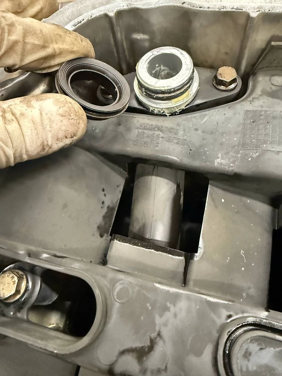

That sounds a little long, I do mine at 10,000 or before. I also had the JTD performance oil seal fitted. To prevent the common low oil pressure issues. This shows the difference between the mod and standard.
Jeep Wrangler JL DPF - Active vs Passive regen IMG_9432

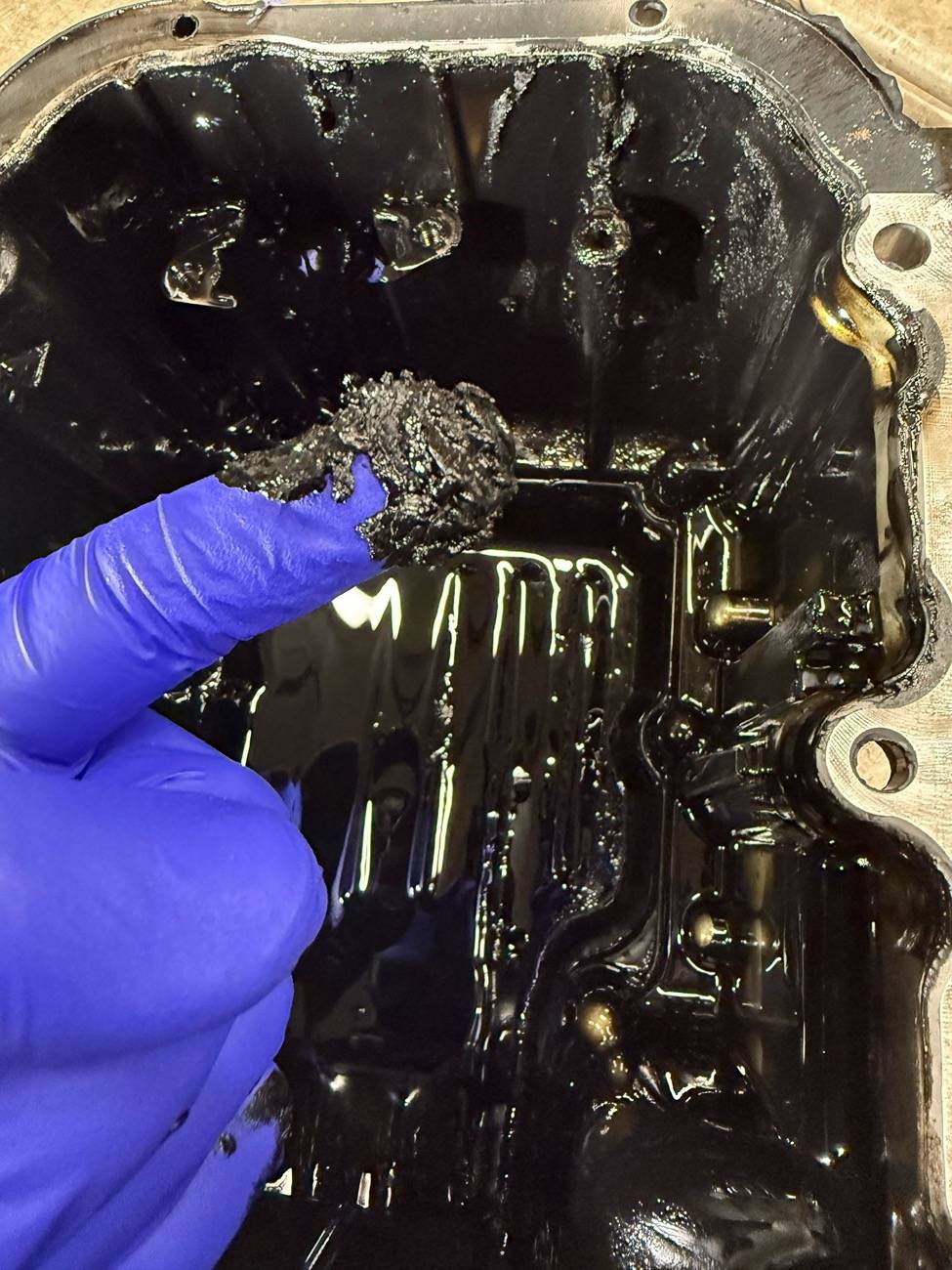

This is a vehicle that followed mine. A 2.2 diesel that had unknown service history. It had low oil pressure due to the seal. The dealership replaced the oil pump which made no difference. They completely missed the state of the sump.
Jeep Wrangler JL DPF - Active vs Passive regen 0b9dee94-c23d-4f36-8e7a-3997ae0599c6

I’ve actually never heard about the low oil pressure problem, is it so common and what causes it?. The dealership uses long life oil that should last arourd 20.000 kms. One remarkable thing i always notice is that the engine consumes alsmost no oil, i never have to add oil which is a big difference when I compare this with the other 2 liter diesels I owned in my life from other car brands. Now I have 6000 kms left on my oil but I am going to change it next week.

20km is way too long for this engine, or any engine. Just use regular oil and change it each year. No point in spending 15k on a new engine later to be able to save 100 bucks on an oil change now.

It is a common problem but not one of those almost guaranteed issues you find on certain brands. I just think think it’s best to do the JTD seal upgrade on your next service. It’s more labour removing the sump etc but other than that relatively simple. Peace of mind more than anything. Particularly if you’ve got long term plans for the jeep.
