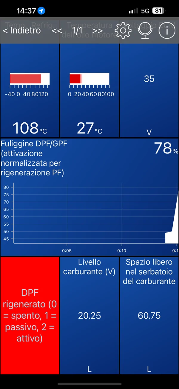

I always check the regeneration status using the Car Scanner app (this type of engine requires a lot of attention). When it reaches 100%, it starts regenerating. I've attached a screenshot of the app, which is also compatible with CarPlay.
Furthermore, if you see that it reaches 100% and activates mode 2 (i.e. active regeneration) do a few more kilometers (or miles in material) and you will see that it will return to 16%.
