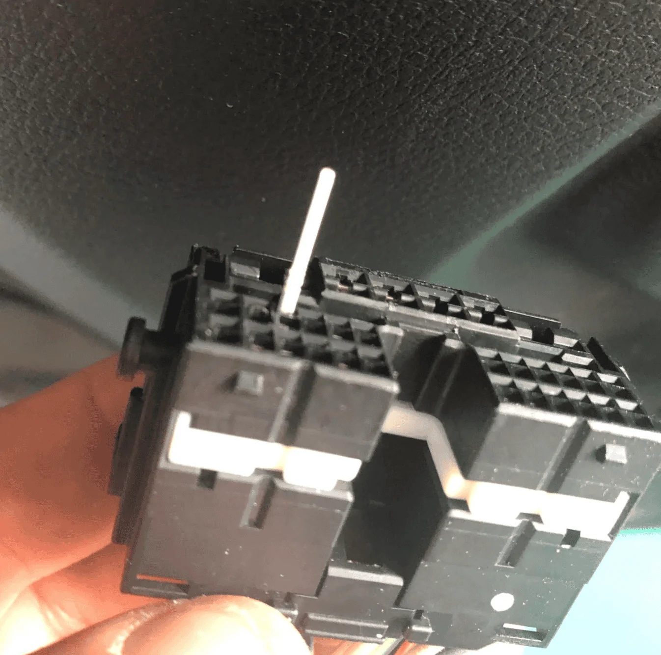

Did I destroy this? I just pulled it out and this happened? Now every 5 minutes with fronts off it says "Not in Park":
Yeah that connector seems like a break waiting to happen. I try my best to minimize how often i have to touch that thing., Thus I leave my doors off from may to October.
