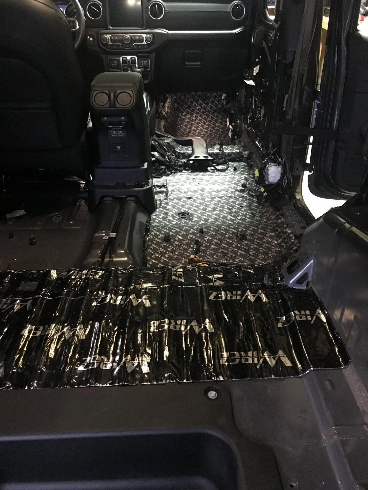

Yessir, I placed eight 5x5 squares in a pattern inside driver and passenger. Gave it a nice thud sound when closing now and a lot less road vide projecting through to the inside.

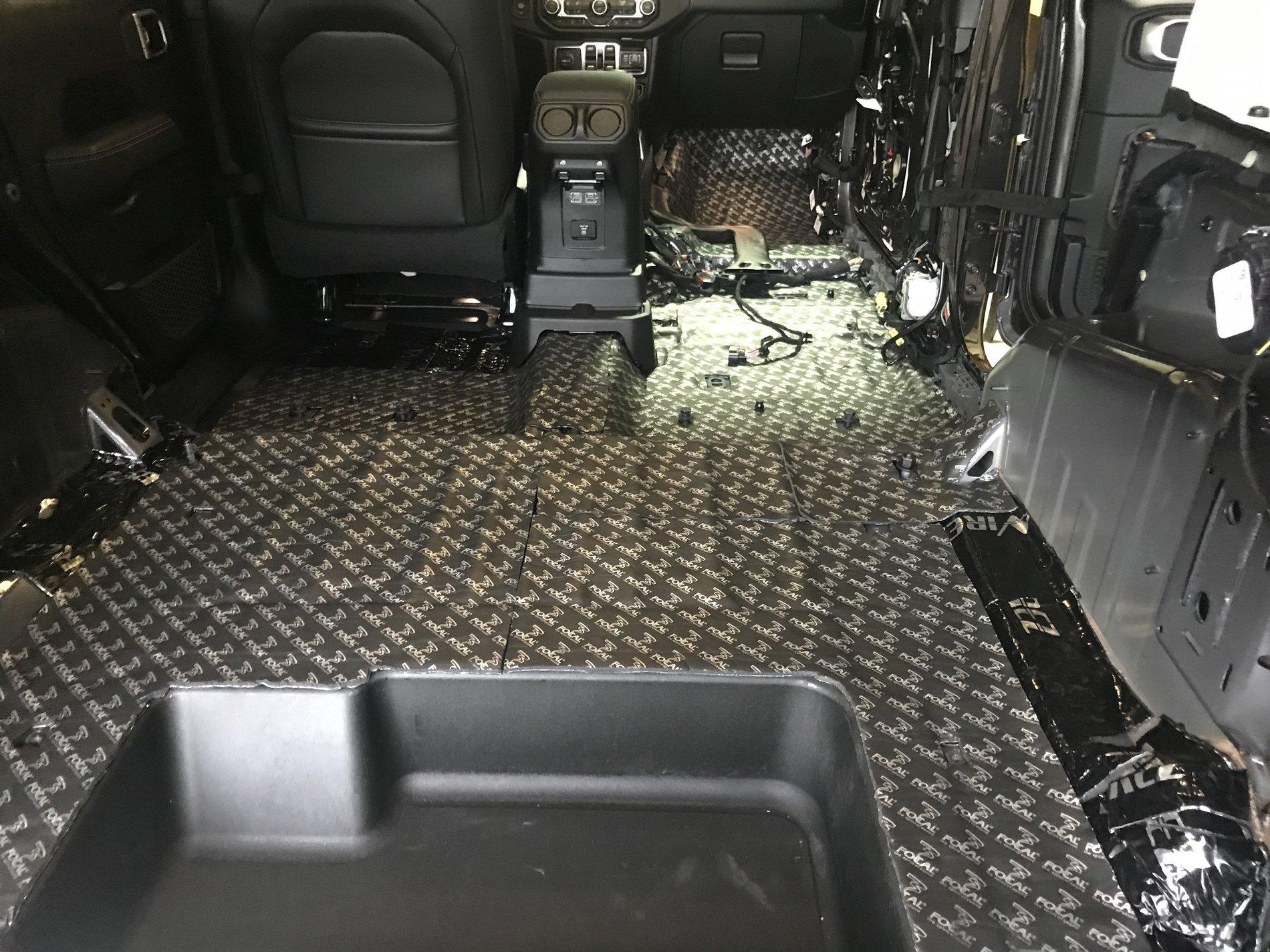

So far I’ve used two 36sq ft boxes on this vehicle. Added about 50 lbs to total weight. It’s night and day difference driving down roads now. You can hear a pin drop on the carpet its so sealed up.

That's awesome, I will definitely do the doors then. Where else have you done?

diffidently worth doing i did two layers second with focal bam..
You should do the storage tub too, that thing has bad resonance. Or maybe just do the underside of it. It’s exposed under the vehicle.
