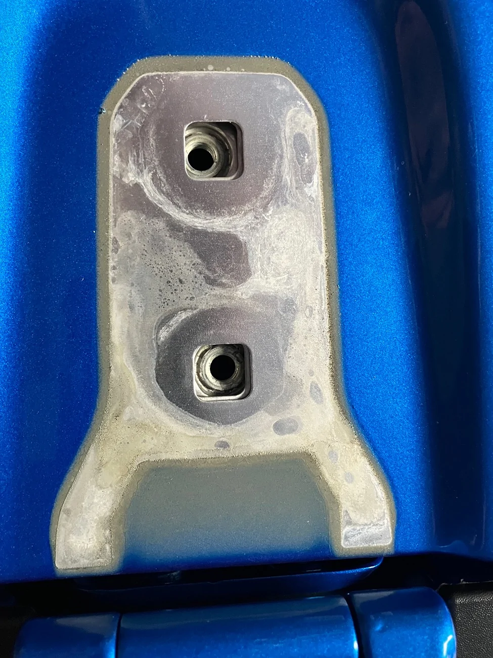

Galvanic corrosion is just not that powerful. The hinges are attached to raw metal if the jeep, then painted over in the production process. One little crack in the paint allows the the raw aluminum to oxidize under the paint and the let the bubbles begin. I know there are a ton of folks who just want to blame galvanic corrosion, but the aluminum oxidation process is much faster. Just replace the hinges , seal the raw aluminum and use a marine grade grease on the bolts to satisfy the galvanic corrosion gods, and call it a day. The edge seams will experience additional issues unless you seal off the interior of the seam inside the door.
you can see aluminum oxidation under my hood hinge.
