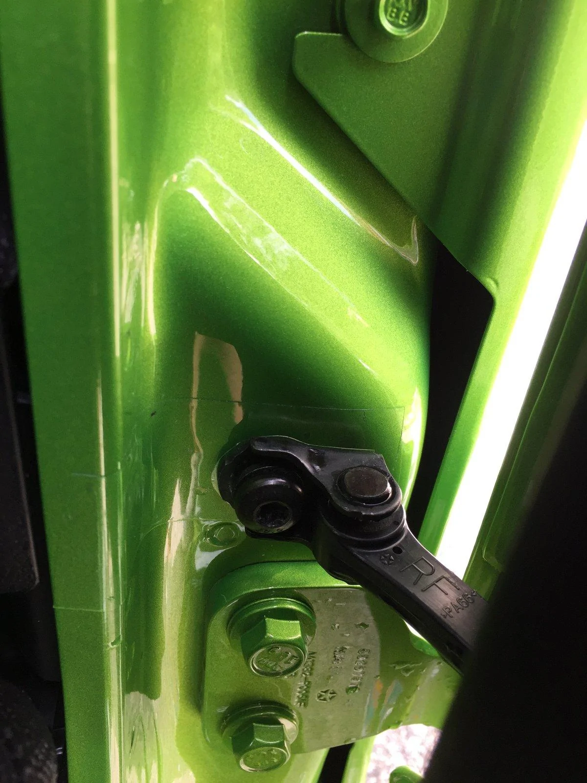

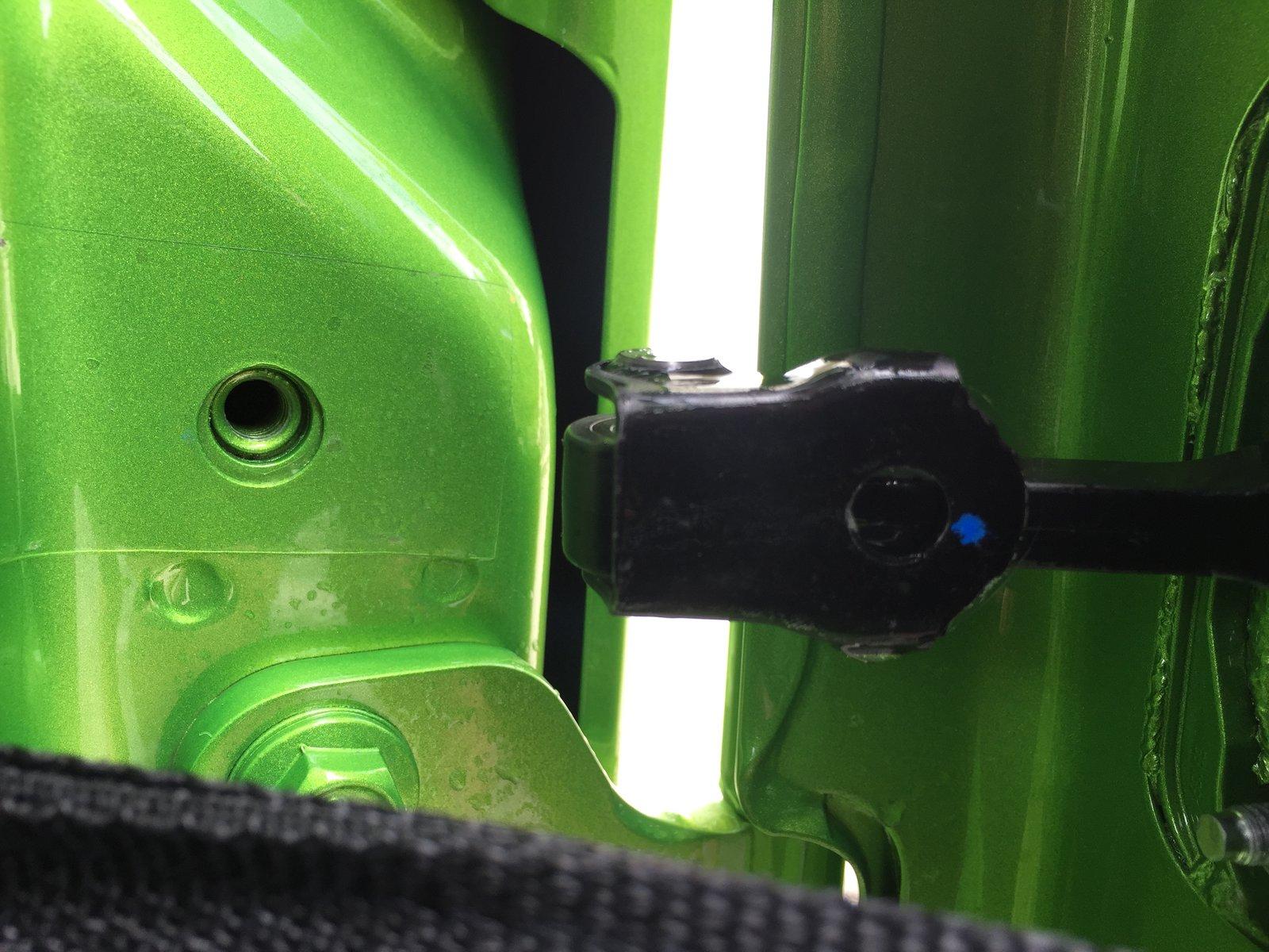

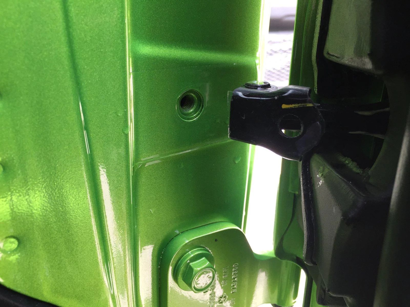

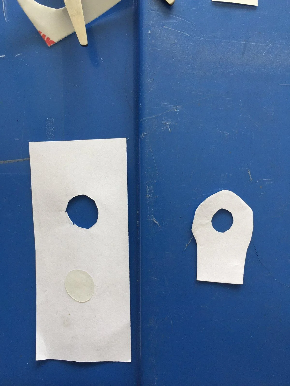

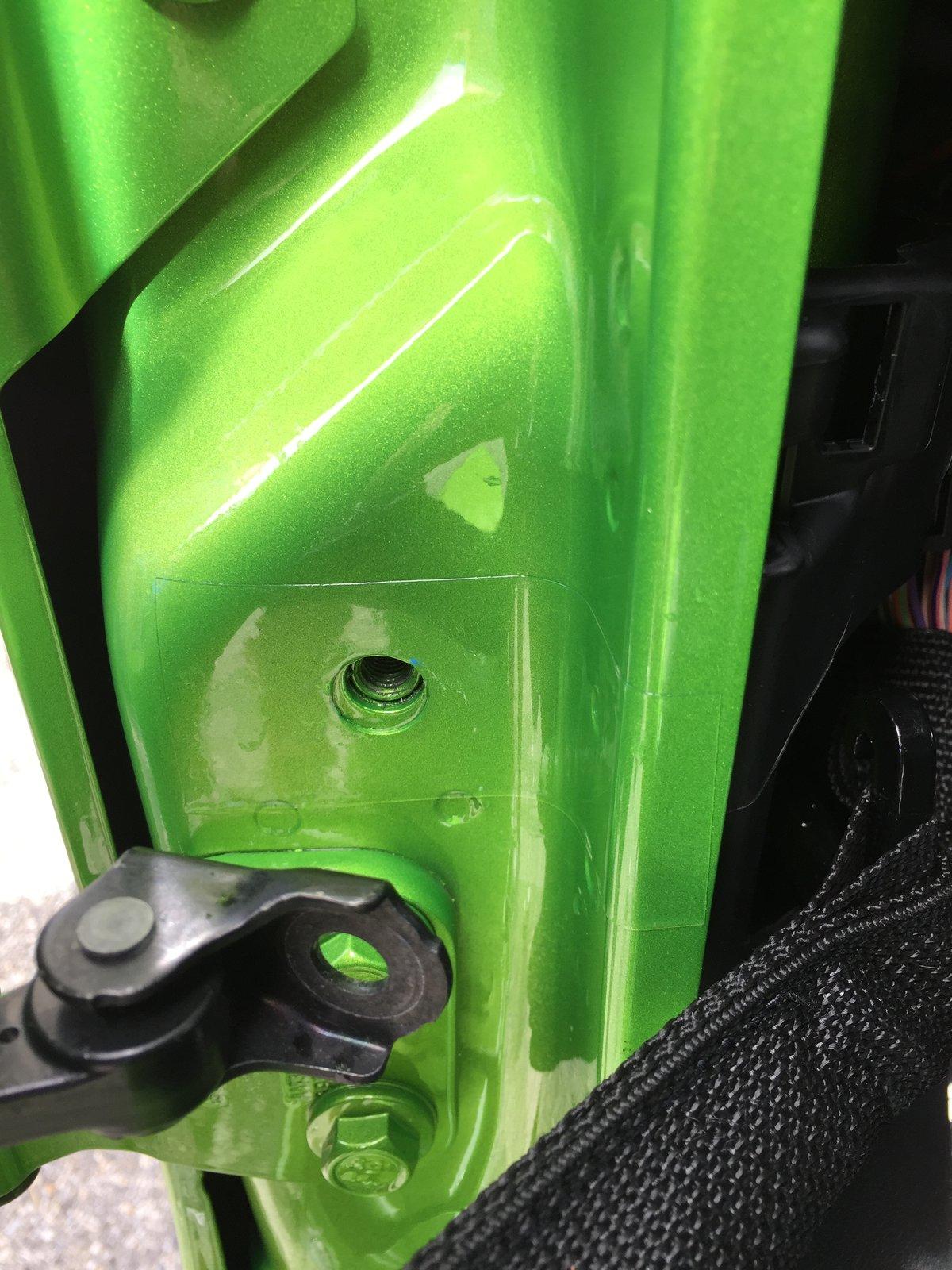

When I took my front doors off, I noticed the door positioner seems like it could scratch the paint very easily with the slightest error. Since I bought a roll of 3m scotch guard film last week for the door sills, I figured I’d try protecting this area too. I cut a strip to cover the area that’s painted. I cut another piece in the shape of the positioner mount and put it on there. So I have 2 layers of the film between the paint and positioner mount. I don’t know if it will work, or how long it will last. I also don’t know if it will look crappy when I take the doors off. But it looks good now and in theory seems like it should help.
Here’s a link to what I bought:
3M Scotchgard Clear Paint Protection... https://www.amazon.com/dp/B004VG6SWS?ref=yo_pop_ma_swf

Good thinking! We protect those areas often. Let us know if you ever want to try a piece of the XPEL ULTIMATE PLUS if those were to fail or get damaged too much.

Wish I had seen this before last week...one wrong move and scratched two of mine removing doors. Good thinking!

Welp! Too late for me. Mine are all scratched to hell. But great idea.

Well, that's just silly simply smart! I picked up some Xpel PPF for the door sills and should have enough to knock this out as well.
Thank you @Pic18 for posting!

The sequence I use now protects them, but I like this simple form of extra protection. I'm going to add it the next time I remove my doors. Thanks for the idea!

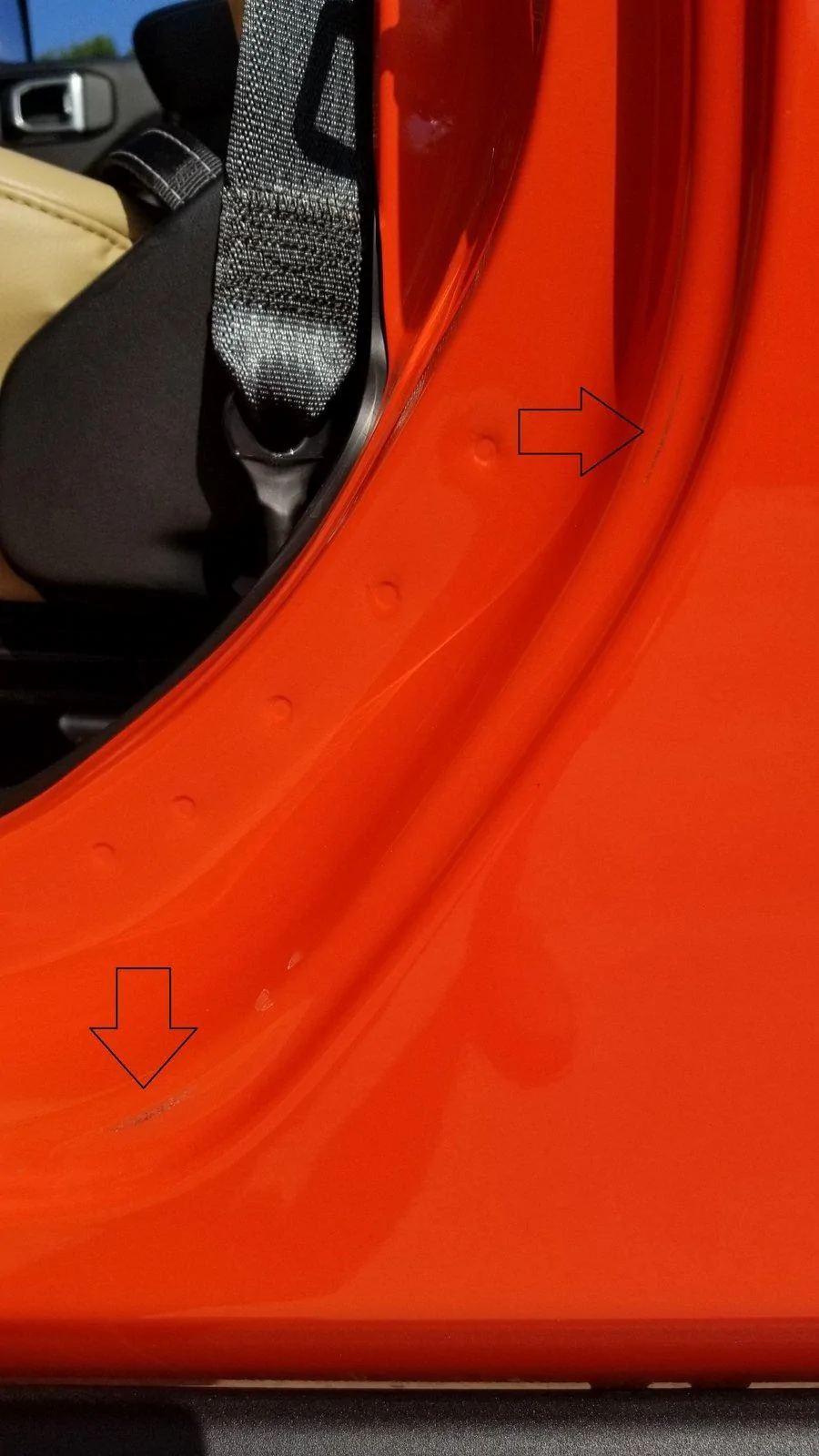

Does anyone else have these rub marks? I think from closing the door, the door hits the body. The marks are also on the door.

This is a great thread.
Is that rubbing of the plastic film or just rubbing of the door against paint?

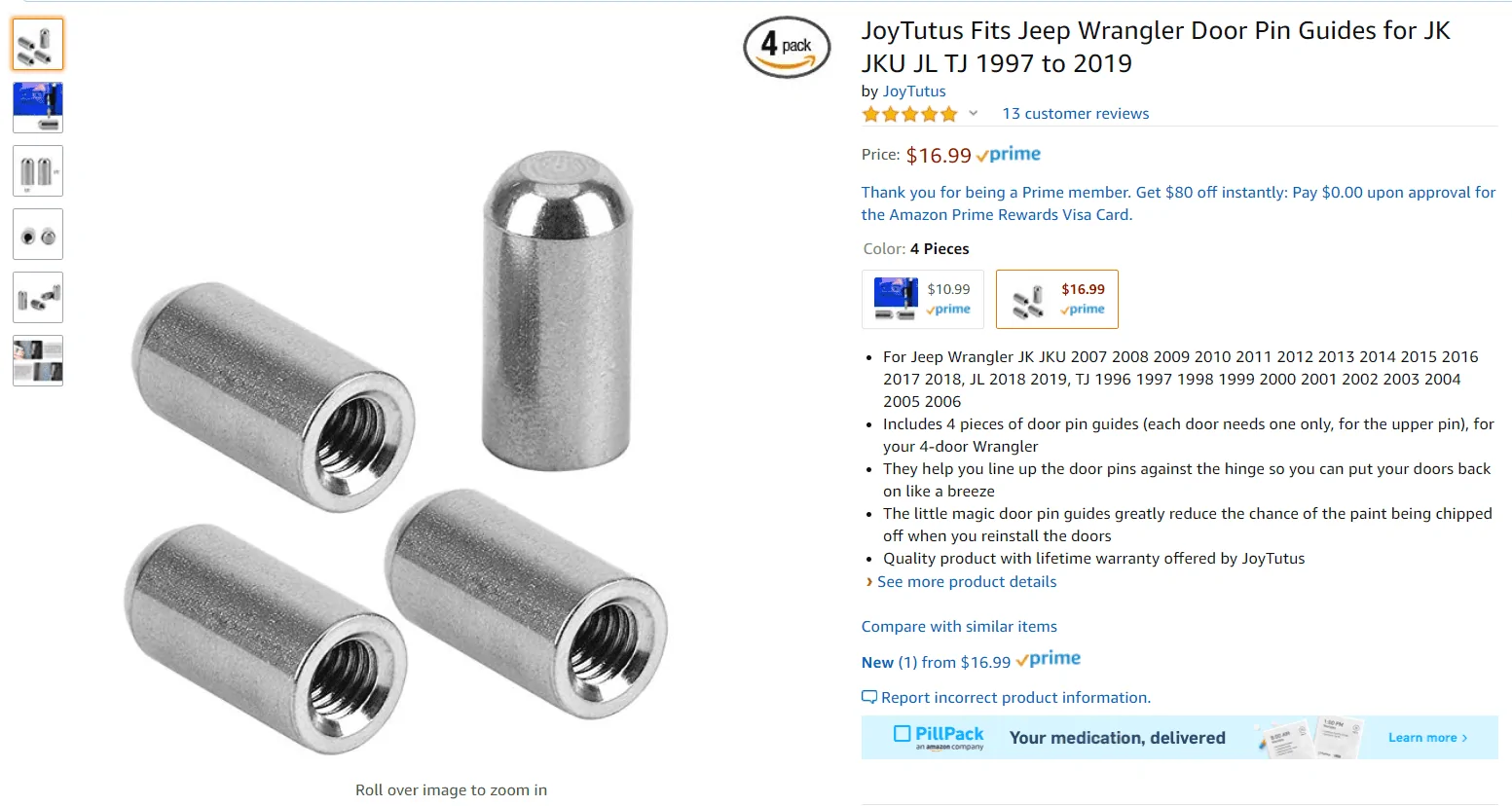

What do you think of these?
Jeep Wrangler JL Paint protection for door removal 2019-07-25_1046
https://www.amazon.com/gp/product/B07HFQNHNY/ref=ppx_yo_dt_b_asin_title_o01_s00?ie=UTF8&psc=1
