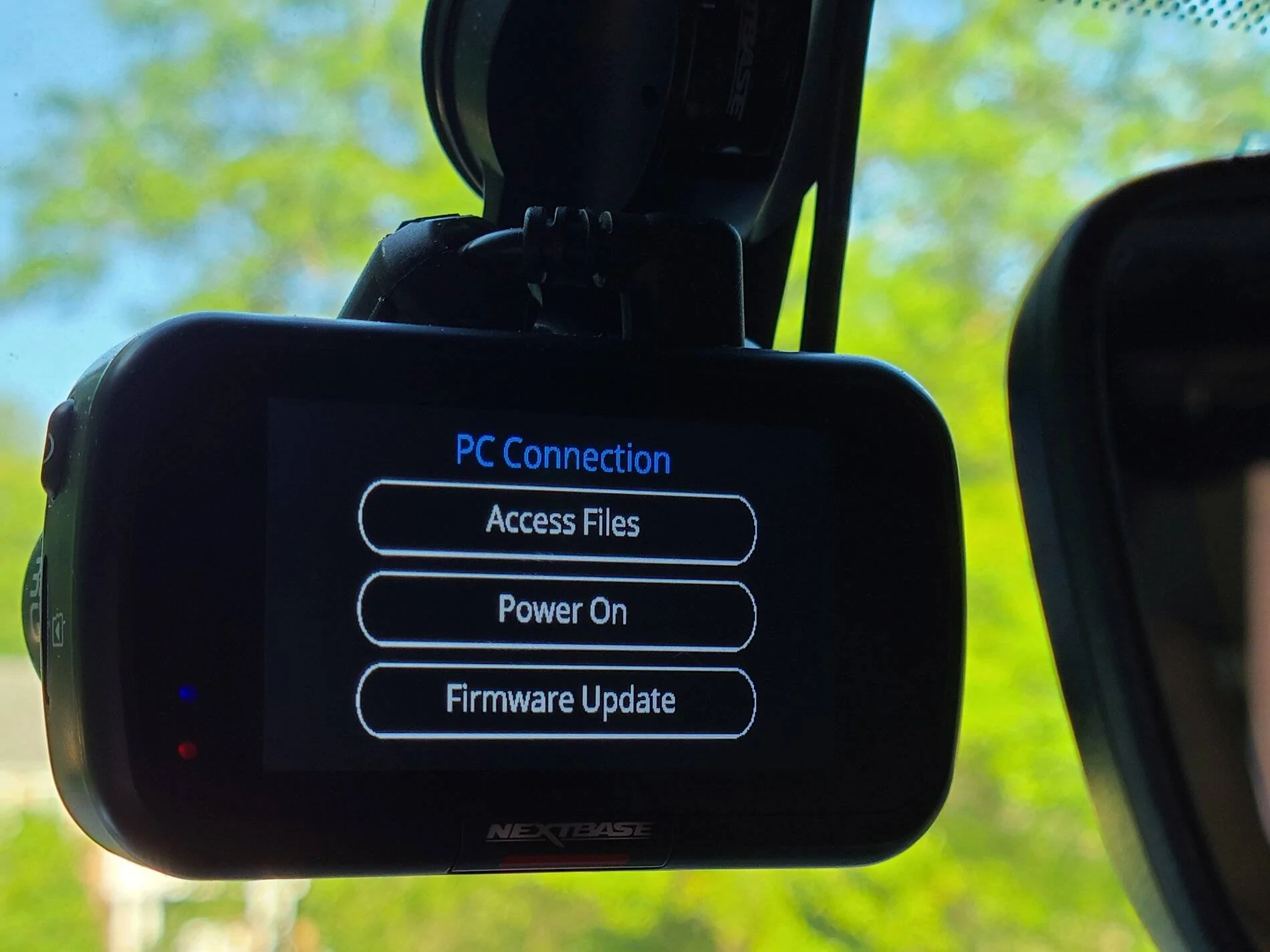

So starting around two months ago, at every start, the jeep screen would say something like, "This Device Not Supported " and require an 'OK' button push. Then the camera would pop up this screen,
whereas before it would just start recording.

But last week I wanted to look at an event that happened during a drive, and it turns out that even though I've been pressing "Power On" every day, it hasn't been recording, just showing a live-view. I'm glad I didn't need to rely on the system. Turns out I need to press 'Power On' and then the red 'record' circle each time.
Thought about it today, and it seems like the jeep and camera are now communicating on every start, instead of just sending power. I.e. the jeep sends a query at start, and the camera thinks a computer is trying to access it, so helpfully offers its file-access rear-end, which the jeep does not recognize nor want, because it isn't Contact list or a bunch of pirated MP3s.
Then the jeep says, "I do not know this person, nor do I like what is being offered. 'OK?'", and the confused camera says, "Well, you plugged into me, what do you want?" and gives the choices.

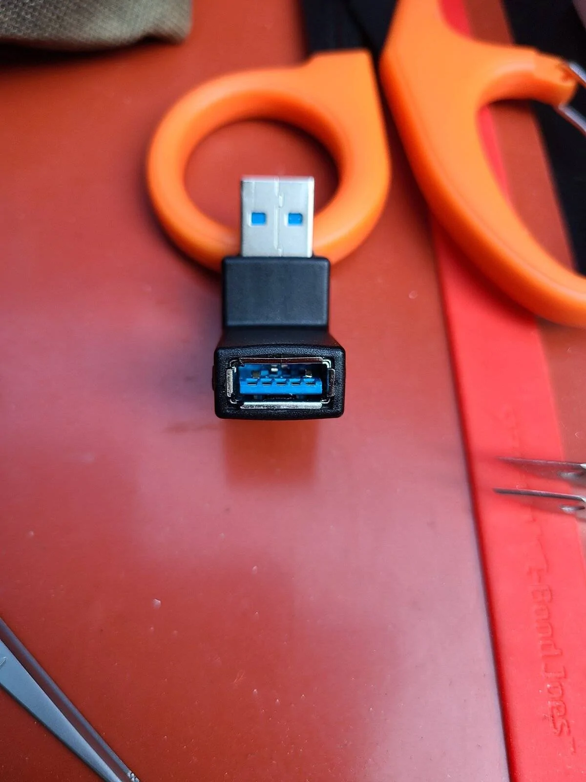

I ended up taking a right-angle connector and smushing the middle two data pins down:
Now they play nice again, and record upon startup.
This would probably fix other dumb cameras or devices that you just want to power and not communicate with.
