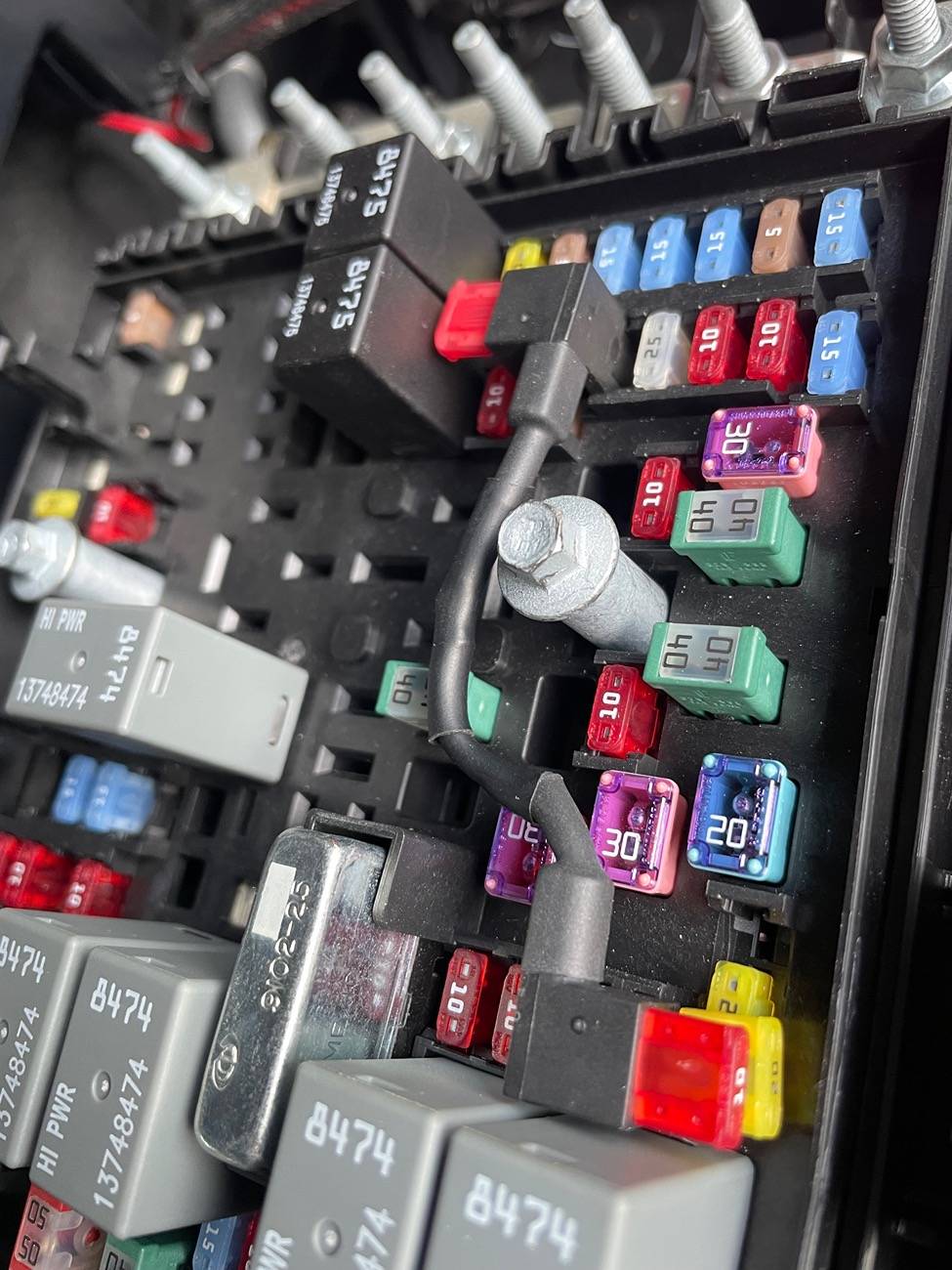

Used two add a fuse jumpers, soldered together to power the two front usbs from the front cigarette lighter supply, which comes on in accessory mode.
bought from
Autozone, but amazon is cheaper
Limited-time deal: Nilight 10 Pack Micro 2 Fuse TAP 12V Car Add a Circuit ATR Blade Fuse Adapter with 20A Fuse Micro II Fuse Holder Add On Dual Circuit Adapter for Cars Trucks Boats (50058R),Blue, Red, Black, Yellow
https://a.co/d/b60gF50
bought from
Yellow fuse on bottom is original cigarette lighter fuse.
The red 10a fuse is the original usb fuse but had to add another one to complete the connection, using top slots on the fuse jumper thingies
