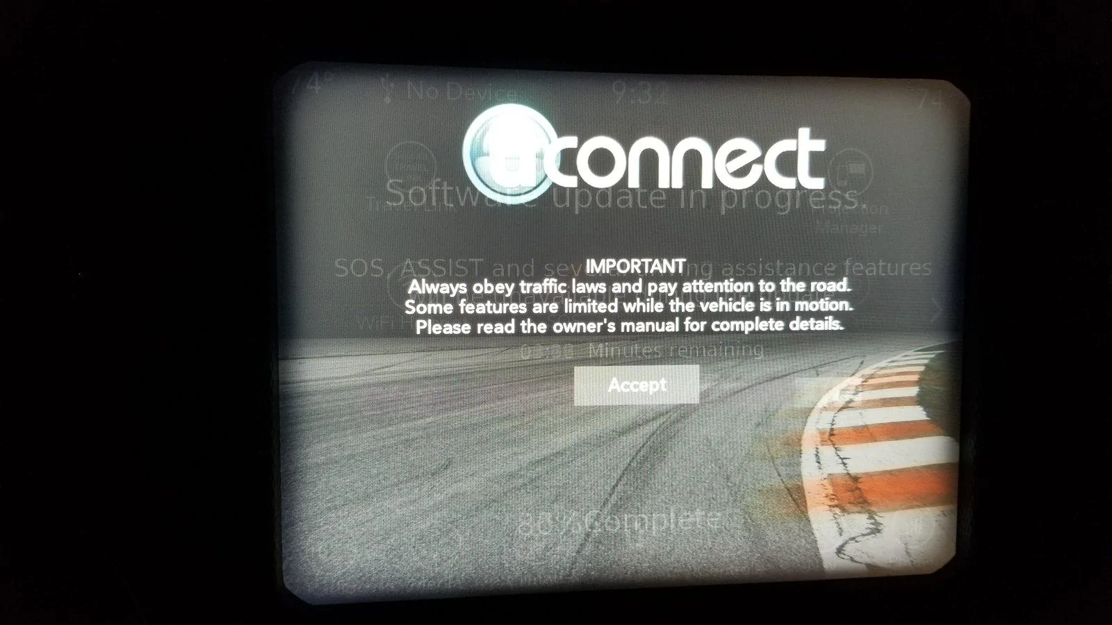

Do NOT do the uconnect update
RAZA
Jul 9, 2018
62
65
BC/WA
JLU Sahara, Granite Crystal
Bunch off B.S. It has that faint look because its still finalizing that install...it slowly fades as it completes...calm down. It's gone in a few minutes...
This. It's not actually burnin or related ghosting. It's a transparency overlay that's poorly handled during the update process. It looks suspiciously like burnin, but it's certainly not :)
Consider the static elements on any of the other screens with hours worth of driving and there's been no reported burnin to be seen anywhere as of yet.
Once the update completes and you do a full power cycle it's instantly back to normal. Without the fully power cycle the transparent overlay from the update process was still persistent for me.

So my update is still going on a week later? I still have the same shadow text on all my screens.
RAZA
Jul 9, 2018
62
65
BC/WA
If you are seeing multiple layers including the update screen you probably have a failed / incomplete OTA update.
Did you restart your rig while the update was in progress by chance?
