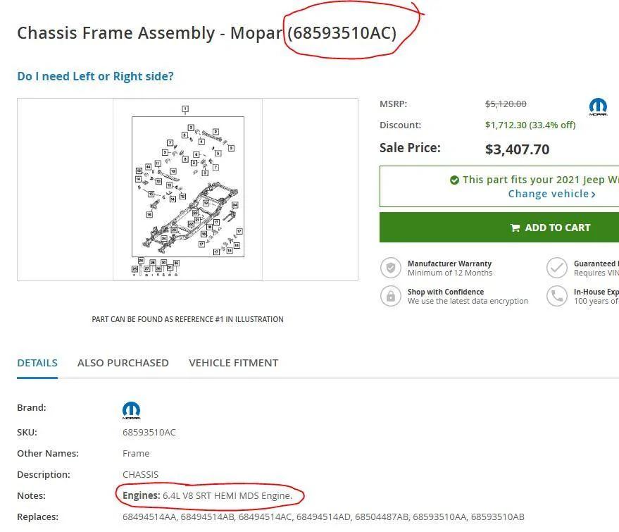

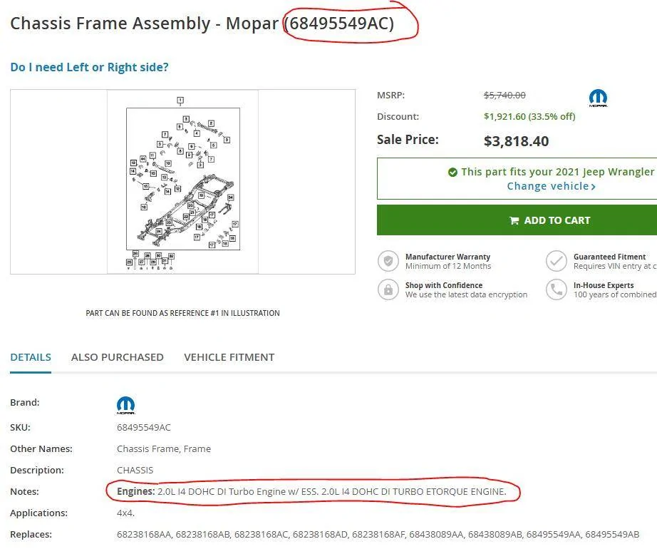

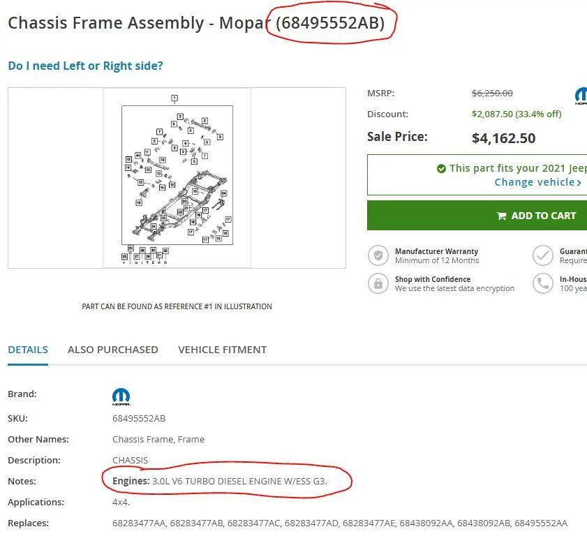

Was curious so looked up a 2021 392, sport with 2.0L, and diesel. Different part numbers and prices. The frame for the diesel is most expensive so it must be the best.
Jeep Wrangler JL Do all Wranglers trims have the same frame ? 1719266212038-p9
Jeep Wrangler JL Do all Wranglers trims have the same frame ? 1719266289484-hg
Jeep Wrangler JL Do all Wranglers trims have the same frame ? 1719266415629-uu

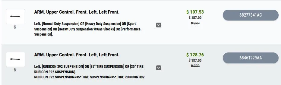

From this photo. I don’t see a “upper control arm “
Left Field
Tim
Aug 5, 2020
442
969
Western WA
'67 RS-SS Camaro, 2021 JLUR392
A little bit of it is visible at the axle mount point and more just behind the lower section of the shock absorber. However it looks standard black to me in spite of the color coding scheme.
The parts catalog numbers however do show it as different than the 'normal' upper control arm.
