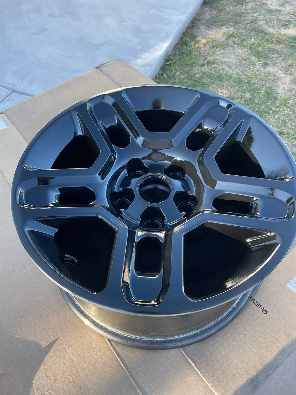

Kay.man.rug is correct. The prep is vital to the outcome. I’ve done two sets of wheels before they had tires mounted. Lots of cleaning, degreasing, scuffing, multi coats, clear coats. First time using spray cans. 2nd time using catalyst two part with spray gun. I was happy with the results on both, but off-roading will cause damage. I didn’t have any from street driving. Powder coati g in my area is $150-200 per wheel. So, paint was much cheaper.

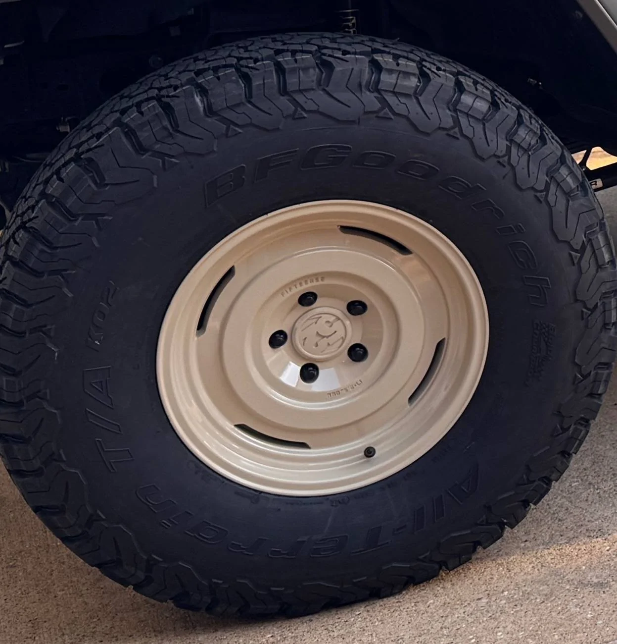

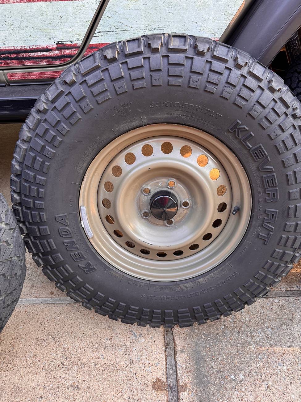

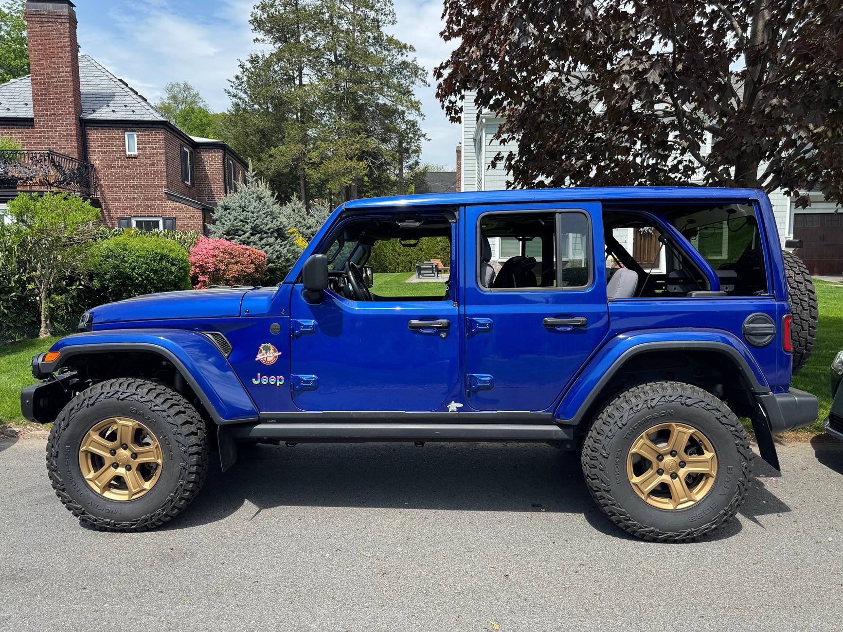

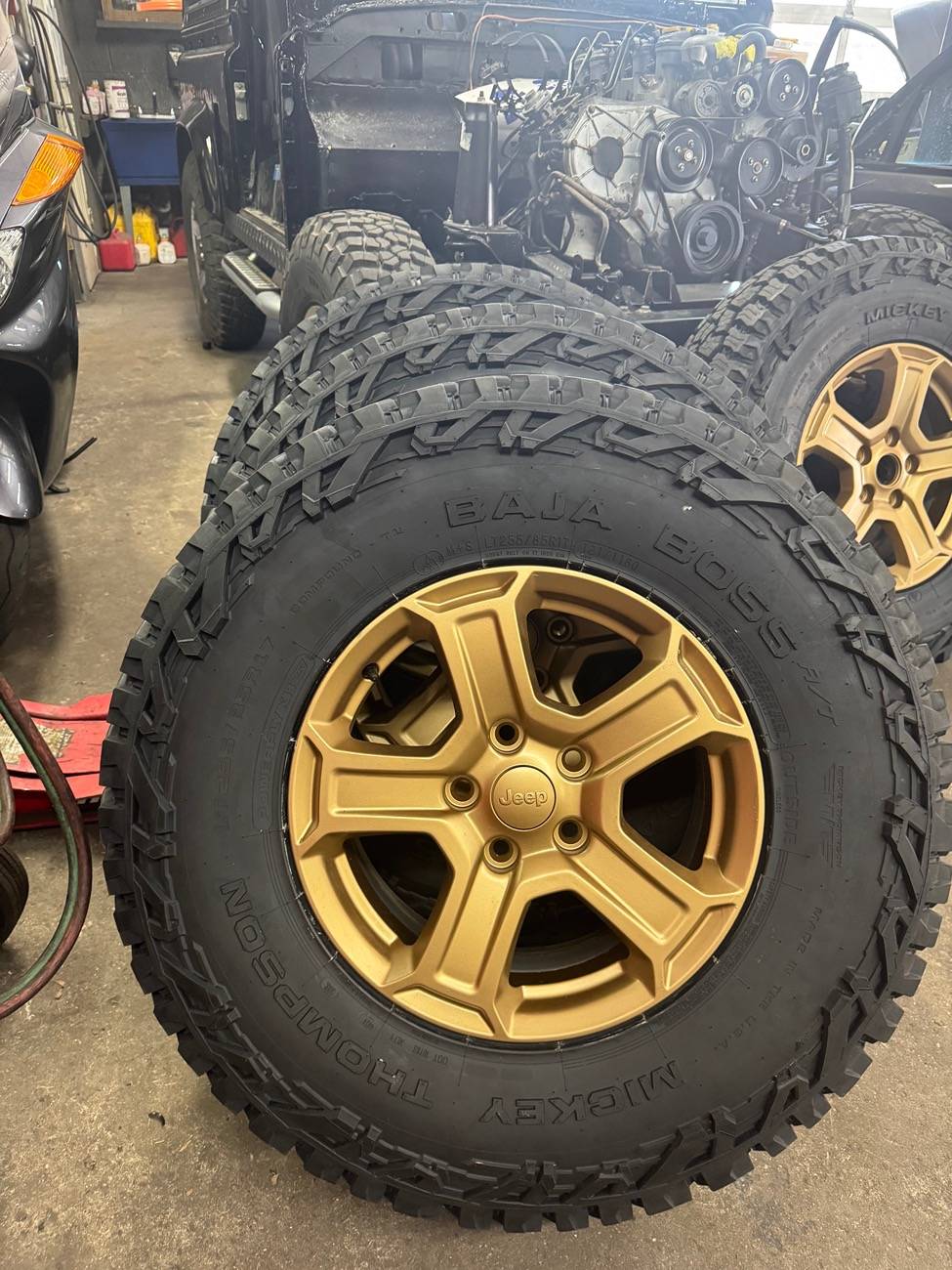

Just painted mine gold with rattle cans (couldn’t find the right paint to use the gun), and it was a chore. Turned out ok-ish from 10ft, and that’s about it:
Jeep Wrangler JL DIY Wheel Paint- Thoughts? IMG_7987
Jeep Wrangler JL DIY Wheel Paint- Thoughts? IMG_7802
in any case, if I understad correctly what you want to do… have you considered getting a set of these instead?
https://ebay.us/m/cYM2os
If you wanted them matte, painting these is probably a lot easier than painting the wheels. I only found out they existed when I was halfway through my paint job, or I would have gone with the covers.

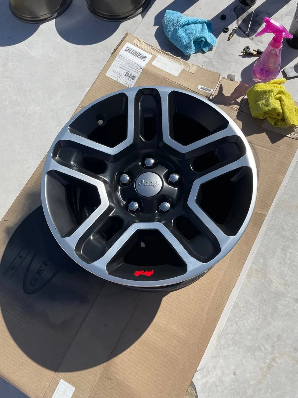

Four years ago I painted theses wheels with Duplicolor wheel paint. I just scuffed them good with a scotch brite pad degreased them and many coats later I sanded off the area to highlight what I wanted. Added a little red Jeep and clear coated them. Been happy with the results.
Jeep Wrangler JL DIY Wheel Paint- Thoughts? IMG_4417
Jeep Wrangler JL DIY Wheel Paint- Thoughts? 65767261871__6115CE35-2F2A-4CD7-9FDF-8C557824D6FA
Jeep Wrangler JL DIY Wheel Paint- Thoughts? IMG_4440
Jeep Wrangler JL DIY Wheel Paint- Thoughts? image
Take your time and they can come out great.
