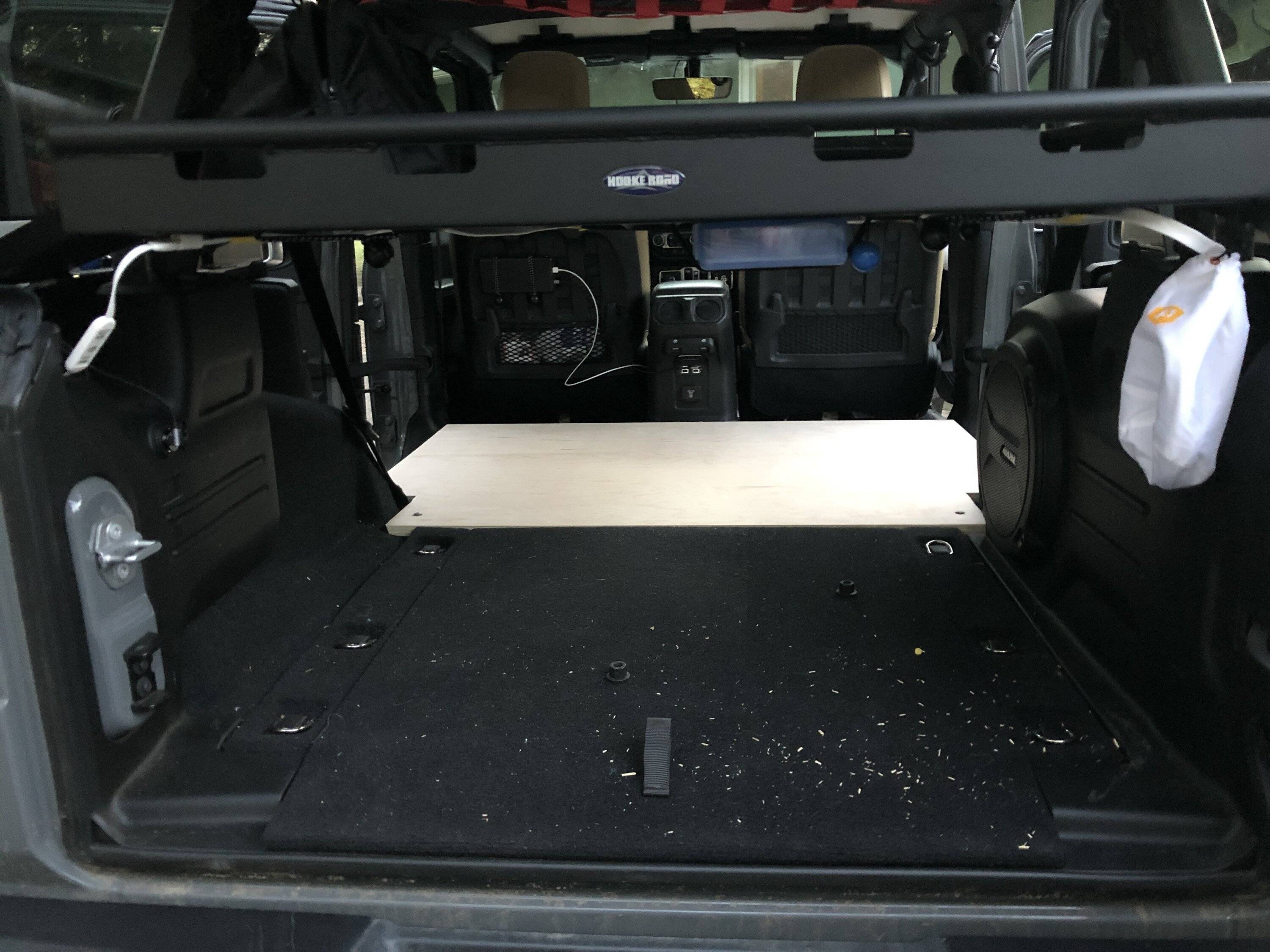

Since we are headed out for a camping trip and my Goose gear is still in production I quickly put one together out of maple ply. It's only temporary but it does the job. I used the entire 3pc carpet as a template. Secured the PLB40 and have tie downs for the cases of kitchen and camp equip. Speaker box carpet from Amazon is complete trash though.

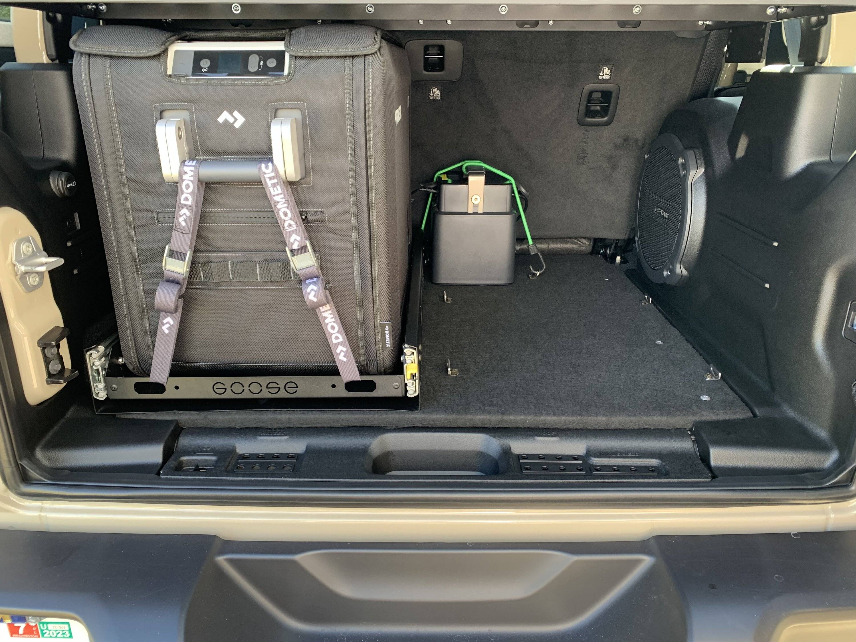

Fortunately my wife is into Jeeping. She also has strong opinions on what she wants. She loves the build quality of Goose Gear products, so we're getting Goose Gear for this.
They build them on demand, resulting in eight weeks of lead time. It's one of the few things that I didn't order back in January, so ours won't be here until after our Rubicon Trail trip. That means that I'm now working on getting our Dometic CD 30 mounted in this Jeep, utilizing the birch platform that she built for our last JLUR.

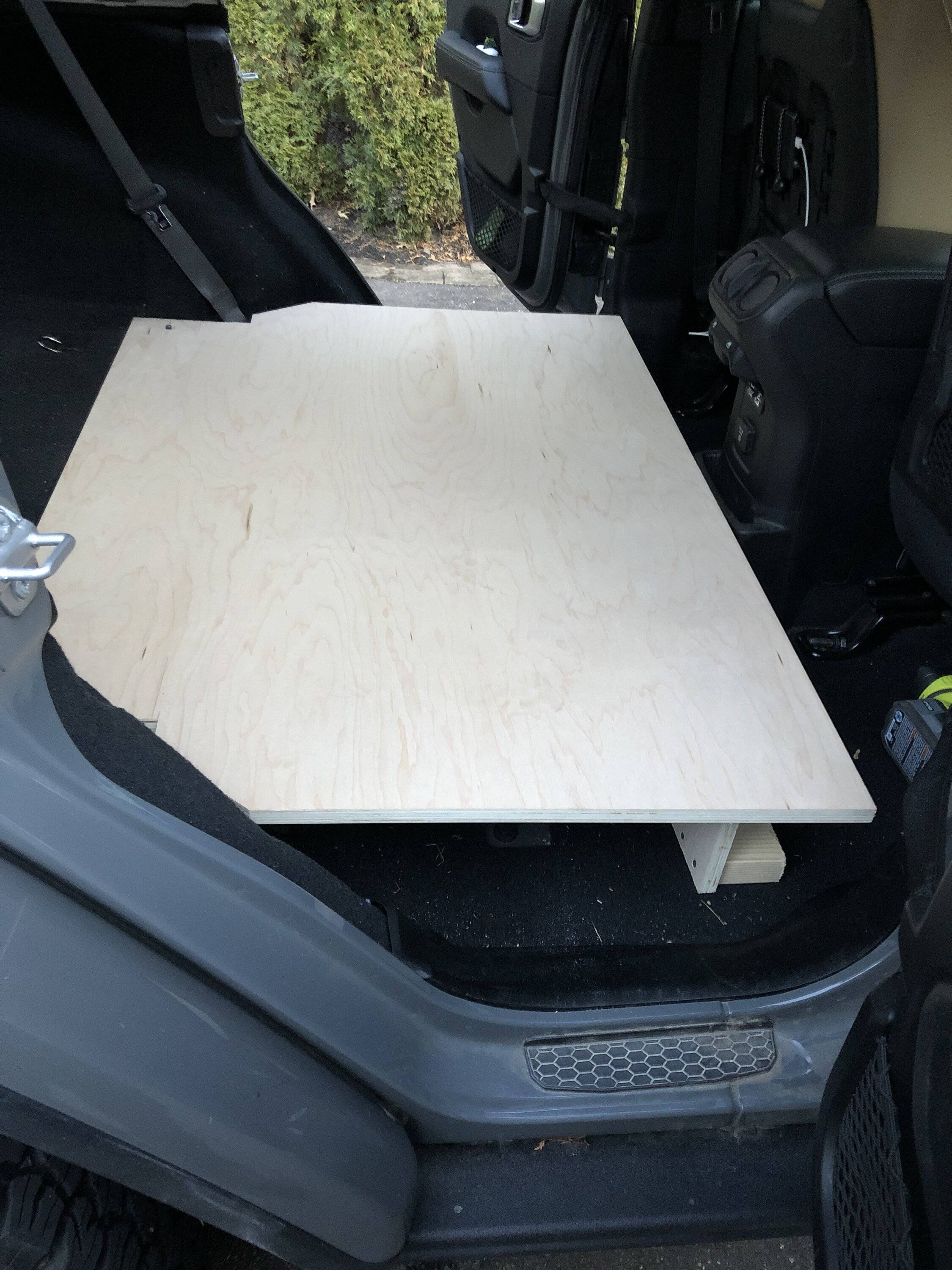

I did a similar plate for my build but I only replaced the 2nd row seats with a “plate". The commercial equivalent is the $599 Springtail rear seat delete. Issue with this solution is that it isn't flush with back OEM plate for sleeping comfort and doesn't provide a way to extend the platform behind the seats for sleeping a 5' 10" person.
I didn't need to mount to the floor so the back was fine as is and I kept access to the storage cubby in back as it was. See below the basic plate:

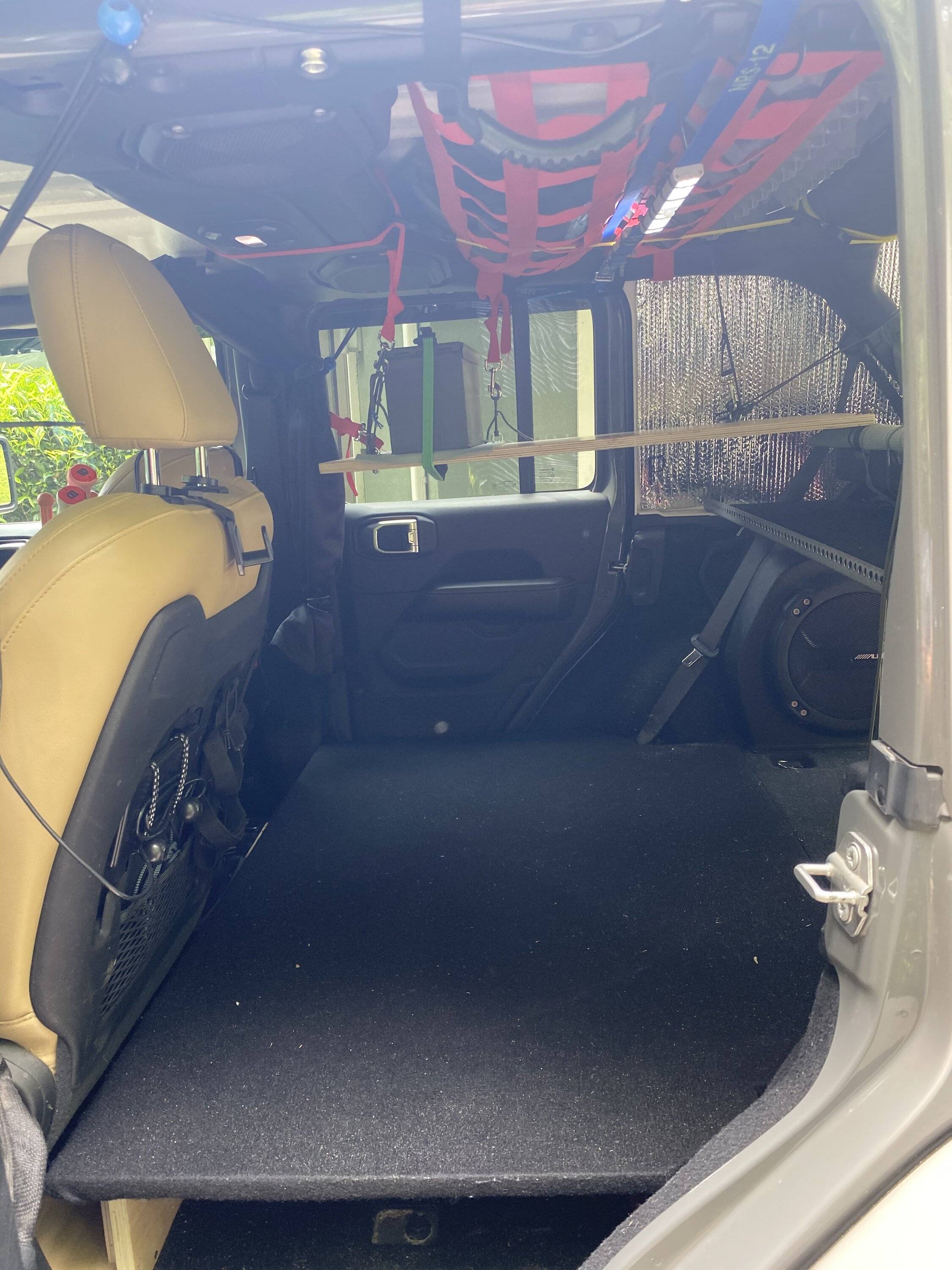

Above, the bottom support was temporary here but the top gets sealed and covered in carpet.
Jeep Wrangler JL DIY Goose Gear Style Platform 77A8843E-4C48-465D-8E7A-EFF325DD1888
Above: Plate freshly covered in carpet. Front seats all the way back. All the shelving above ended up changing in the final build I travelled with but the plate stayed pretty much the same. You can see above the flush condition between added plate and existing cargo area “plate”. With just the black carpet it looks pretty OEM.

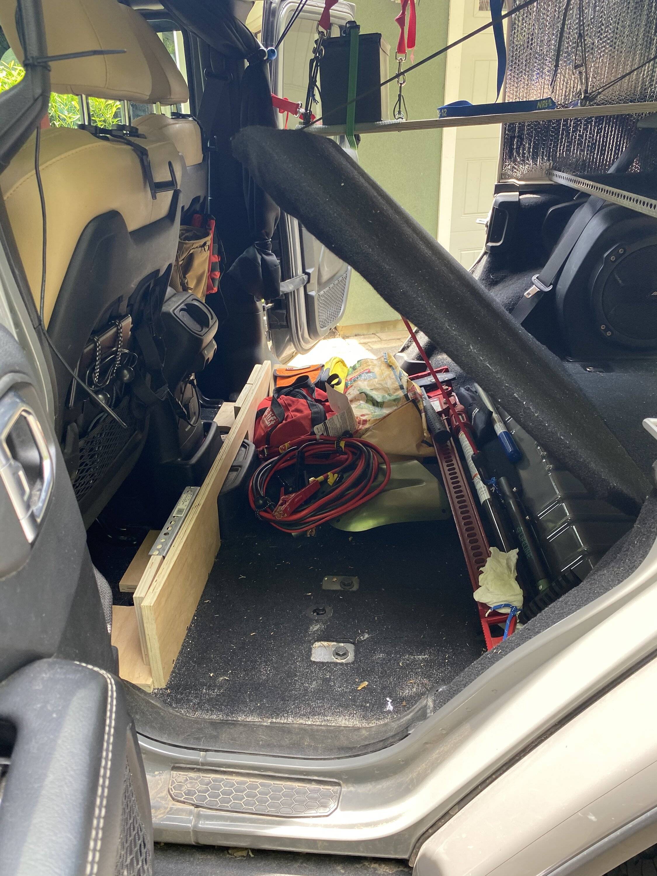

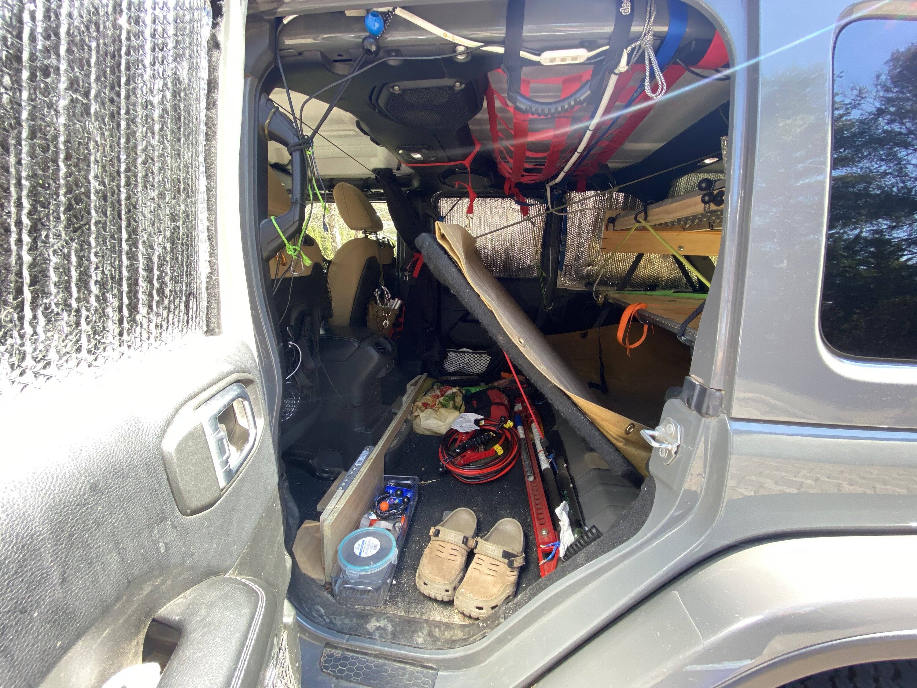

Above & Below: This was how I can access all of the storage underneath. The plate tilted up by hand, the red bungee above the hi-lift jack keeps the back side of it down. Some paracord holds it for access to storage. You can see waxed tarp covering the “bed” area here.

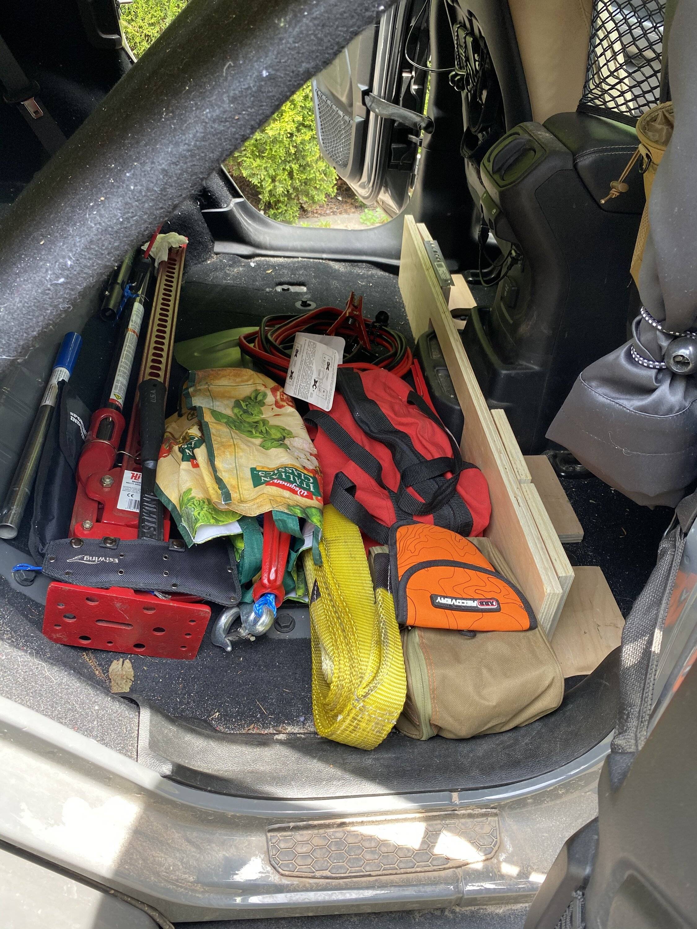

Above: Driver side under floor was shoes and flashlights and dog bowl I would have access to it if the door was open.
Jeep Wrangler JL DIY Goose Gear Style Platform 17E617AC-5FCA-485B-83D1-4F9254FF28C9
Above: Behind passenger seat was recovery gear. Pump and deflators can access easily from the open door. If I was in a recovery situation I'd have to tilt up plate for access to the rest of it.
Tilting plate up involves pushing both seats forward and seatbacks upright. Not ideal but no hatches made for a simpler, stronger design, allowed me to cover the entire platform in a waxed canvas tarp (mostly in case my dog lost his lunch on our journey). And even with hatches that hi lift jack isn't coming out without the tilt function.

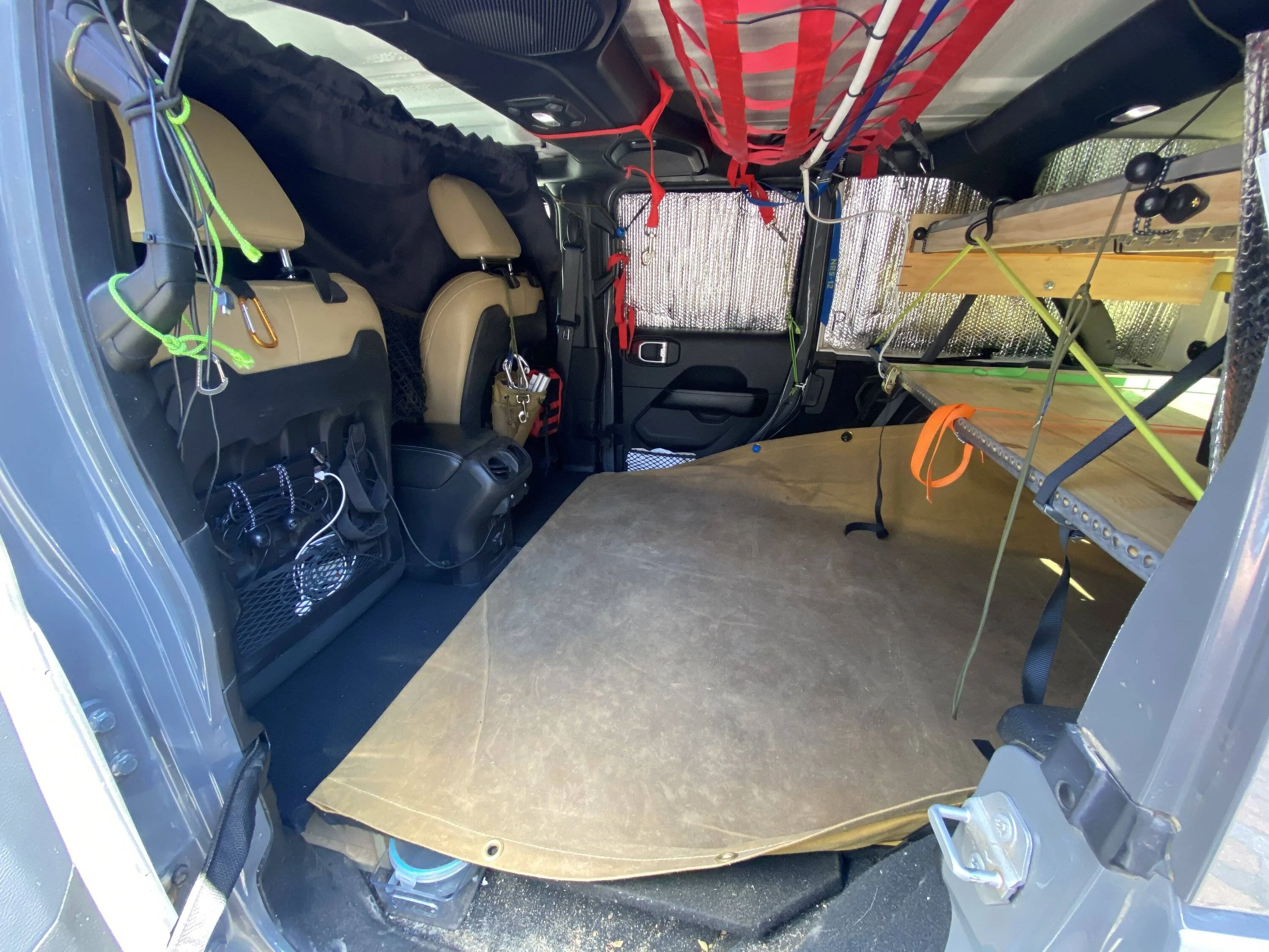

You may also notice in the little “wings” in front of the front support. These were hinged and allowed me to drop in plates behind the seat when moved all the way forward to get enough length to sleep comfortably.
Jeep Wrangler JL DIY Goose Gear Style Platform 8D972BD1-834B-43D3-9A7D-2FC9046B52F3
Above: Blackout curtains up. Filler Plates in to extend length of sleeping space. Ready for bed. This also shows my final version of shelving that included a recovery board top shelf to maintain stealth and security and save weight.
