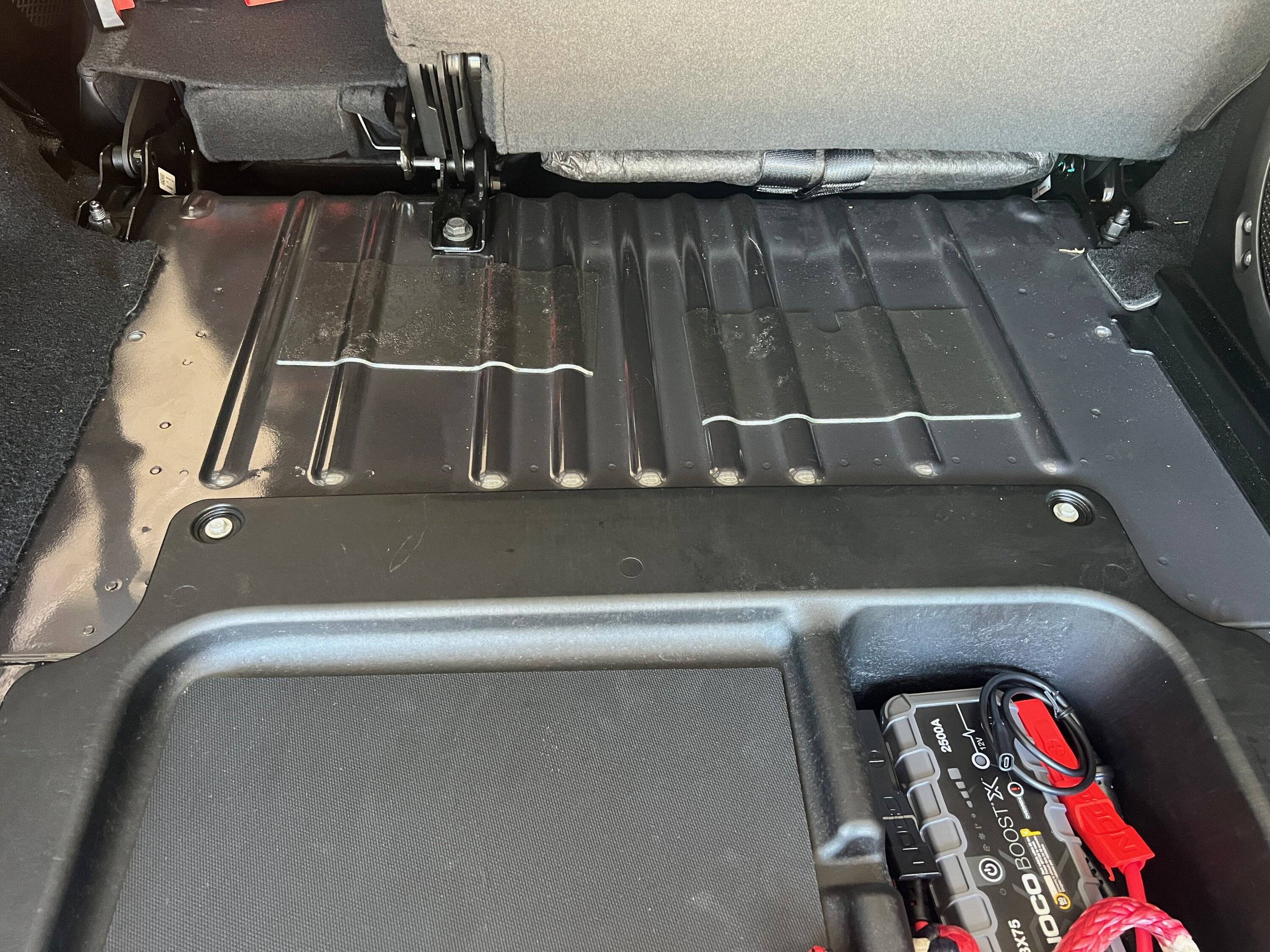

I am mostly interested in the rear section but don't want to eliminate the possibility of adding the front at some time. For the rear, did you put any spacers under the base? The floor is not flat of course. The plastic bin (mine is 392 so that storage is very small) sits above the rest of the bed. The two strips of support that almost seem to be randomly placed are on the same plane with the top of the plastic bin.

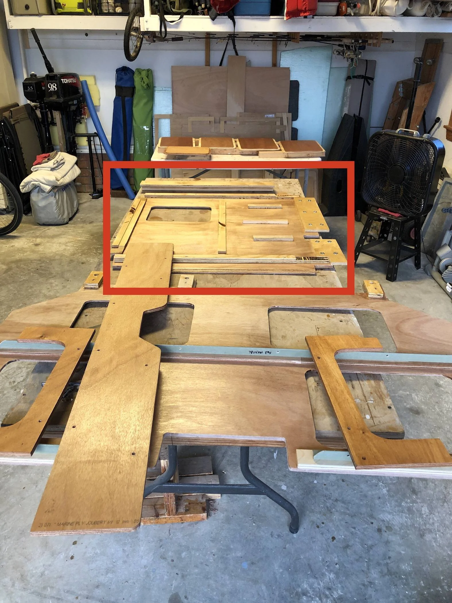

Yes. I used spacers. I cut notches in them and such to ensure a level foundation and then glued those to the underside of the platform. I attached a picture and put a red box around the rear platform. It's flipped over so you can see the spacers.

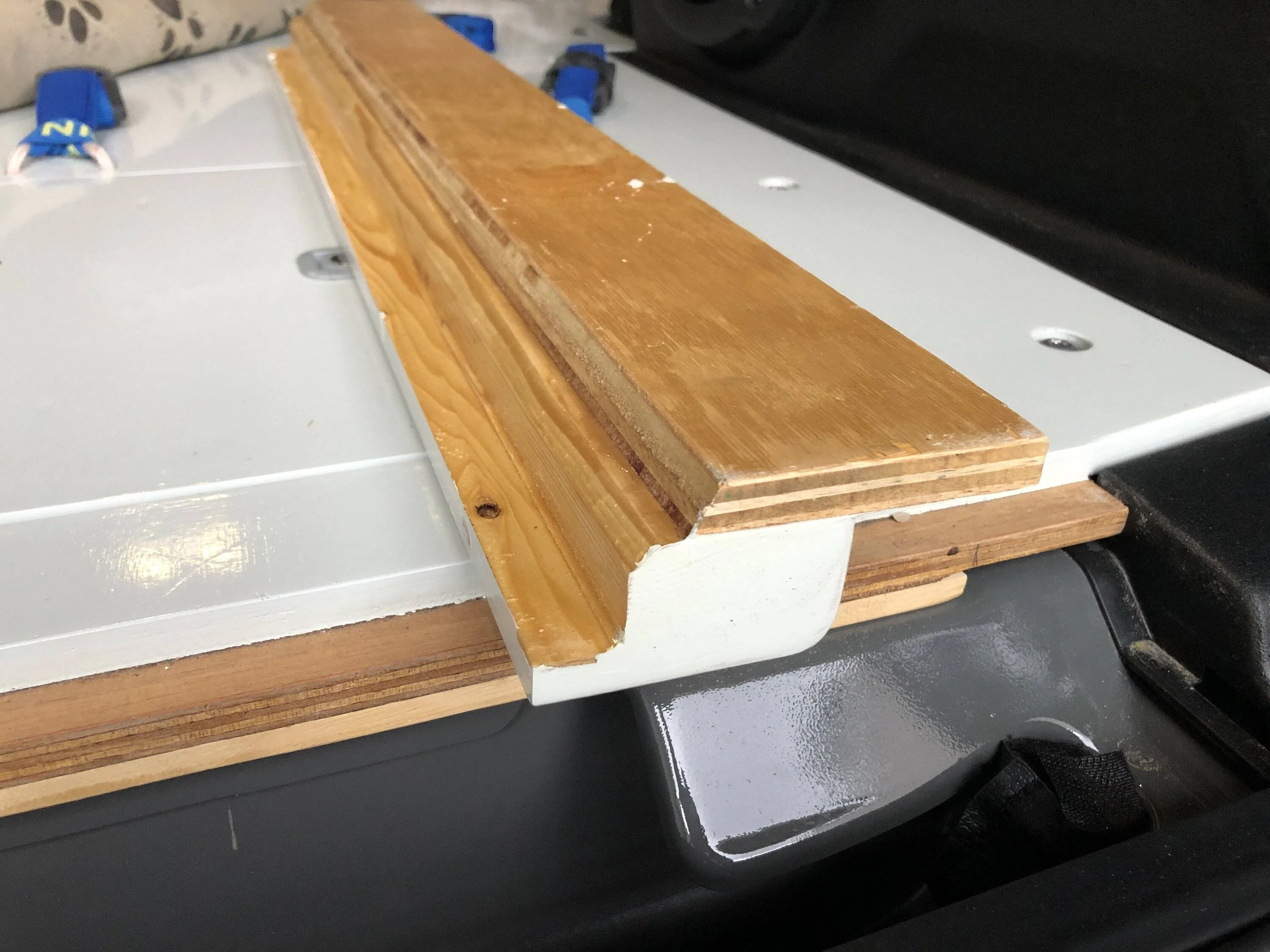

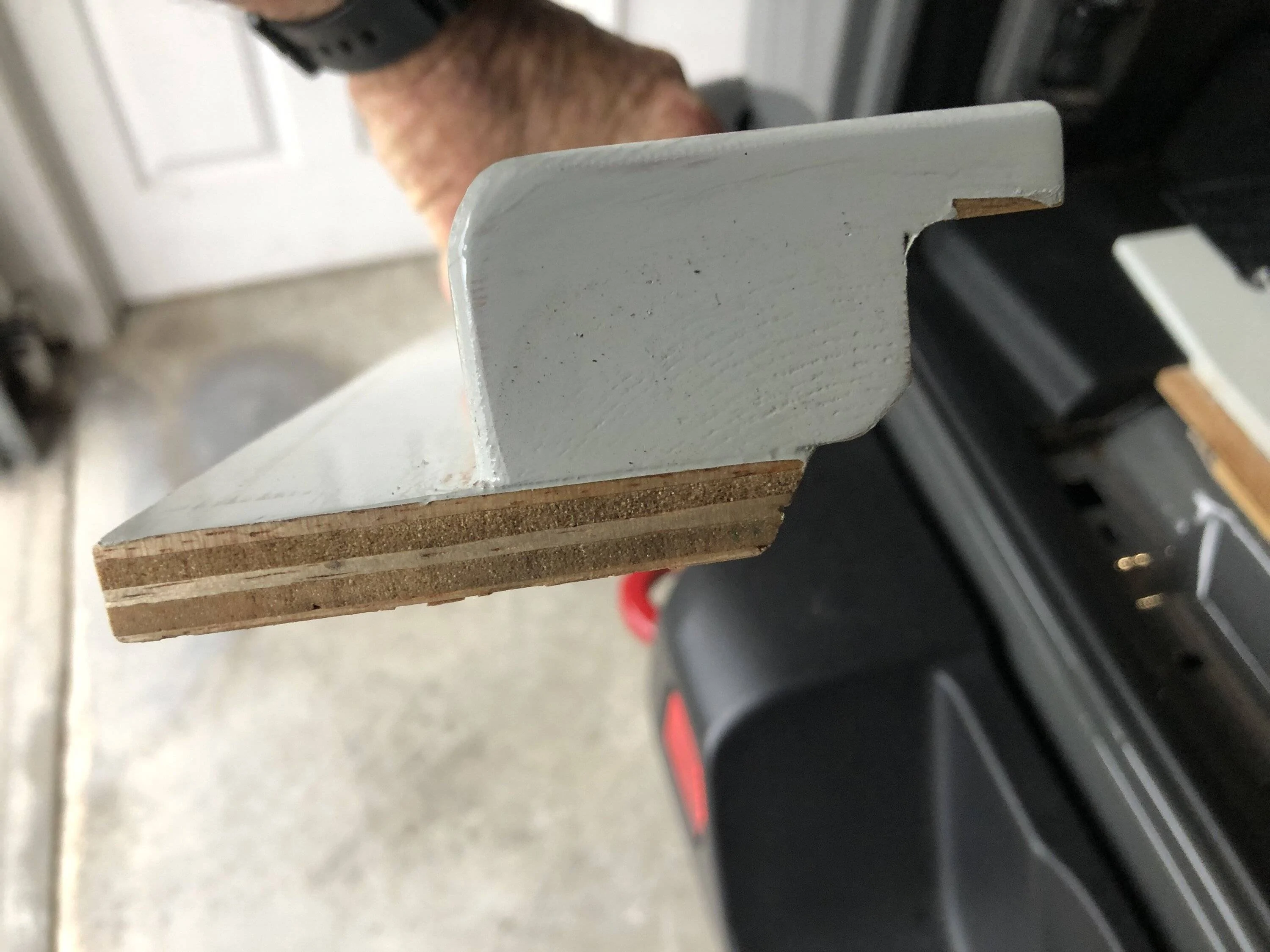

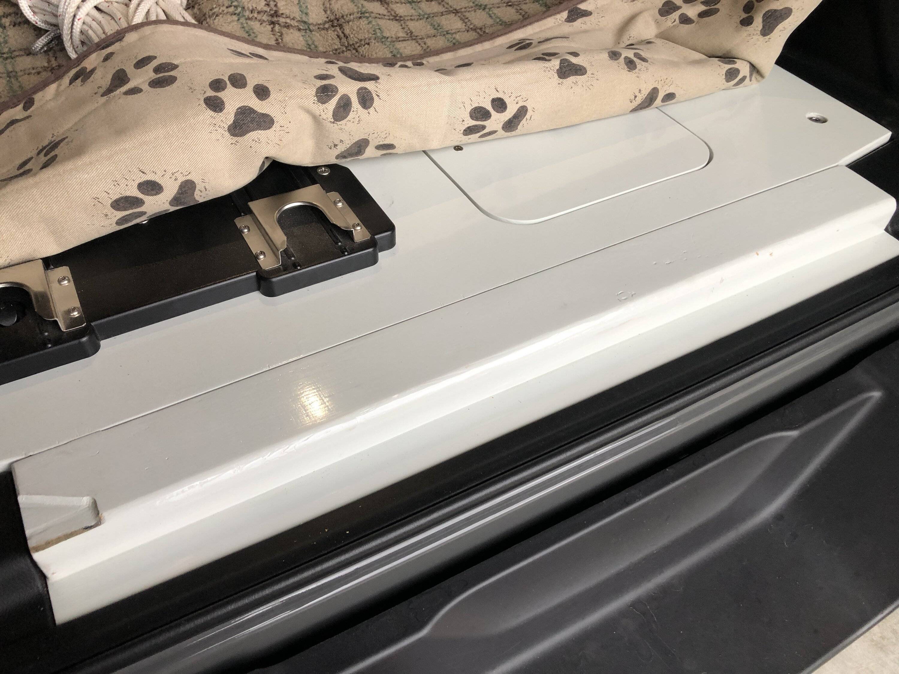

Yep. 3/4" ply supports glued to the bottom of the plate. Attached are pictures of the jack compartment cover. It slips under the plastic lip just like the original. I made it with 1/2" ply glued to a 2x4 which I milled to get the correct profile on a table saw. You could also cut it with a router or hand planes if you got 'em and know how to use 'em.
