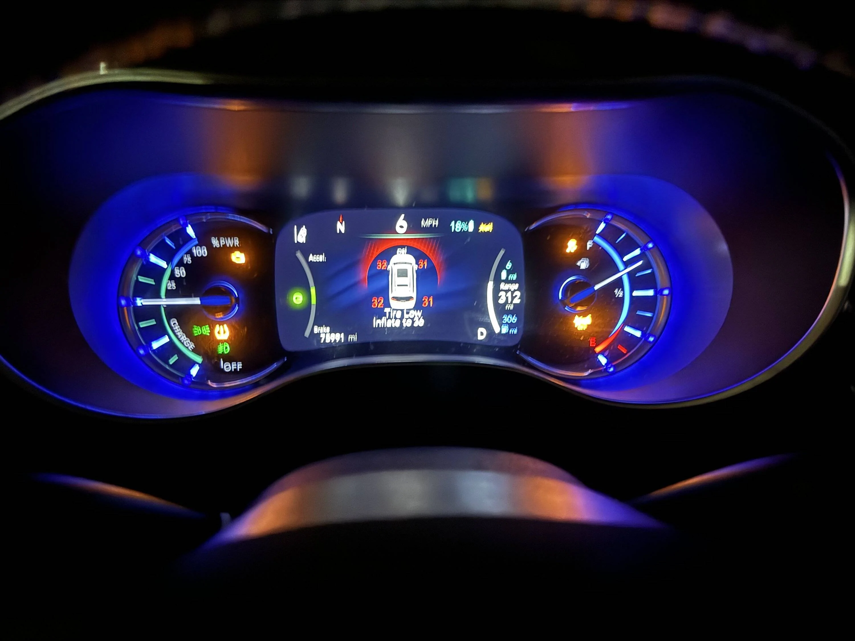

Not a wrangler but a pacifica hybrid. Hopefully the systems are the same or similar. I posted on the pacifica forum but crickets.
dealer said we needed new brakes. They wanted $700 for pads and to turn the rotors. I knew i could get high quality pads and rotors but couple hundred bucks. I googled how to change the brakes and only found regular pacifica. I did the standard brake job, no issues.
afterwards, ive got multiple warning lights and the regen braking isnt working.
1 CEL
2 collision avoidance
3 smart stop
4 regen braking
the tpms issue was separate and corrected
Jeep Wrangler JL DIY brake job woes? IMG_0478
i scanbed the codes and got:
U1852 and a couple of other codes my code reader apparently cant read. I tried erasing the codes but they wont clear.

No. No damage to anything. No leaks. Yes the reservoir is full.
the lights came on right away.
the brakes are working well.

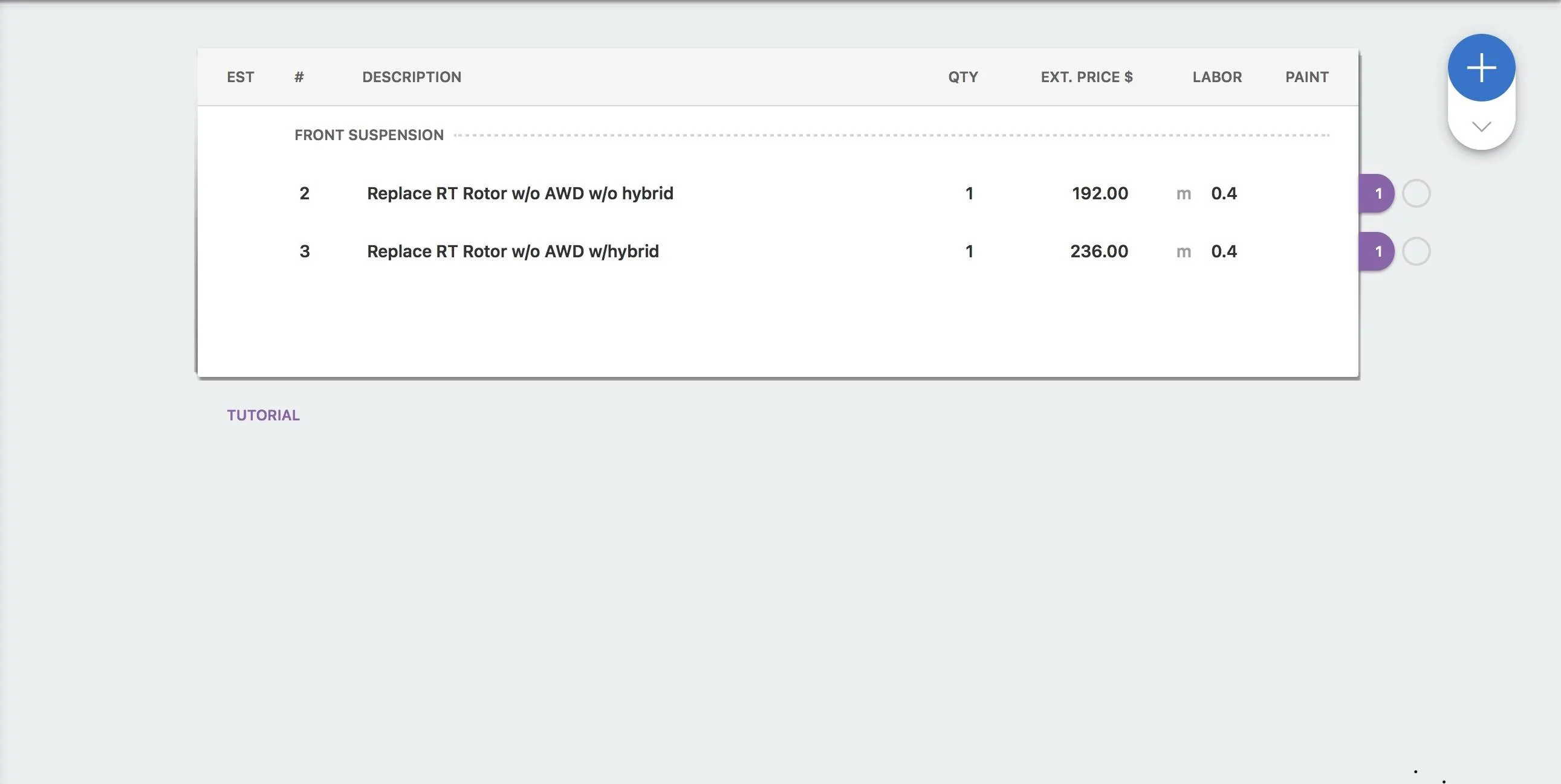

Im pretty sure the hybrid has specific rotors that differ from the standard rotors. What rotors did you use? Many Amazon rotors state hybrid but they're not this shows oem rotor pricing
i used rotors from Napa. they did not specify hybrid or regular. the brakes are working fine.
