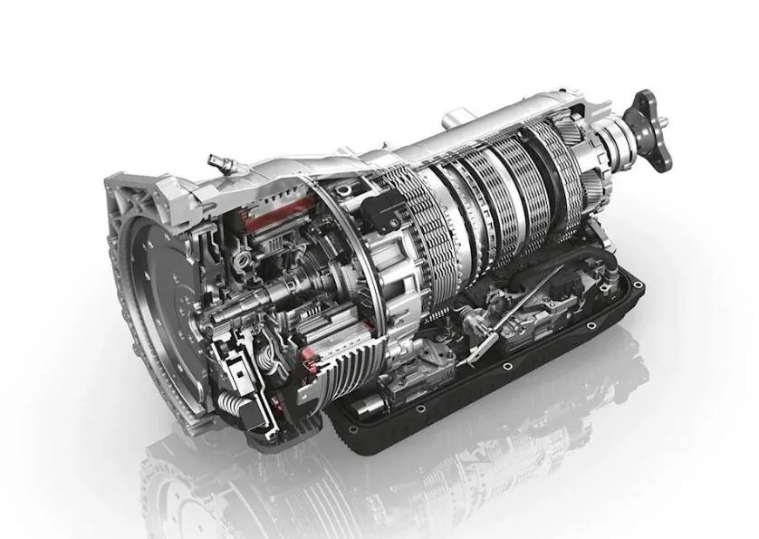

Yeah, selec-speed is basically cruise control, while you control the manual shifter. Correct, the 4xE replaced the torque converter with a binary electric motor to help provide instant torque. What you experienced is the negative side to that
