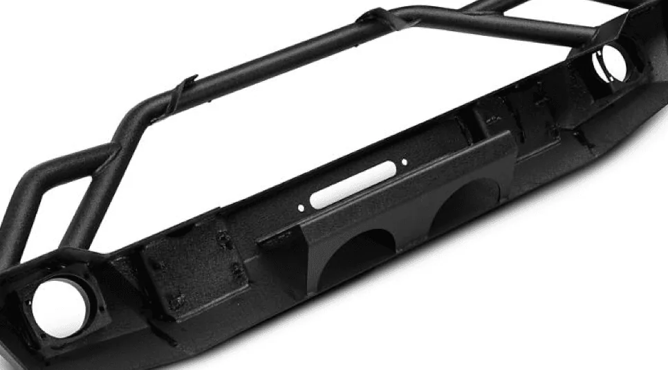

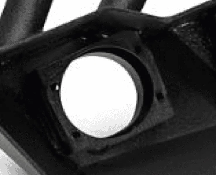

I have the 18 JLU Rubi with factory LED Fog Lights and plastic Rubi Bumper. I would like the Barricade Extreme HD Front Bumper & 9,500 lb. Winch Combo (below) from Extreme Terrain. But the description says it can’t mount factory JL Rubi LED fogs. According the photographs from the back side, it has the 4 bolt light mount. I would like to know what mounting (2, 3 or 4 bolt) does the factory JL Rubi LED fogs with plastic Rubi Bumper have? Because I see so many different answers on this forum and other websites to find one concrete answer.

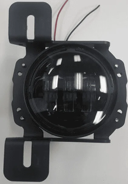

And is the Maximus-3 JL Fog Light Adapter Brackets only for 4 bolt to 2 bolt mounting options, not reversible?
Thank you all in advance!
Extreme HD Front Bumper & 9,500 lb. Winch Combo from Extreme Terrain images:
Jeep Wrangler JL Difference in fog light mounting brackets Extreme HD Front Bumper 1
Jeep Wrangler JL Difference in fog light mounting brackets Extreme HD Front Bumper 2
Jeep Wrangler JL Difference in fog light mounting brackets Extreme HD Front Bumper 3
Maximus-3 JL Fog Light Adapter Brackets:
Jeep Wrangler JL Difference in fog light mounting brackets Maximus-3 JL Fog Light Adapter Bracket
Your plastic bumper LED dogs use a square 4 hole mount.

your stock lights will bolt right in. no bracket required.
