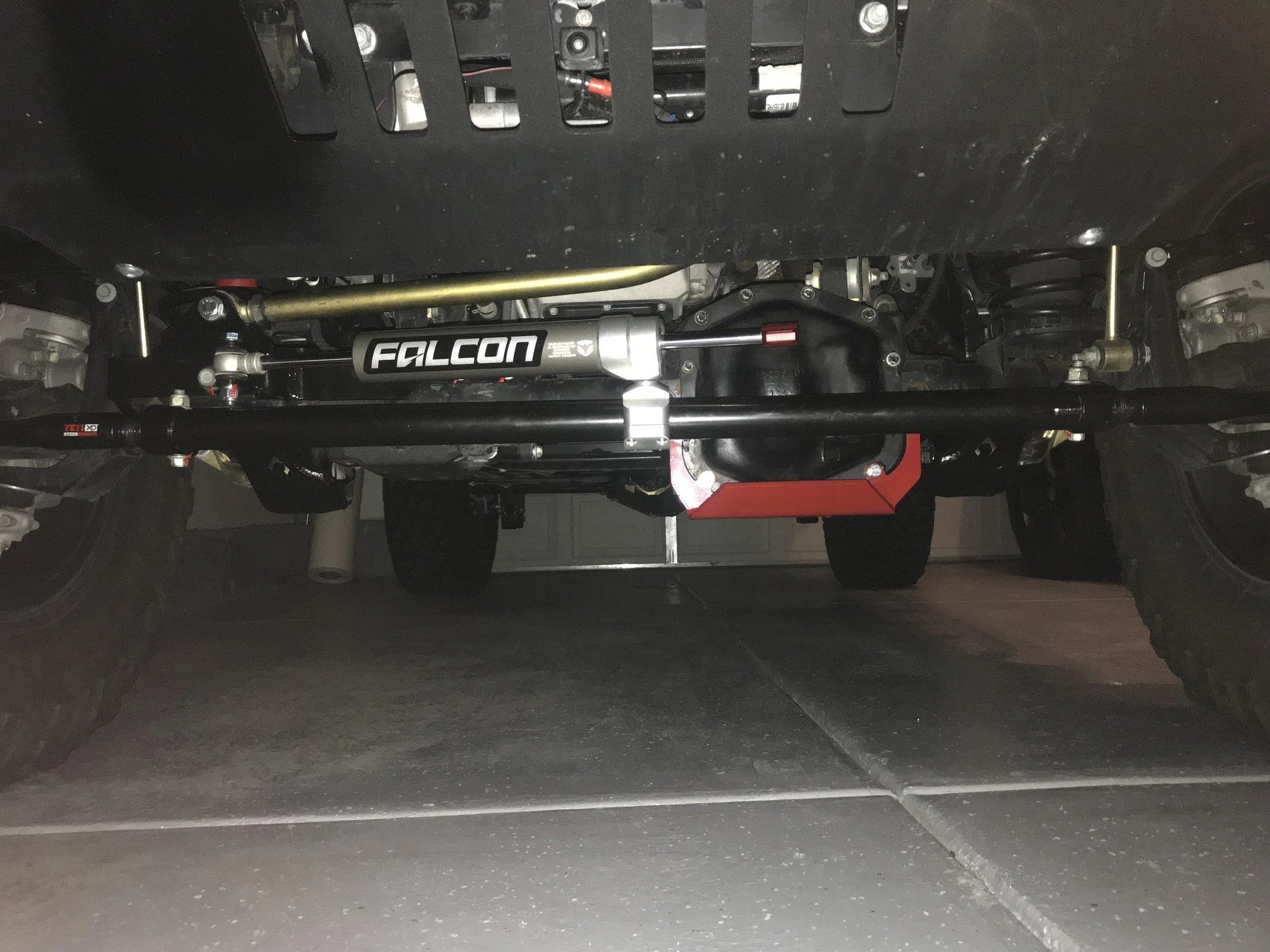

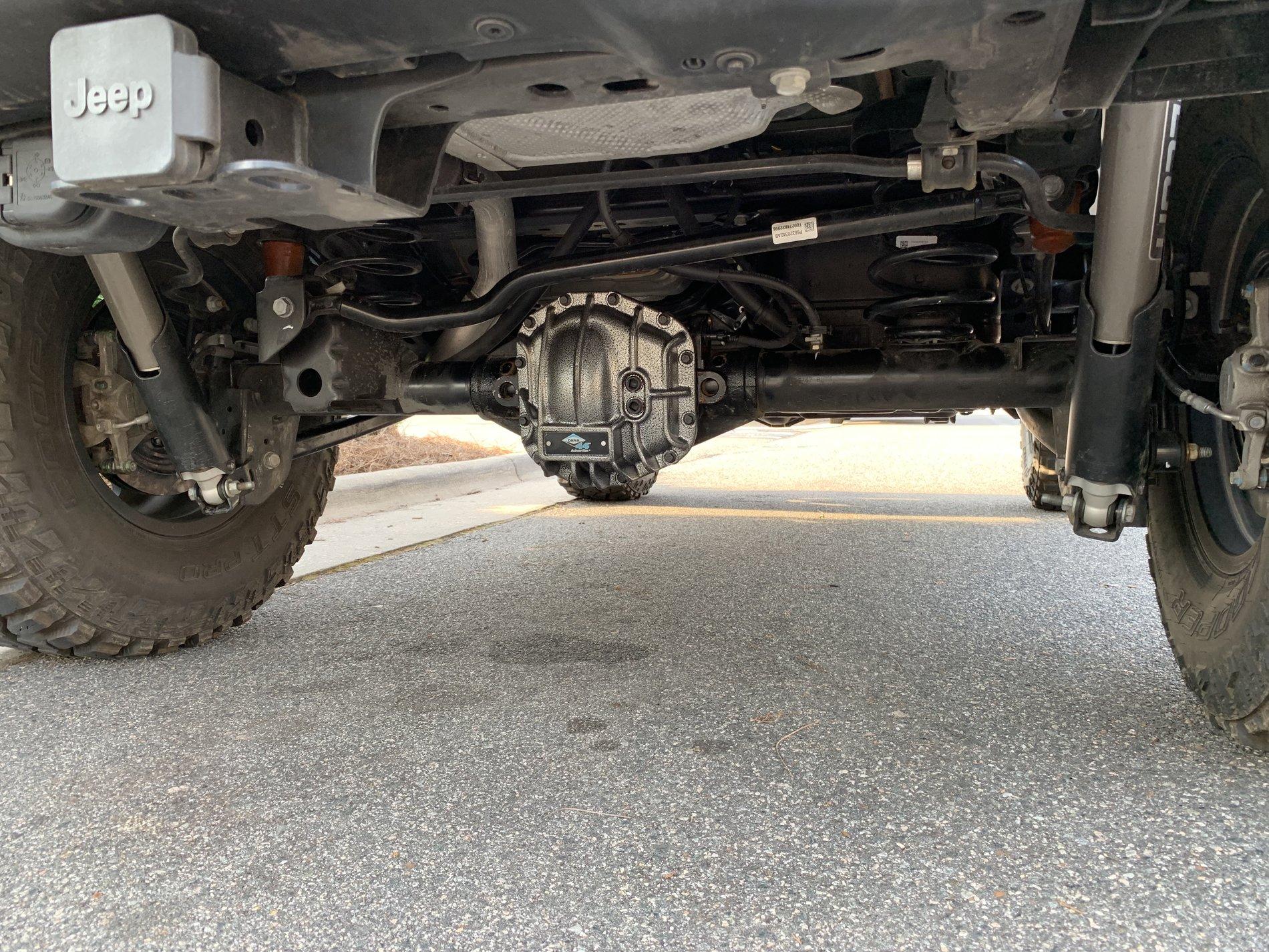

Here’s my MC from behind and the front Rancho. The Rancho is a bit scuffed up now after my Rubicon Trail run. But the red has grown on me.

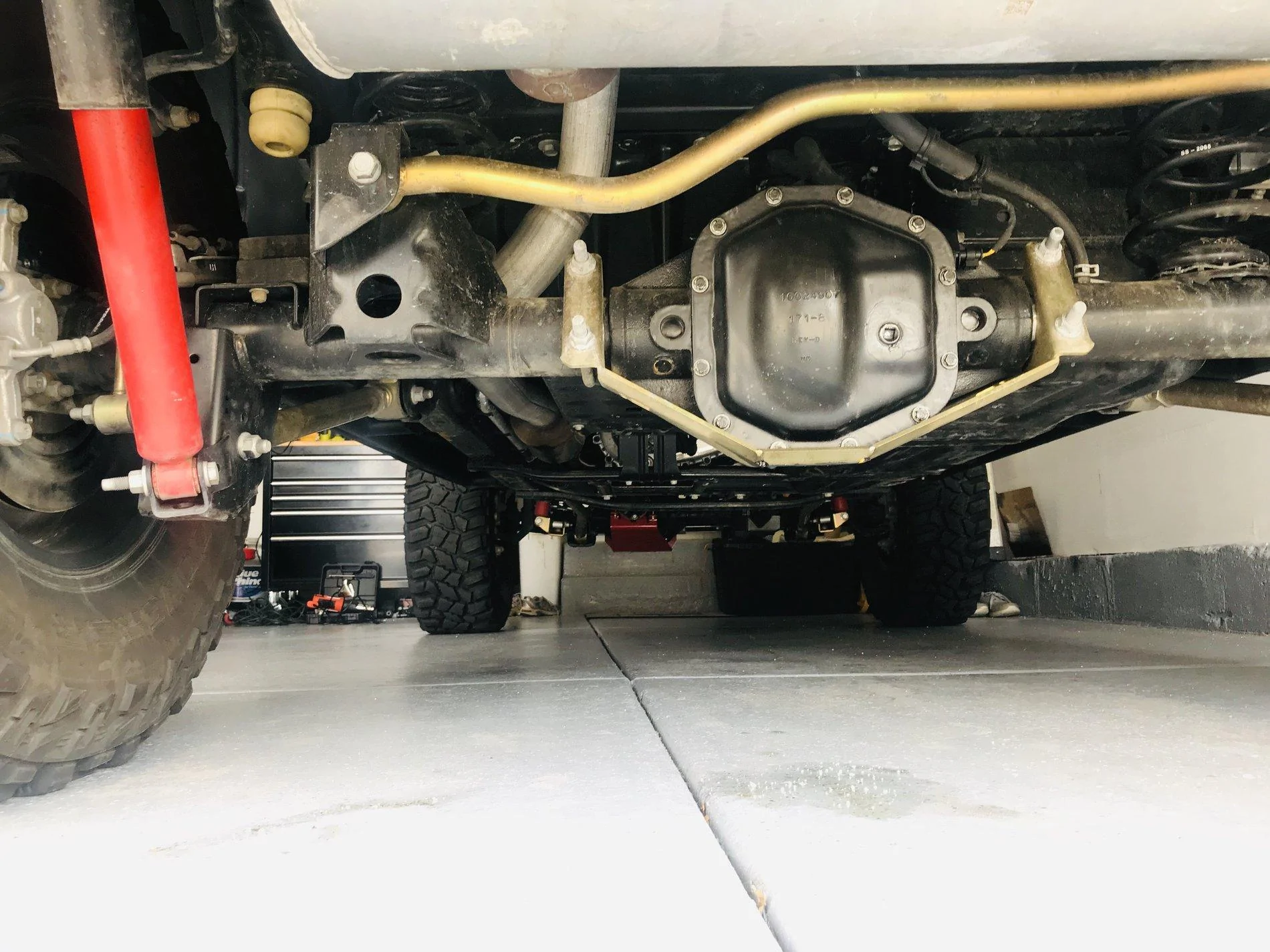

I'm running a rear golden diaper from Metal Cloak also. I highly recommend getting one. I was trying to hold out for them to release a front skid, but I may have to pick up a Rancho one.

I've been running the MC rear skid and a Rancho front skid. The Rancho skid folded on the first hit it took. I ordered the MC front and rear diff covers with the new front skid and got them last week. Unfortunately the front Rancho skid folded and I can't get it off due to it's deformation. Going to take it in to my friends shop and have them remove it. I'd stay clear of the Rancho skids.
looks like it saved your diff from a disaster. being steel, you can probably bend it back and still keep using it. i have the save one on the front, and MC on the rear. the rancho is very beefy. that had to have been a hell of a hit. with the weight of the vehicle coming down on it. that would bend any piece of steel down there. but it saved the diff which is the important part.

Are you going to relocate your stabilizer next. That is where I was hitting the most before I installed the SteerSmarts relocation bracket and my falcon Nexus stabilizer.
