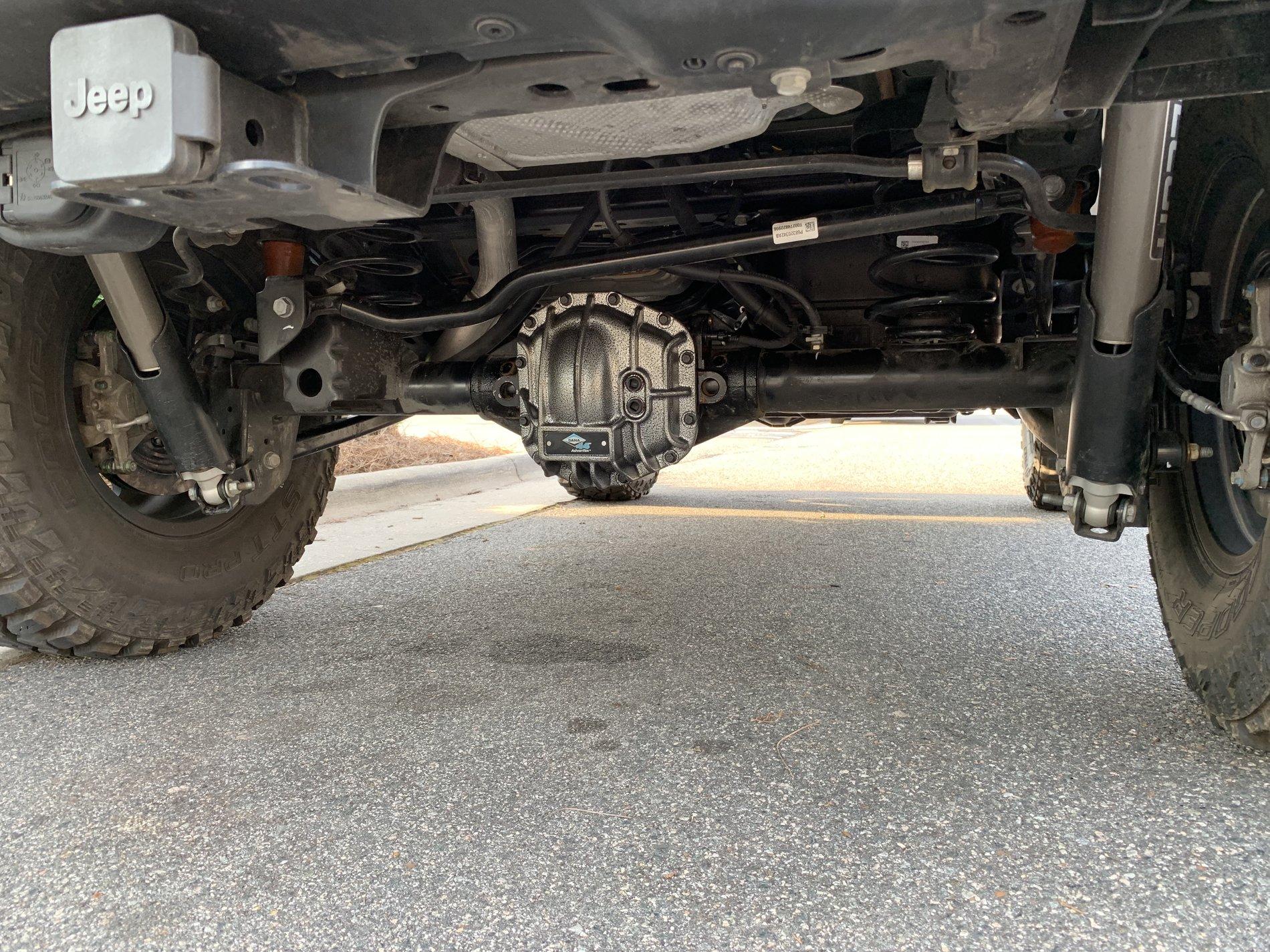

The MC skid is a metal work of art. And installation is a breeze. I wish you could see it more from behind
