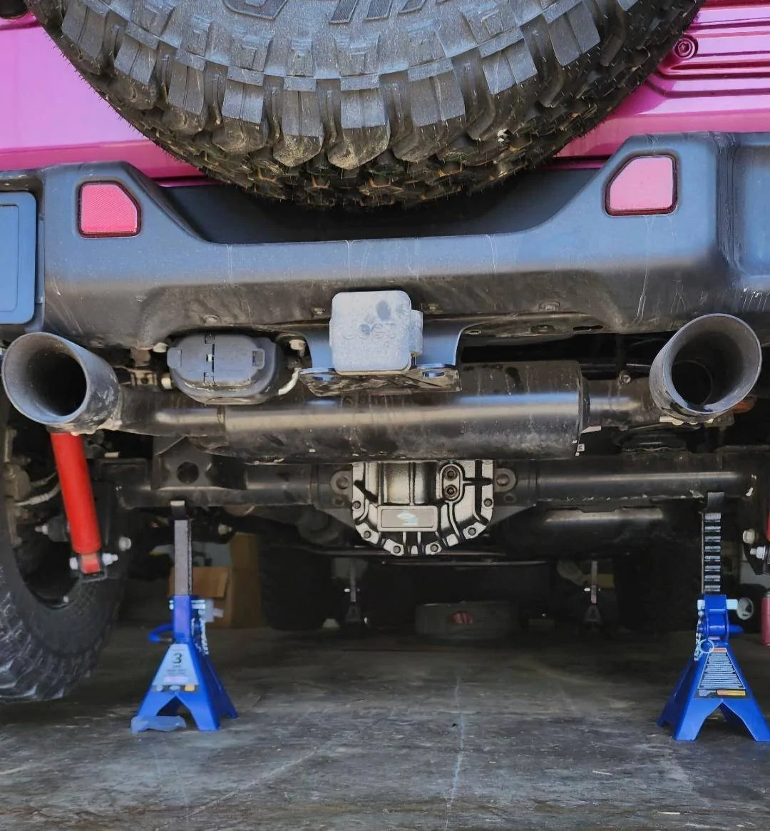

Good thread. Just installed a set of the Dana Spicer Nodular covers on my 25 Rubi. I went with factory gaskets and 25lbs on the bolts I could get to. Three bags of Valvoline 75w-90 was enough and can of brake cleaner. Easy peasy.
