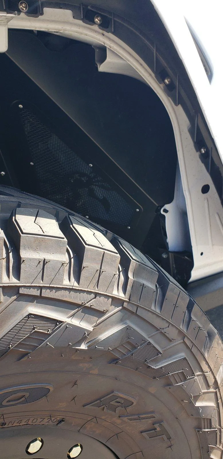

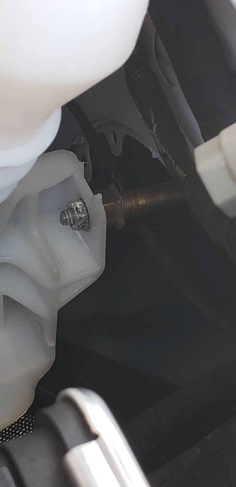

I purchased the parts OP mentioned, but found out I wanted to retail original piece, I installed the Poison Spyder inner fenders, relocated the reservoir as far "passenger" as possible (until it got to the frame which is about an inch), placed a spacer on the uppper and lower bolt, had to bend the inner fender on the lower back to place a bolt, but it worked, if you see upclose you can see a small gap, but I am ok with it. I should change that nut and add a washer though

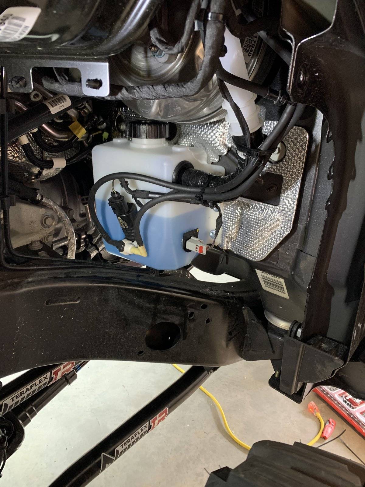

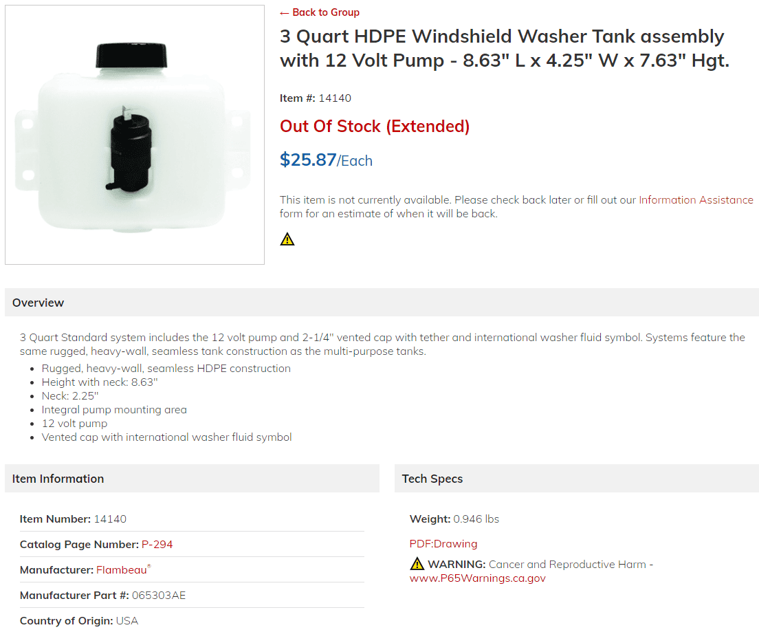

The 3 quart is doable too. Tried it since the 2 quart is out of stock.
Now that’s a clean looking install!
Can you post the part number for that reservoir please??
Also how did you seal up the side fill tube so it won’t leak?
Thanks in advance for your help!
samorris960
Steven
Dec 10, 2020
38
70
Atlanta
2021 Wrangler Unlimited Rubicon 392
Thank you. It definitely took a bit longer than expected and a run to Home Depot.
I used a step bit to slowly increase the hole size for both the inlet and sensor. Take your time there. Placed some clear silicon around the rubber grommets and hoses to be sure. The 3 quart was a good bit taller (3 screw holes on either side) so it didn't allow for a top inlet hole. Had to push it further toward the engine but still re-used an existing bolt on the right side + (2) self tapping screws. Left side I placed a metal bracket on an existing bolt and then zip tied the tank to that bracket.
The filler hose needs to be extended if you want the filler cap atop the engine bay to be mounted in the same location. I found this would have been true even with a 2 quart. Nothing some rubber hose pieces from the store couldn't tackle. Again, silicon added, duck taped for added rigidity and looks blends in better, and a hose clamp for good measure. Sprayer works and no leaks.

Thank you! Now if only the damn 2 & 3 quart weren’t on backorder lol

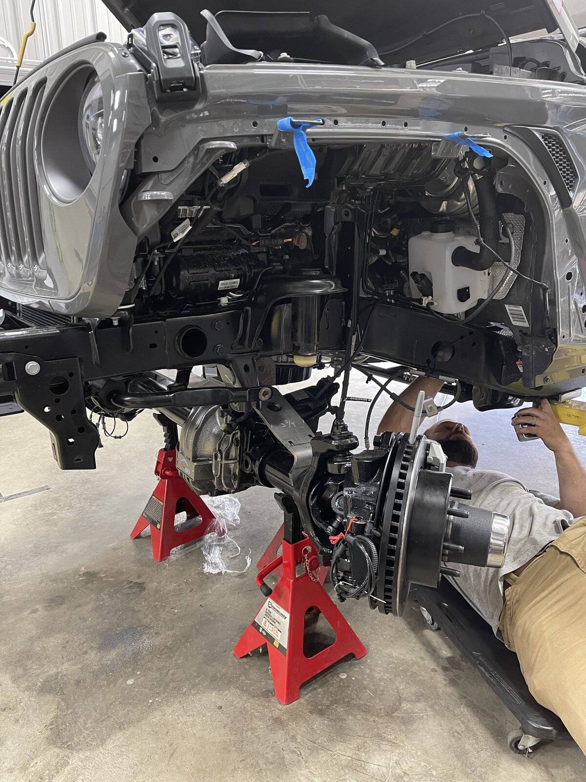

Just a little contribution here. I split the factory filler neck, then used a $10 radiator hose from Advances to connect the two. Trimmed a little off both ends of the hose until it was perfect. Part #D72070.
