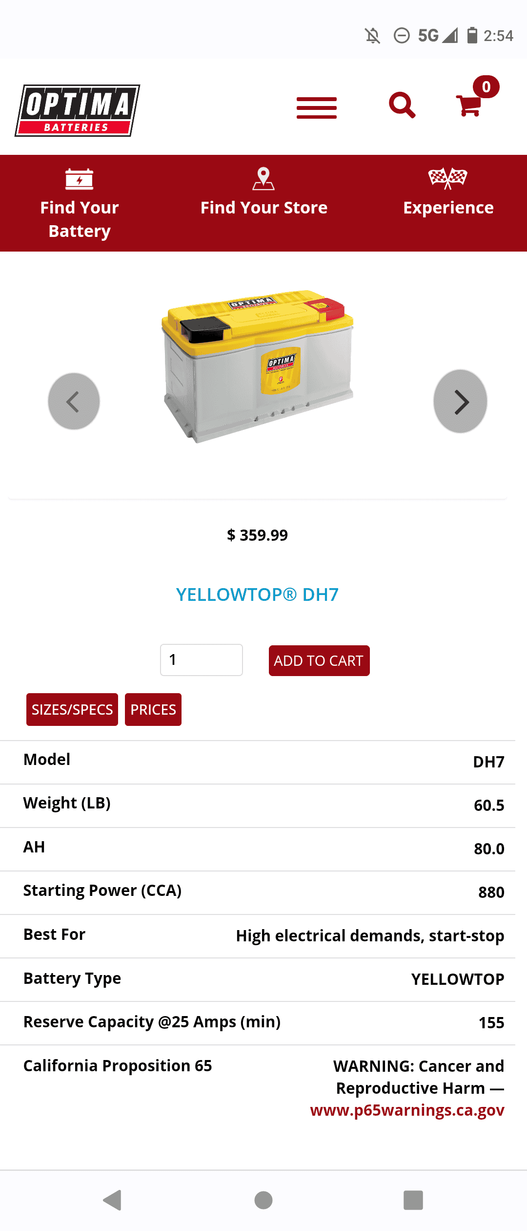

I probably got another year before I'm going to replace my batteries, however when I do I'm going to upgrade to some better quality batteries than whatever brand OEM uses.
Jeep Wrangler JL diesel battery options Screenshot_20230328-145430

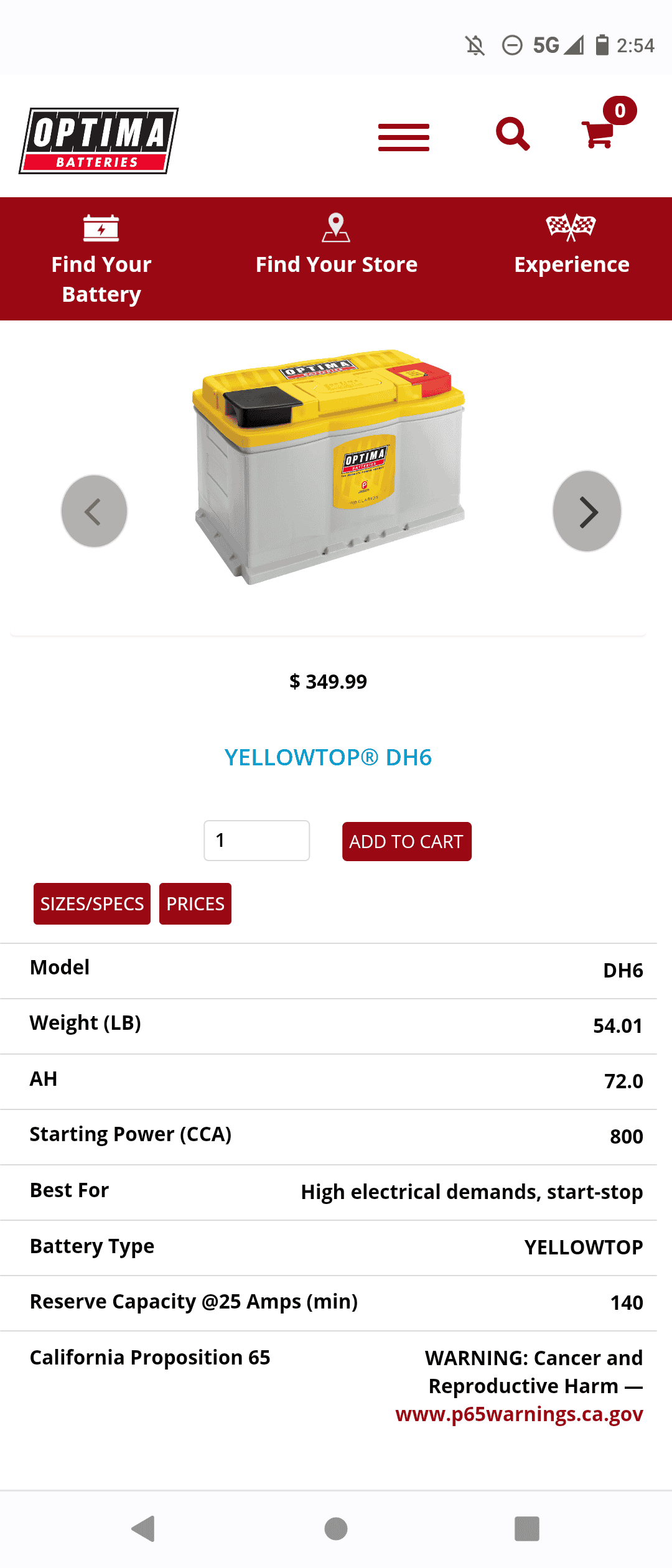

DH7 for my main battery, and then probably a year later I'll be purchasing this guy for my auxiliary...
Jeep Wrangler JL diesel battery options Screenshot_20230328-145439
