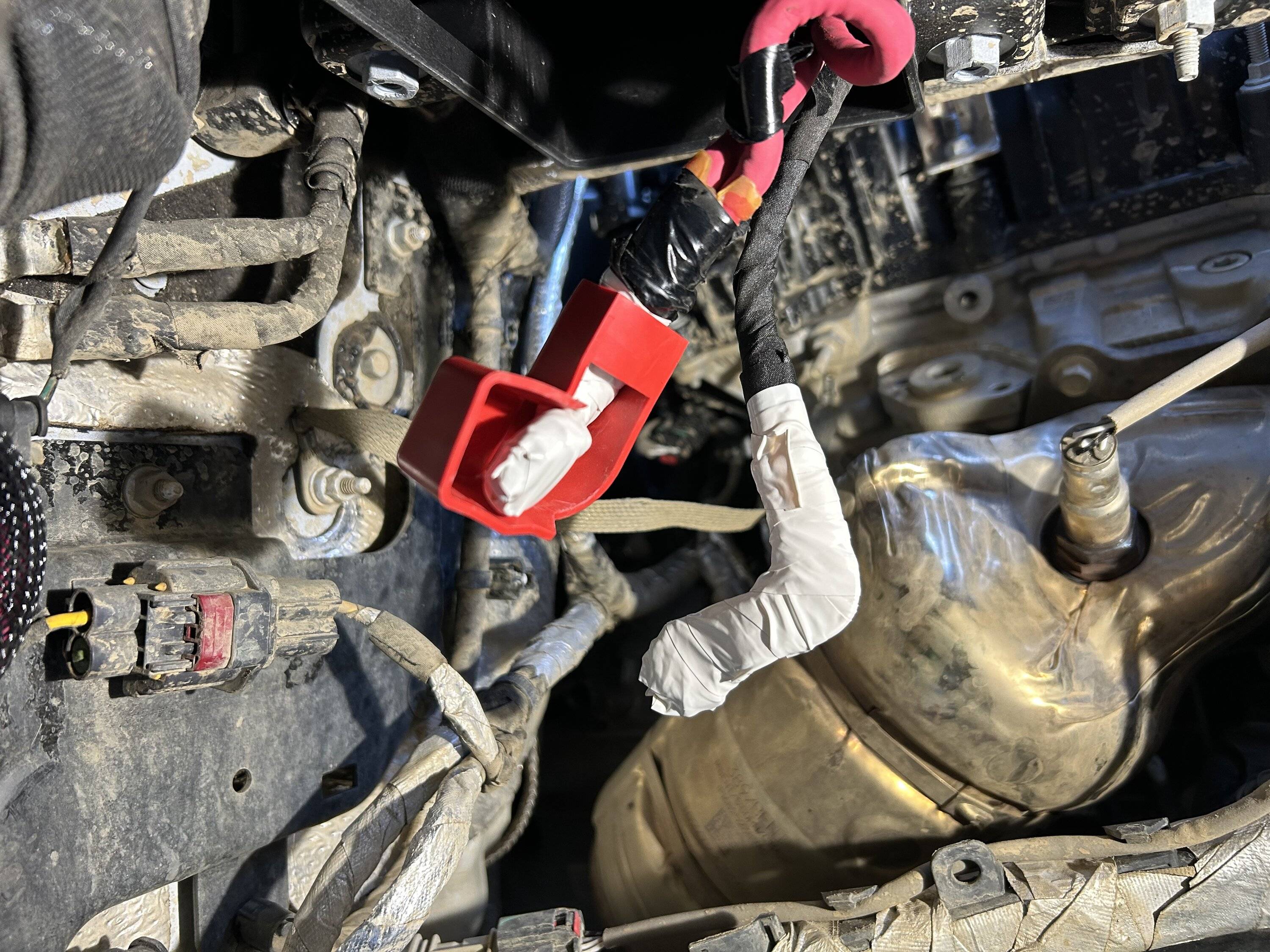

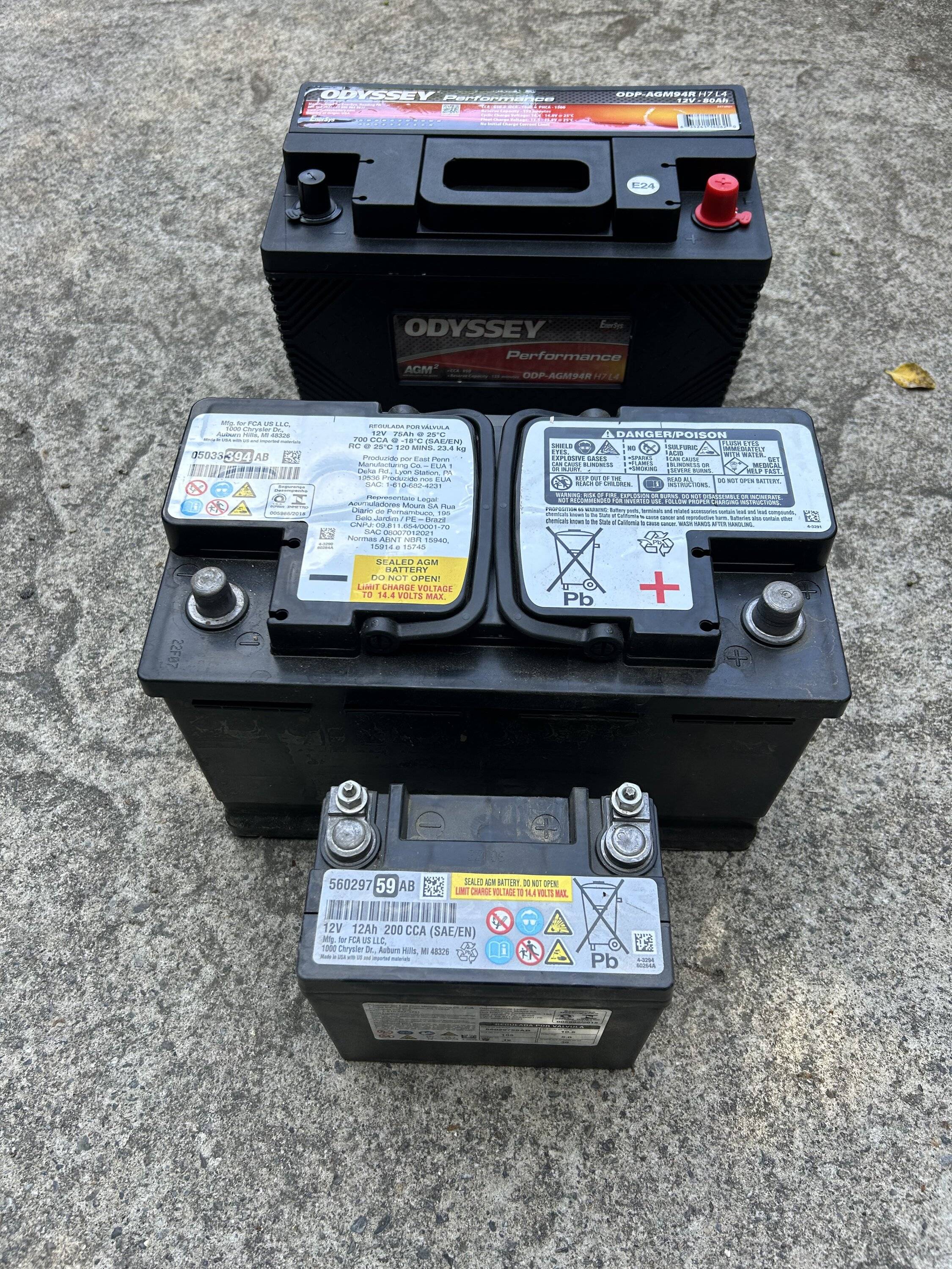

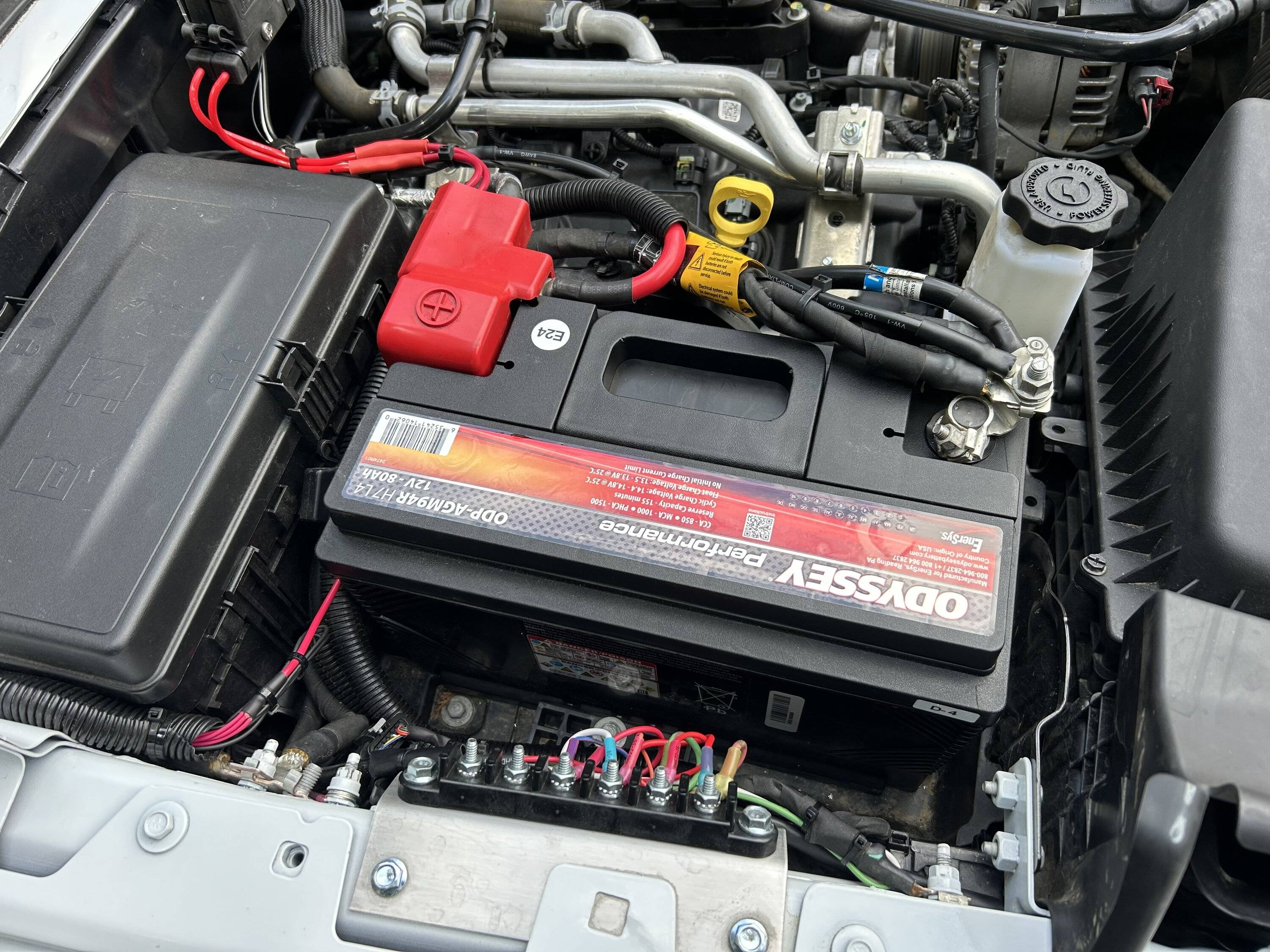

I defused the ticking time-bomb today. This is a MY22. I wasn’t having any problems yet; but I wanted to get this taken care before this summer’s adventures.
I deleted the Aux battery & replaced the main battery with an Odyssey ODP-AGM94R. Removed the little batt through the wheel well, taped off the cables, & removed fuse F42.
Edit: I don’t use the stop/start function & have it disabled with my Tazer.

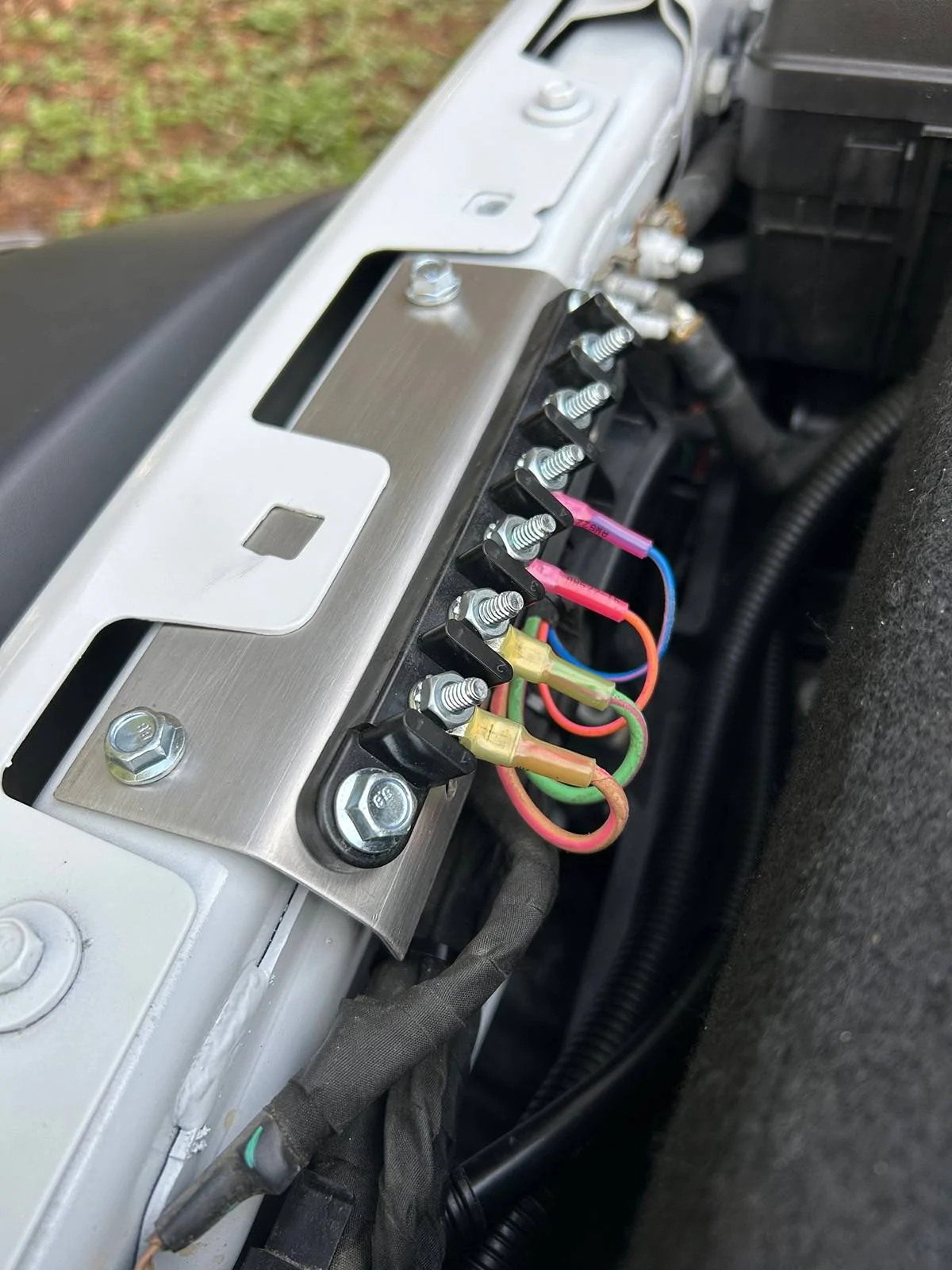

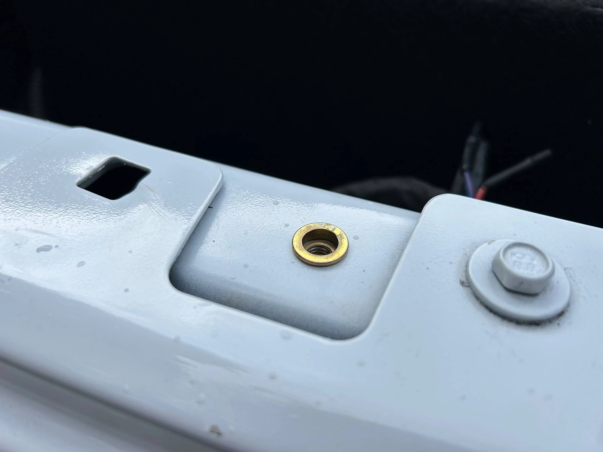

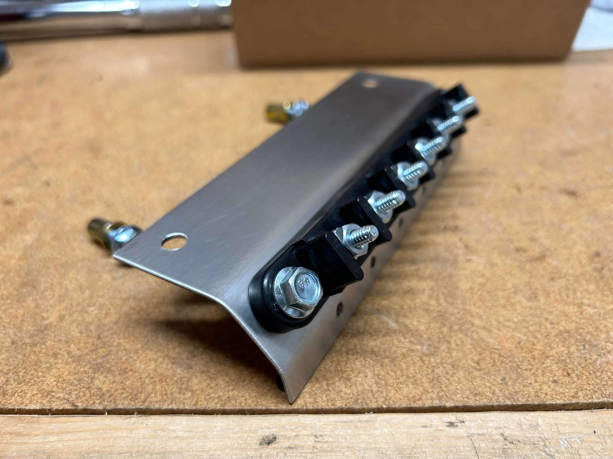

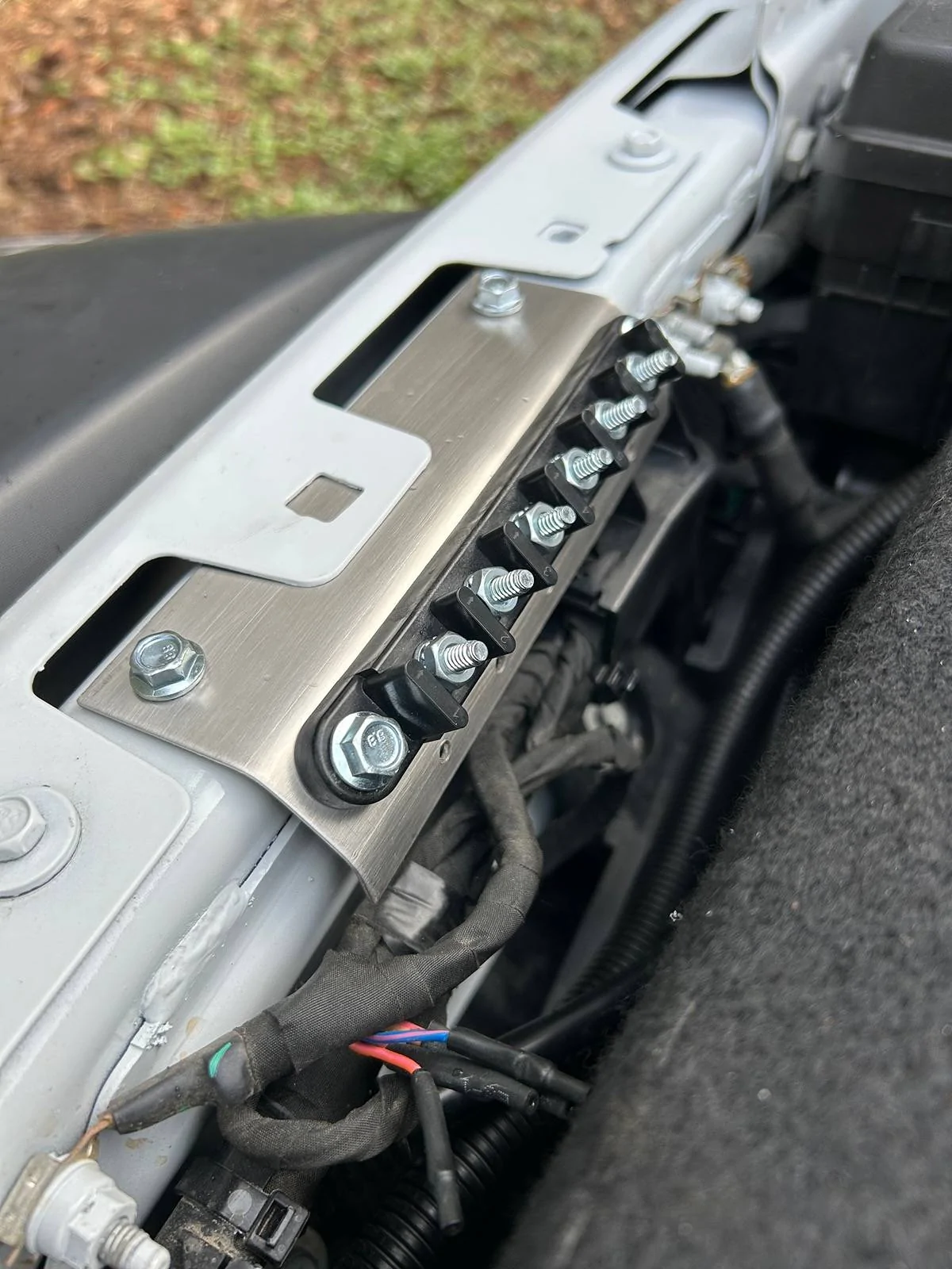

Off topic - but do you mind sharing some information about your bus bar install there for your aux switch accessories? That's a pretty clean install there!
Not at all. I got the terminal strip from Amazon; and custom made the bracket. Nuts & Bolts from Home Depot. The series of holes you see under the terminals are for tie wraps to secure the wires. Here’s some pics:
