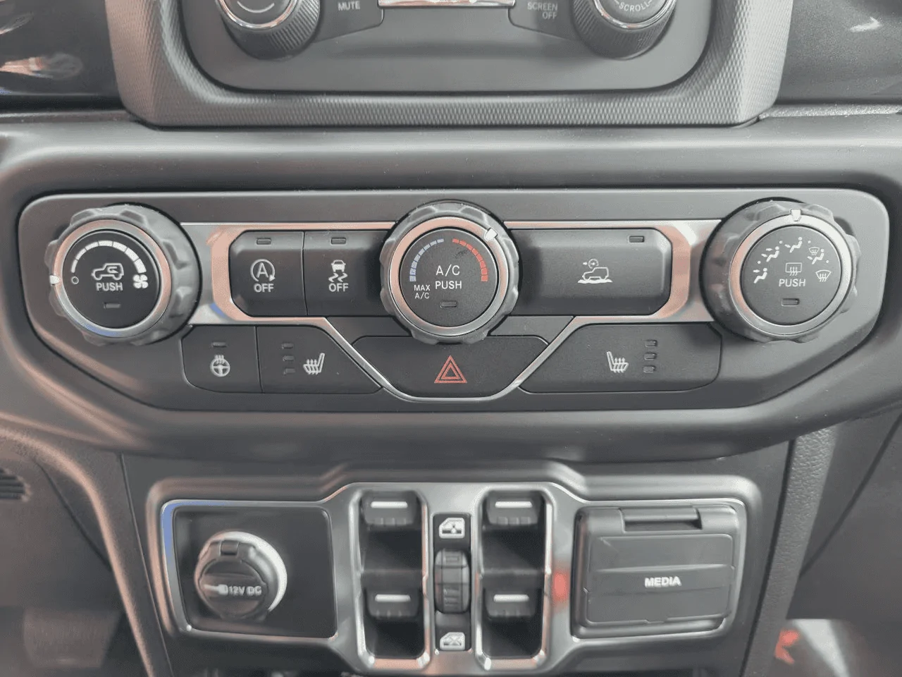

If it's cold, I accidentally turn on the steering wheel heat and if it's warm, I accidentally turn on the 4-way hazard lights. If I need more air, I'll occasionally crank up the volume dial thinking it's the blower.
While it's still better than a touchscreen, I absolutely hate using the JL's vaguely tactile HVAC button controls while I'm driving and actively avoid using it if I can ?
The guys with the old-school 3 dial system are lucky..
