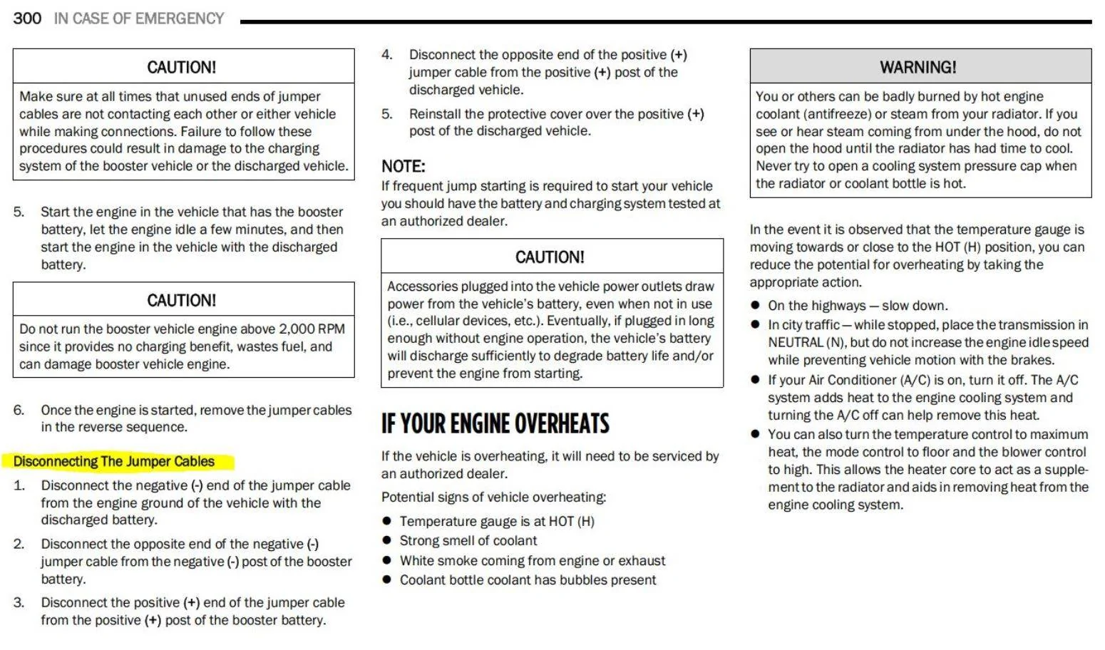

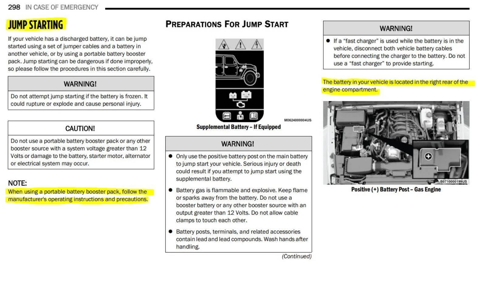

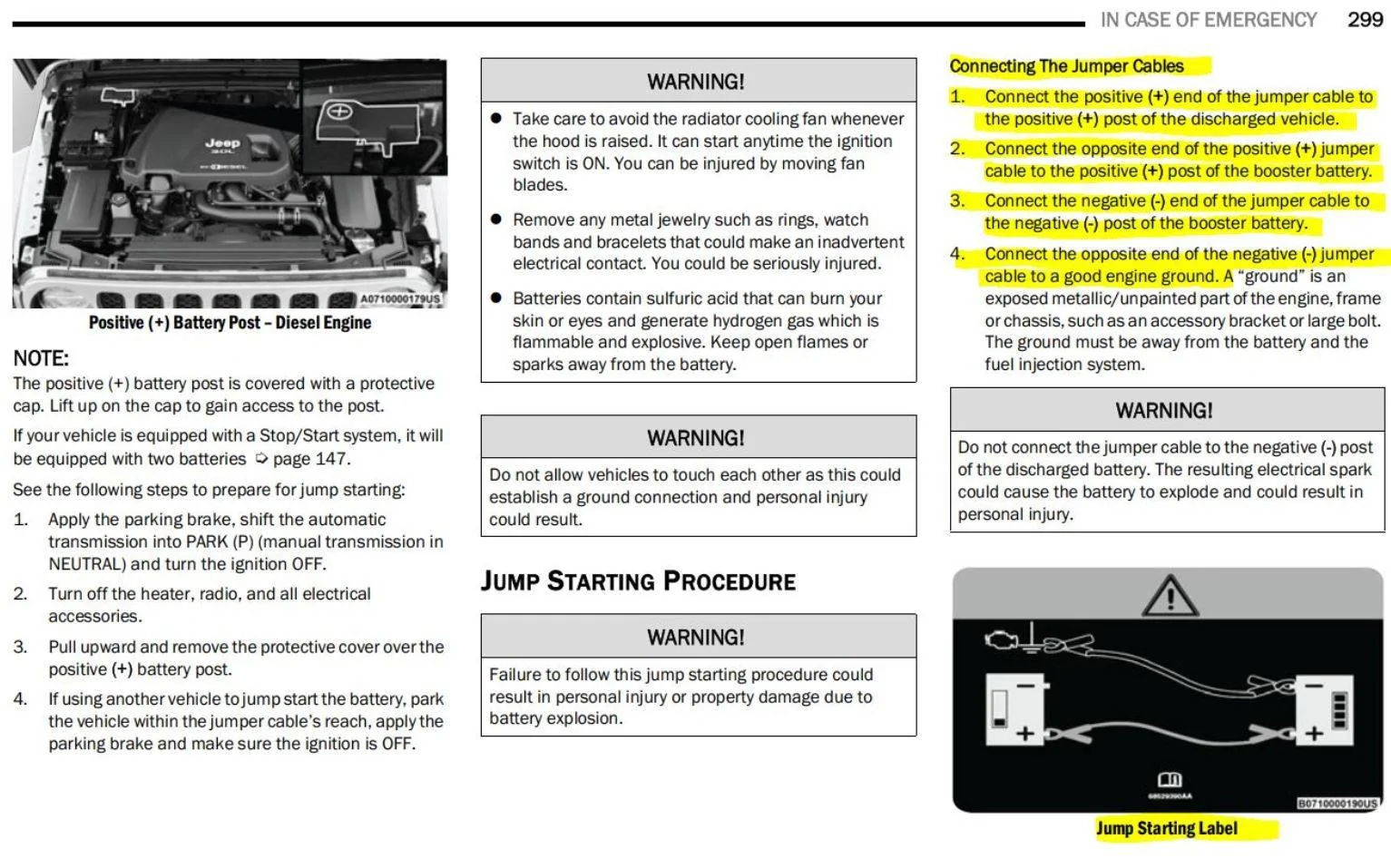

Here you go. It's in the owners manual or you can go into a filtered search on Google.
Jeep Wrangler JL Dead battery. Jump start? jump1
Jeep Wrangler JL Dead battery. Jump start? jump2
Jeep Wrangler JL Dead battery. Jump start? jiump3
