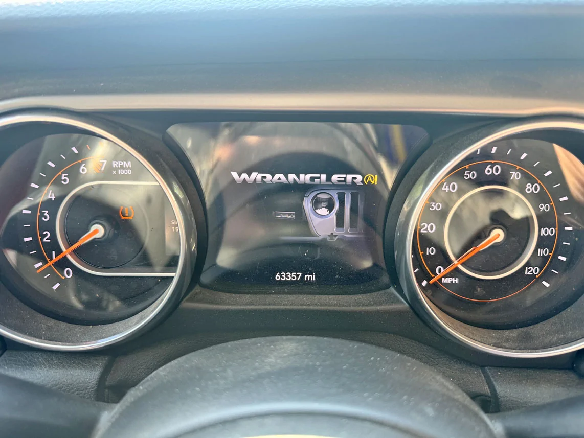

Another Jeep thing?
Driving home from the grocery store this afternoon I see this. Did the computer get stuck trying to boot itself? I took the photo at a stop sign, the engine was still running. None of the buttons on the steering wheel had any affect on it.
Jeep Wrangler JL Dash display stays on? IMG_5975r
wanted
Dec 7, 2024
69
Kansas
2021 jeep rubicon (pending)
I have a 2024 and it done it to me a few times. Notice it happens more often if I make multiple stops (i.e. going to different locations and shutting it off) compared to long trips or just going to work and back.
