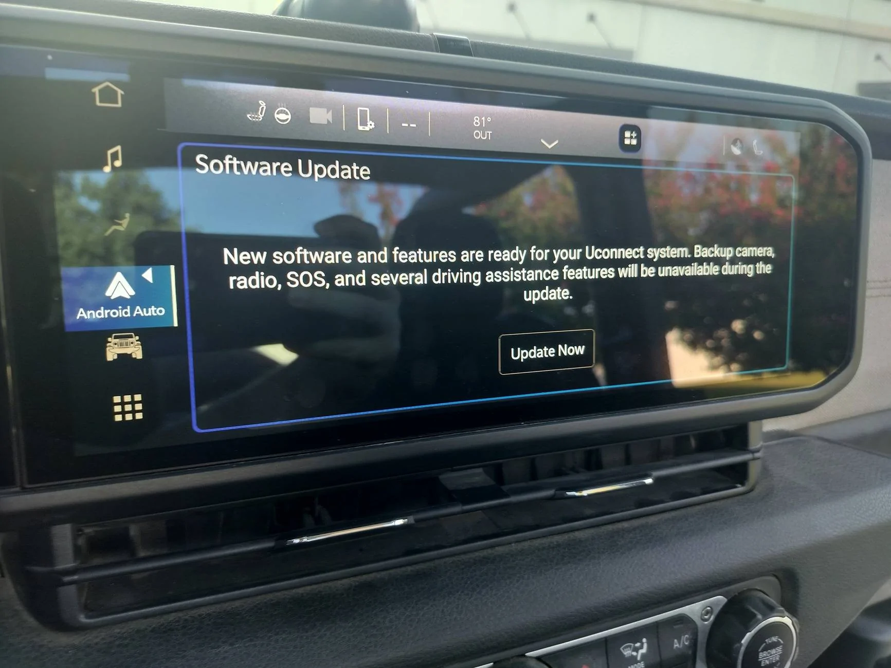

Can't be of much help either, but this morning my Jeep wouldn't turn the radio off because a software update. I just left it parked outside with the radio playing, it shut itself off by the time I went to lunch. The electronics on these things seems a bit buggy.
