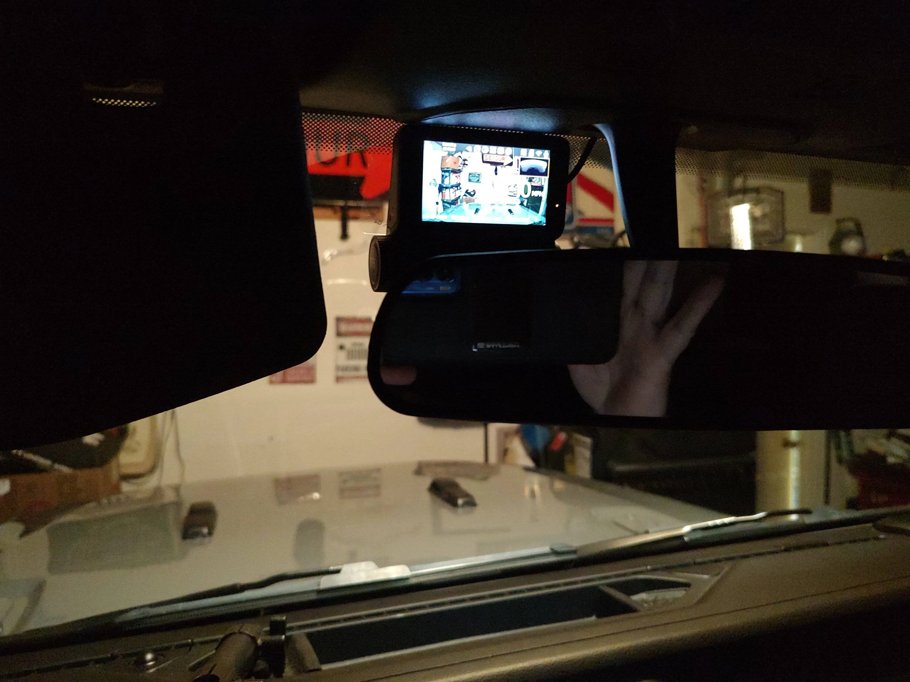

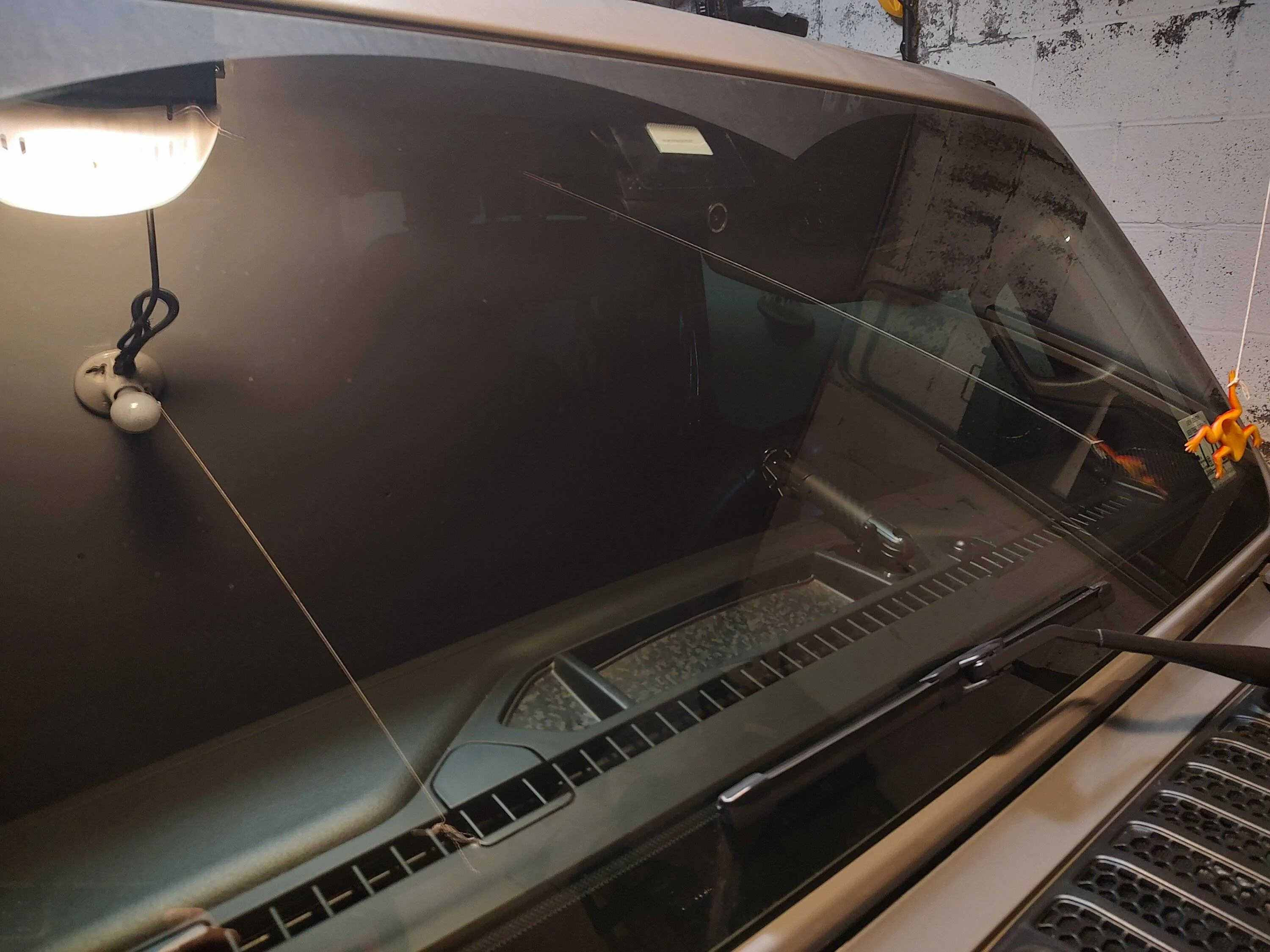

Installed my new Rove3 today!
I really like it so far. I don't need a cabin camera, so I mounted it all the way up to just to the left of the rearview mirror.
It took me about 3 hours because I took a lot of trim apart to completely hide the wires in mounting the power cord and the cord to the rear camera, which I mounted on the rear crossbar just above the light. It actually gets a pretty decent view out the back window of my soft top despite the tire being back there.
The touch screen works great haven't played much with the app on my phone yet but I like how the screen blacks out and shows you your speed and a compass when you aren't actually using it. Thank you to the guys posting all the pics and giving me advice I'm glad I chose this one :)
One thing I would change is the white background to the sticky pad that mounts to the windshield if it were black you wouldn't even see it there at all but the white rectangle makes it stand out a bit.
