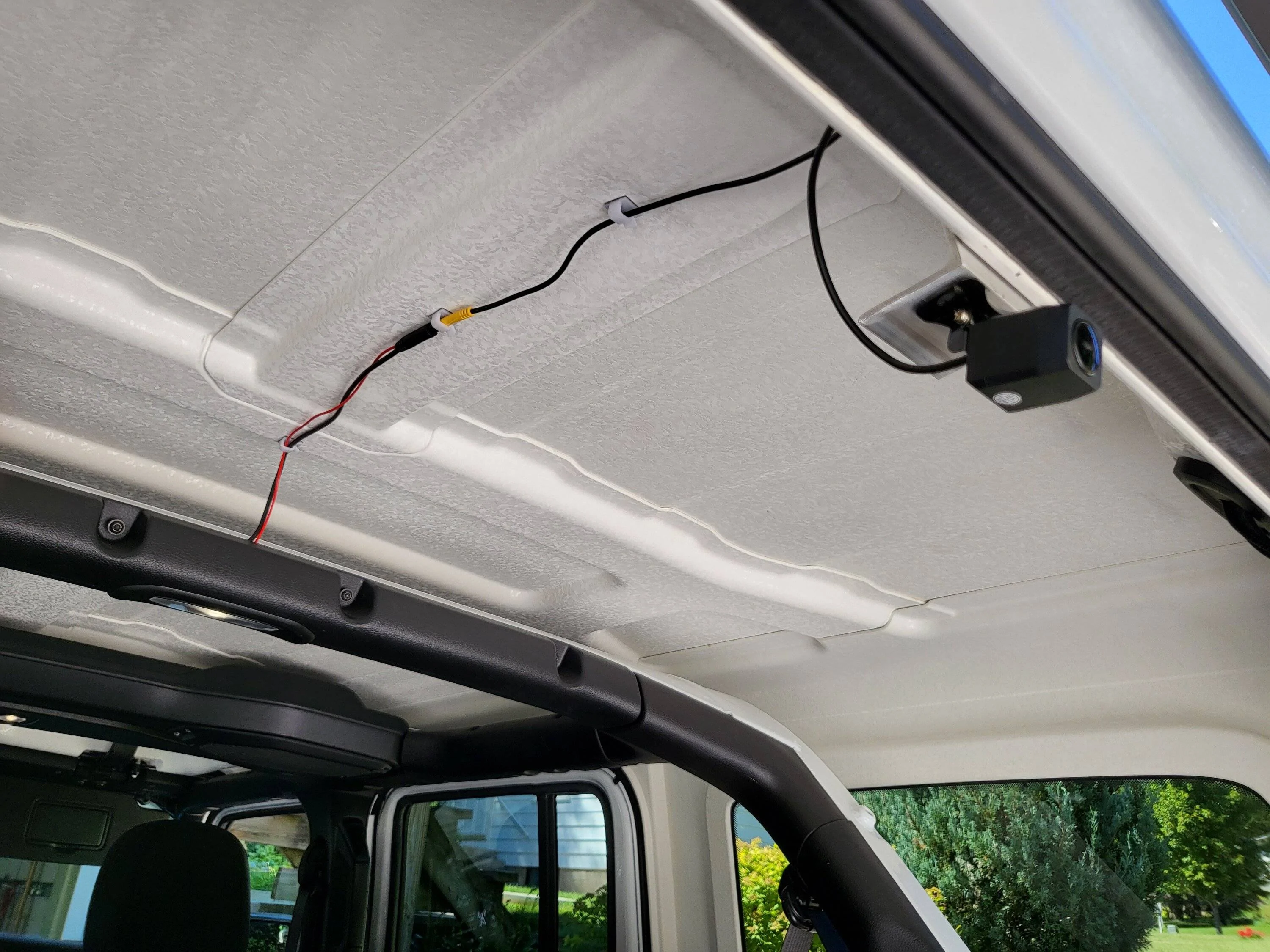

the ones that have the rear camera, where are you guys mounting it? i thought about mounting it on the rear crossbar but my 37 spare just blocks everything. ideally, i would moutn it on my rear window but i take off my top often. don't really want to do a spare tire delete but i guess i have no choice lol

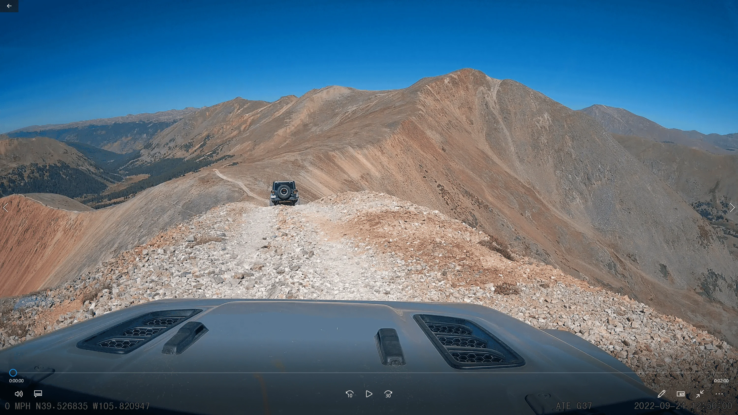

I've been very pleased with the Viofo A129 Pro Duo. It has a 4K front and 1080P rear camera. Get it with the hardwire kit, and hook the power up to your interior Aux constant power & ignition. This will enable parking mode recording.
https://viofo.com/dash-cam/149-viof...-rear-dual-channel-wi-fi-gps-dash-camera.html
I second the Viofo with the hardwire kit (if you have factory aux switches you can pull both battery and ignition power from the passenger footwell). It's reasonably priced, compact, does excellent video and has a decent mic. The rear camera cable is long enough to route discretely to the back window. I also use the Viofo as a video source when 4-wheeling.
