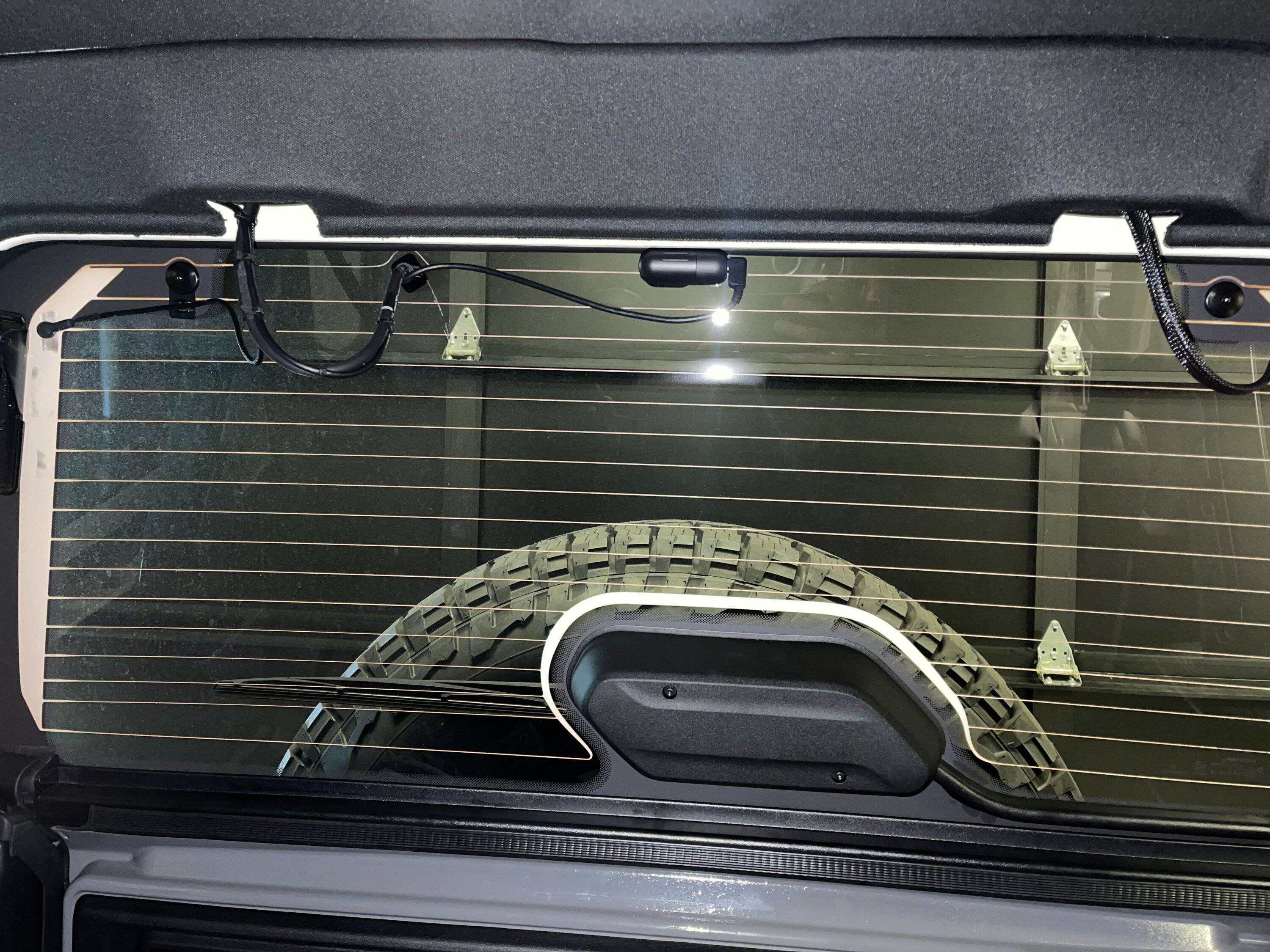

I don't have a picture handy, but I stuck rear camera on the last cross member so I didn't have to worry about taking the top off. The spare does impact the view to some degree, but I was willing to make that trade off.

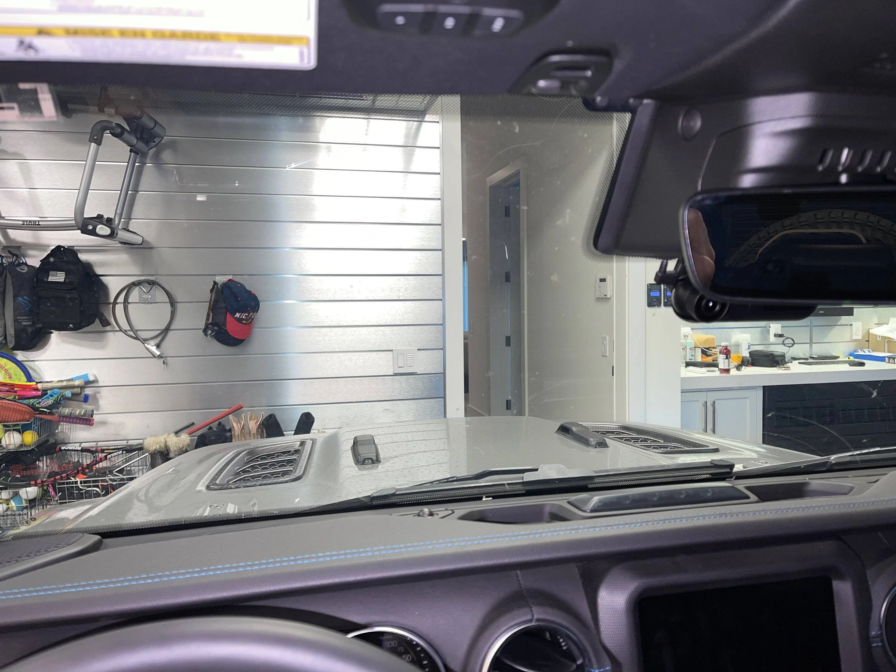

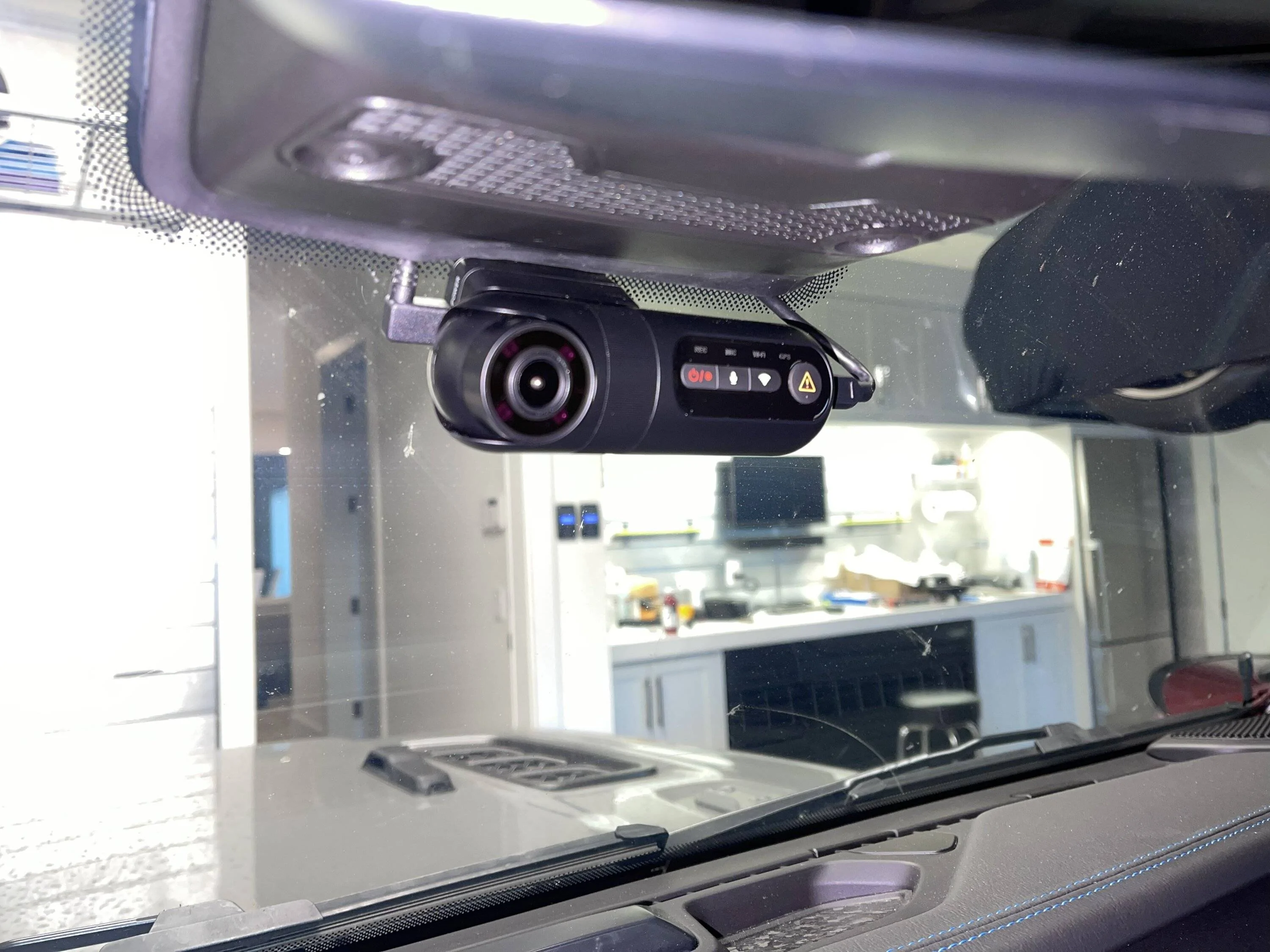

i third Viofo ;-) Running T130 model, its awesome! Super smooth install, cant see it under the rear view mirror, has both forward facing/interior and rear camera.. Ive hardwired it as well but didnt play with the parking feature. My install was little bit diff as i needed to tap my trigger off cigarette lighter but pretty easy to do with wire tap (since i didnt buy AUX OEM group)
second picture is from drivers eye point of view I don’t even see it when driving.

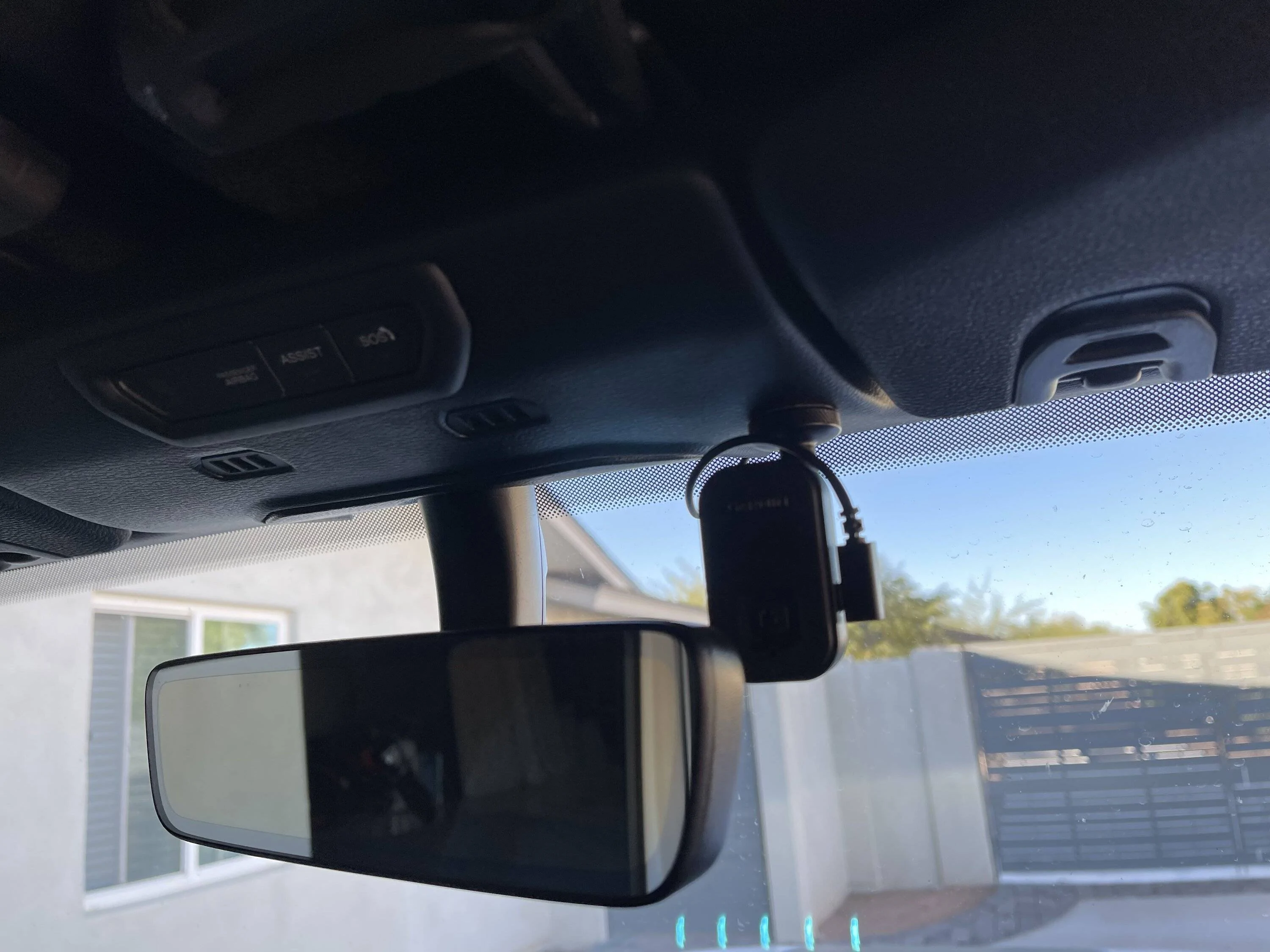

I have the Garmin mini in two of our cars. We were able to tap into the power in the rearview mirror with an adaptor so it’s a super easy install. Does anybody know if we can do that with the Jeep? Or maybe someone can tell me if their 22 or 23 Rubicon has power to the rear view mirror?

thank you! That’s helpful.
Mine has a larger enclosed area to remove since it has the safety packages but this is a good starting point.
