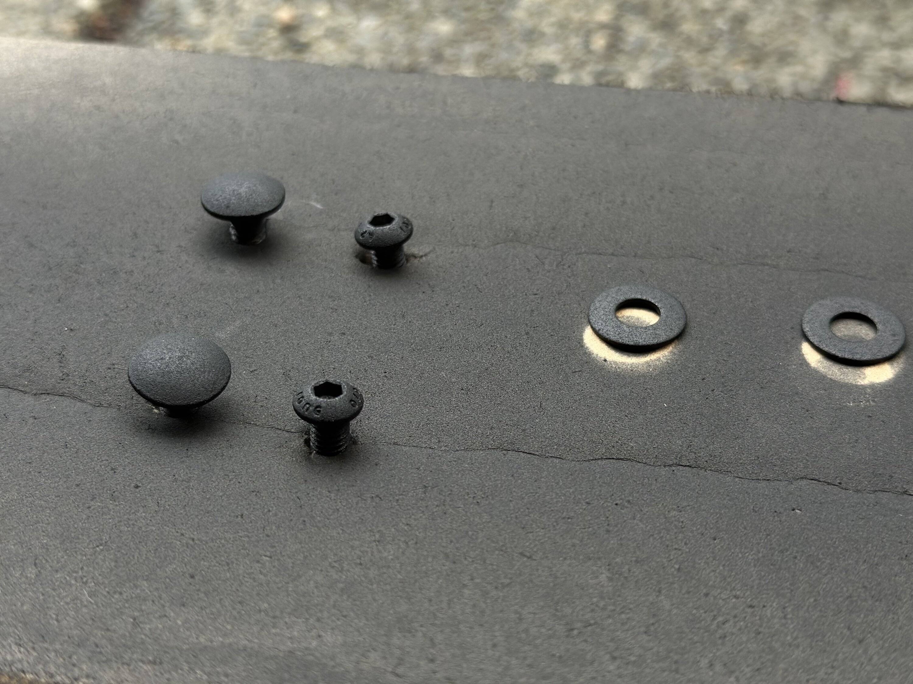

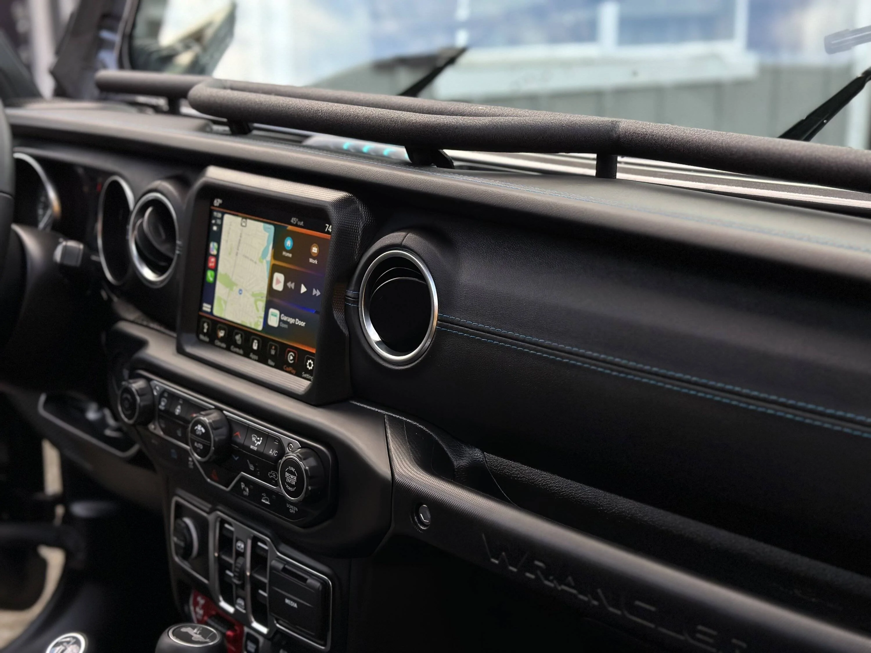

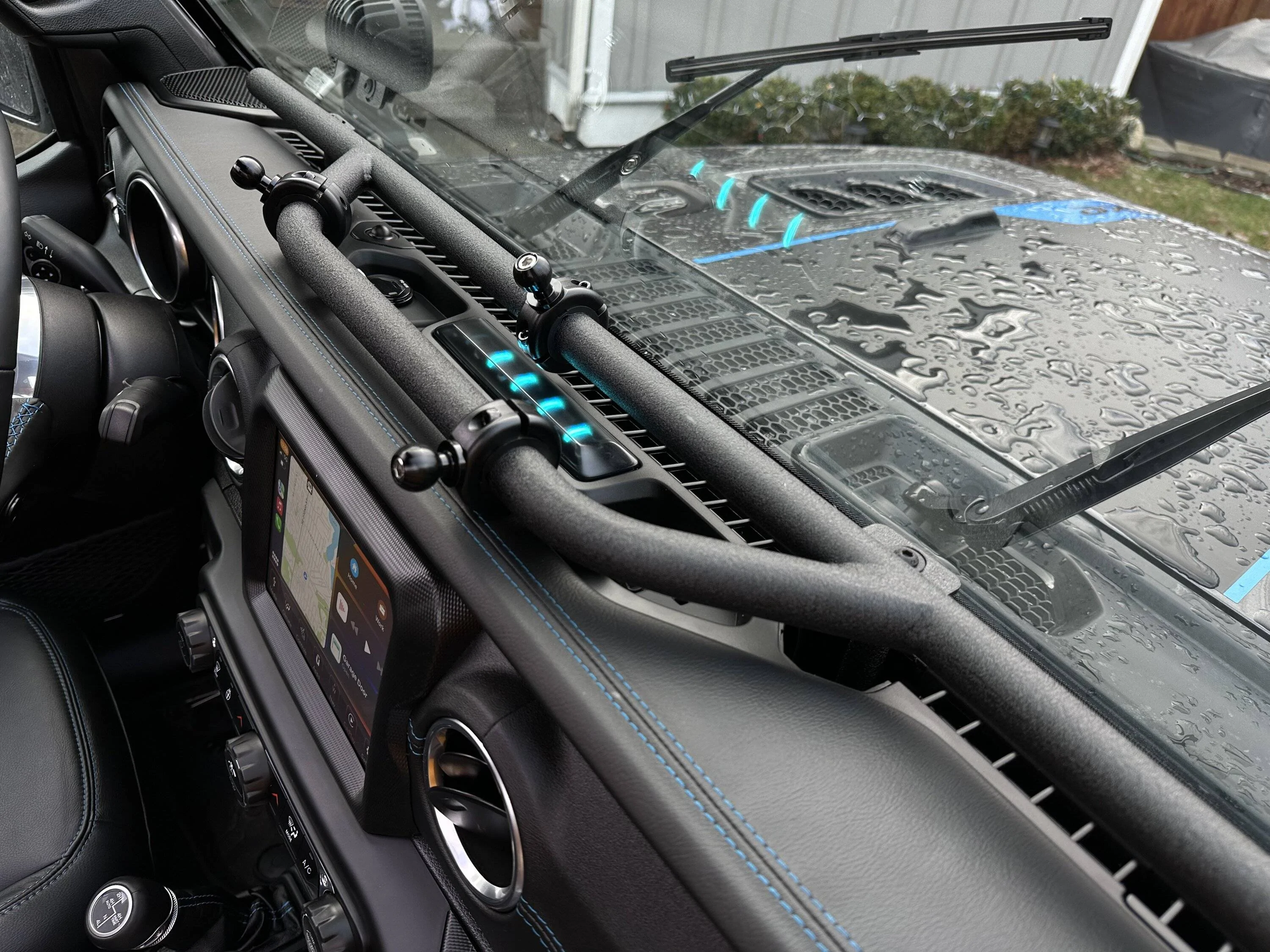

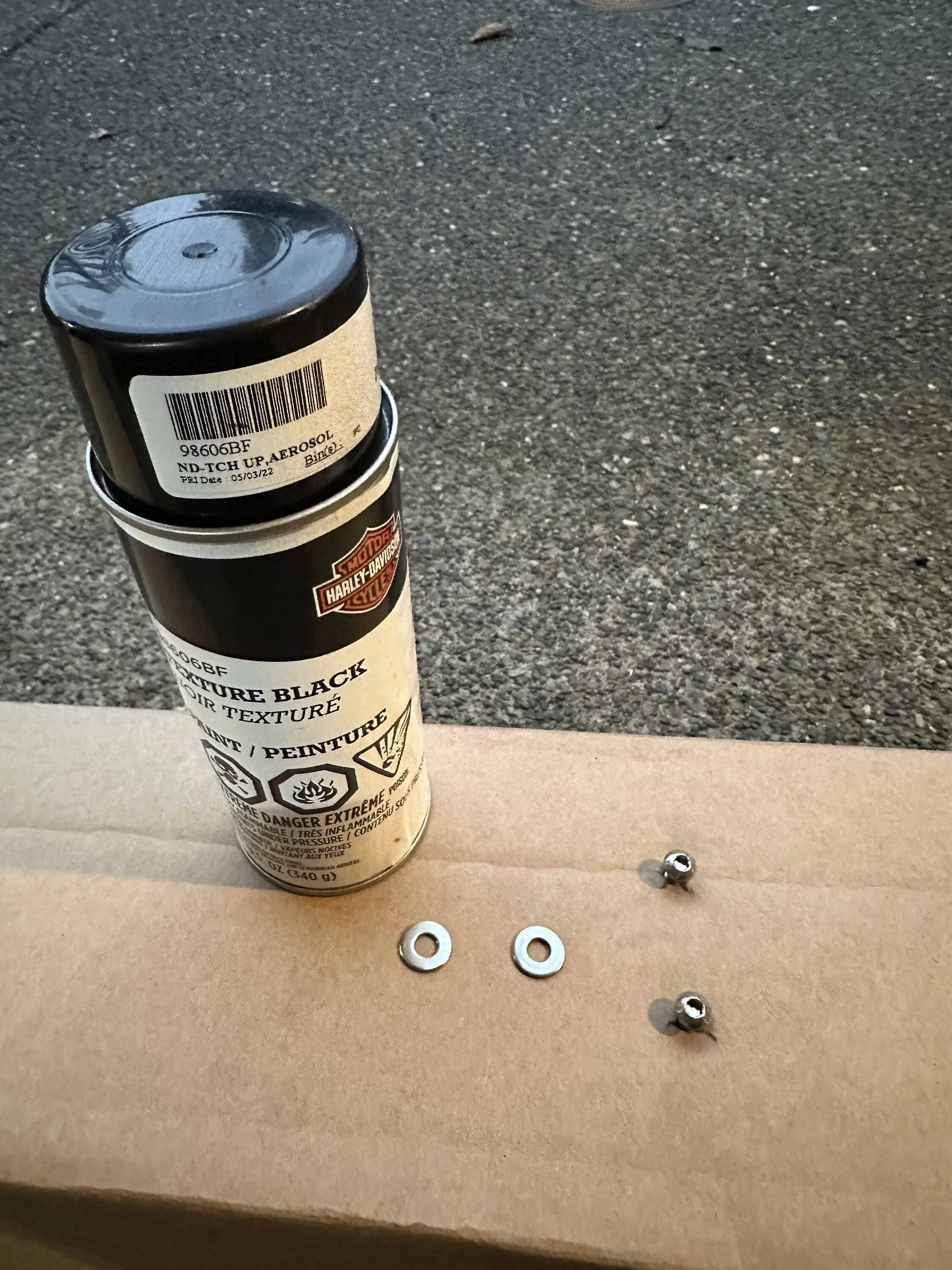

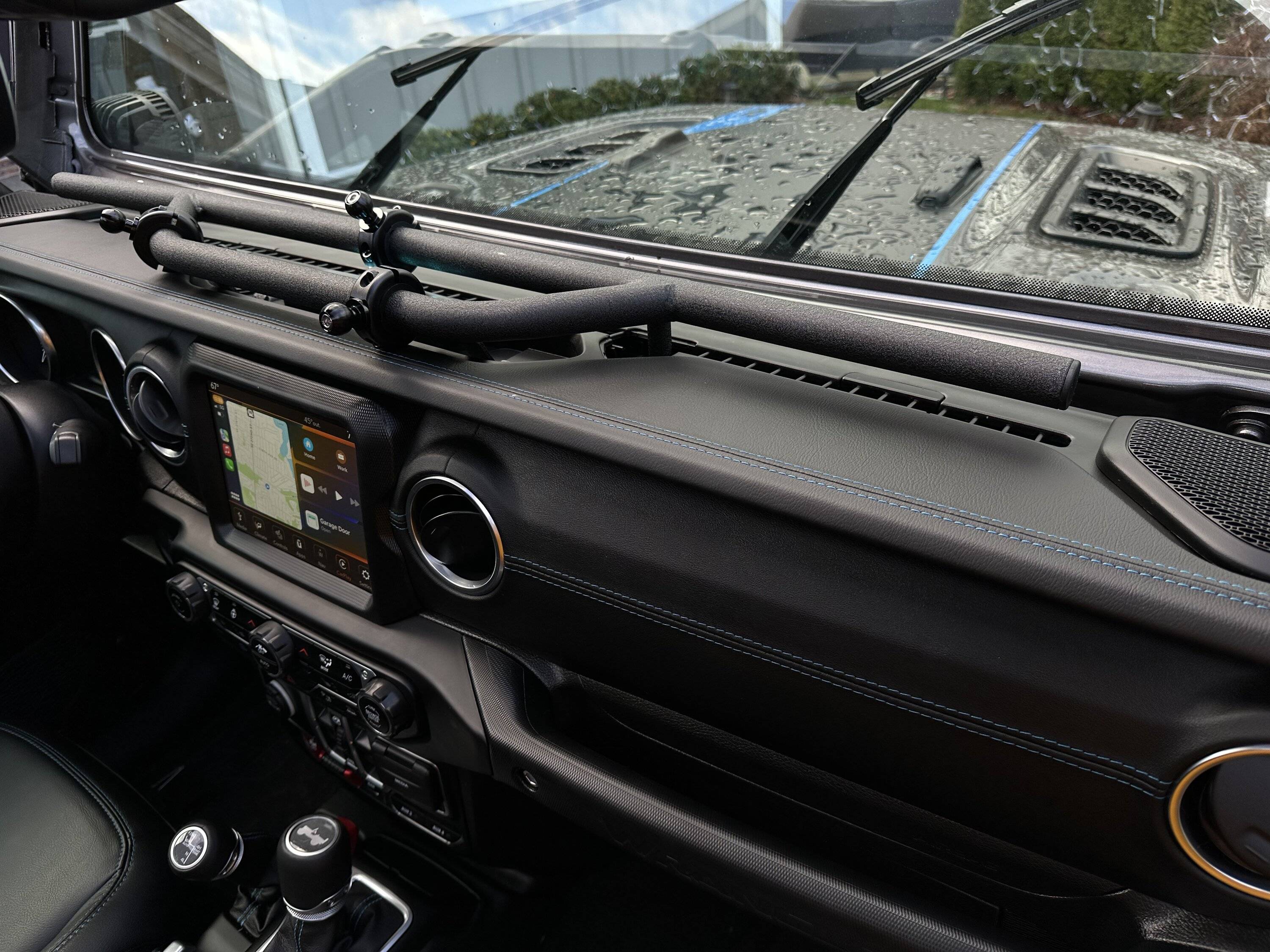

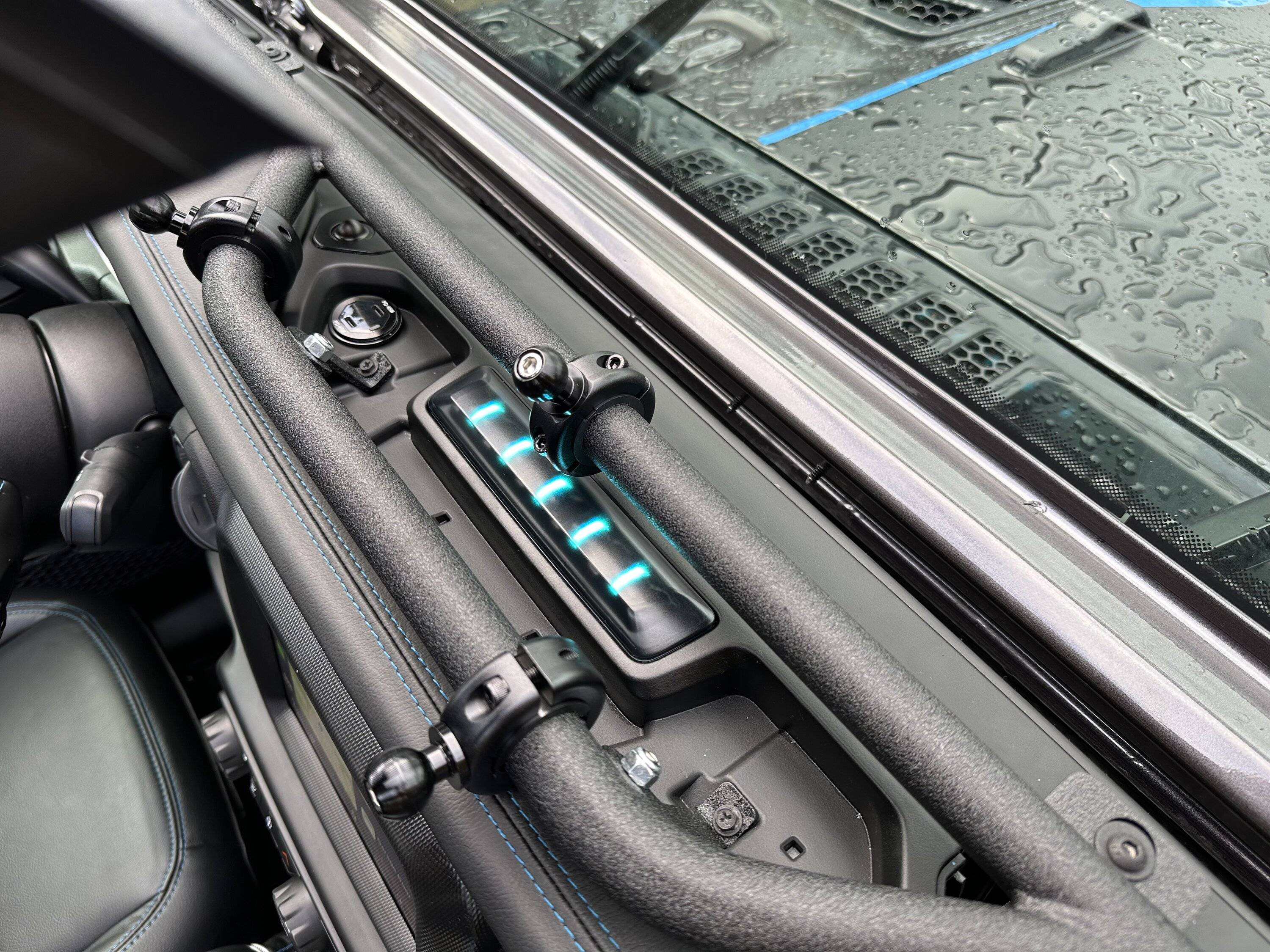

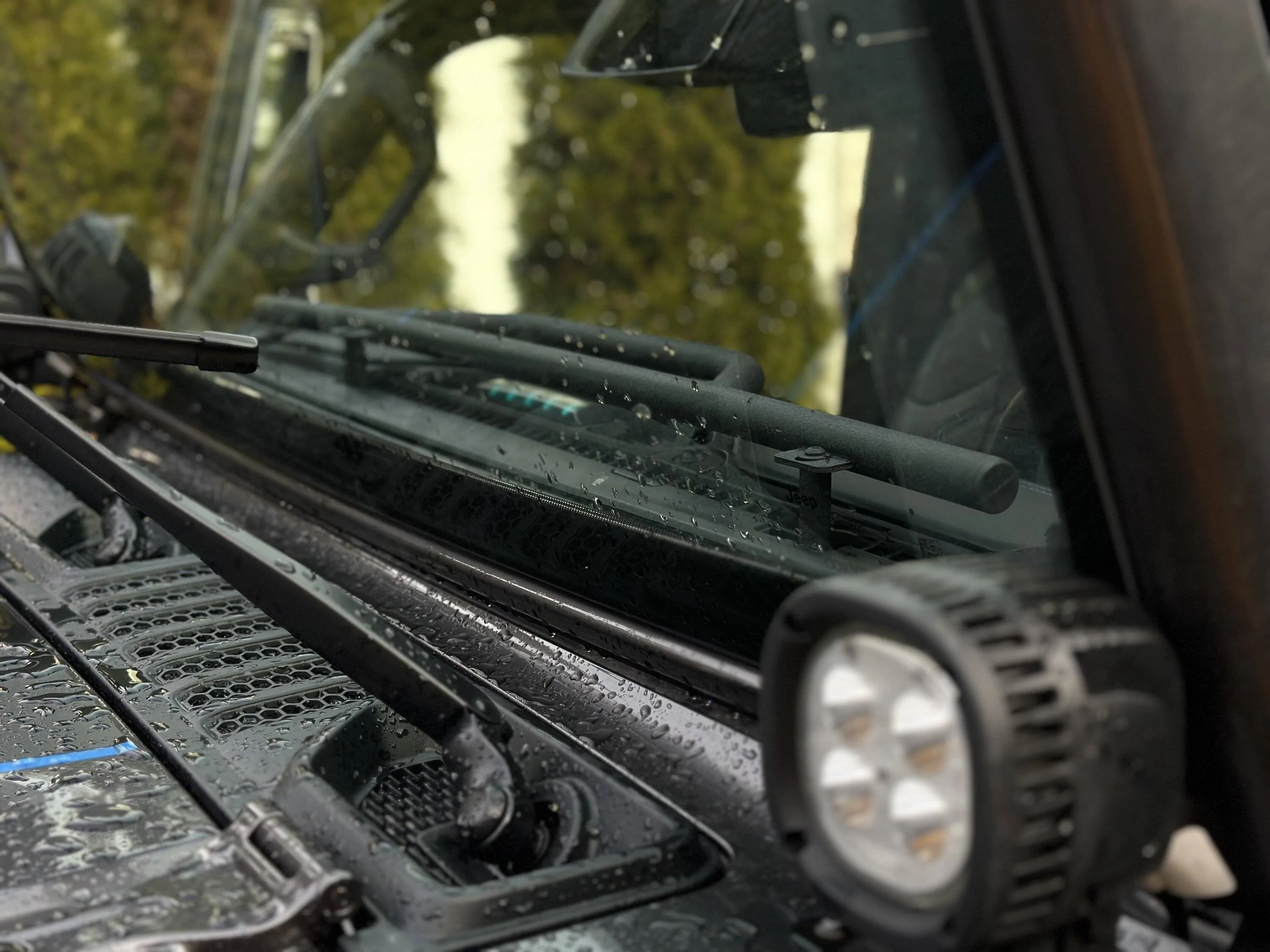

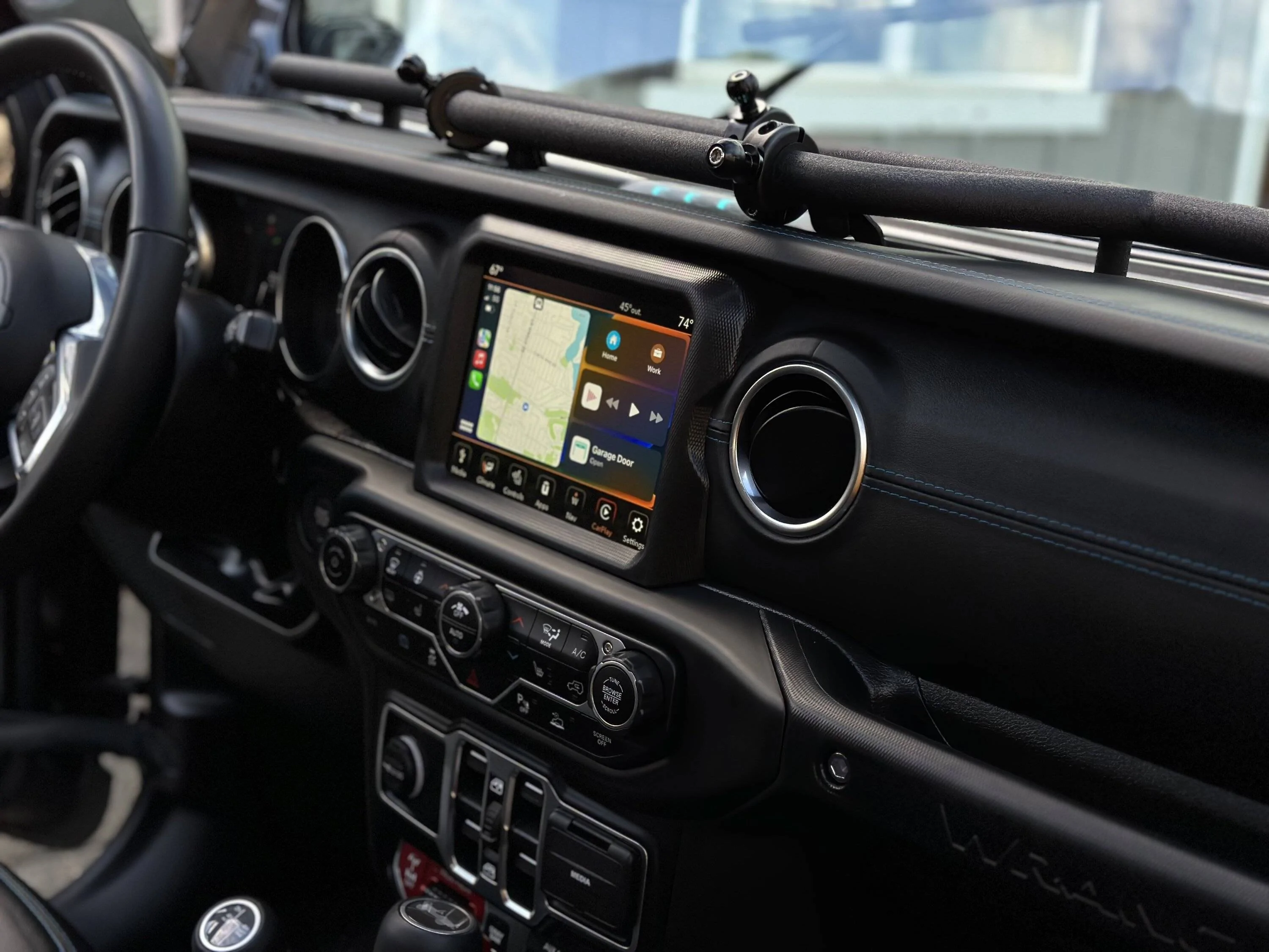

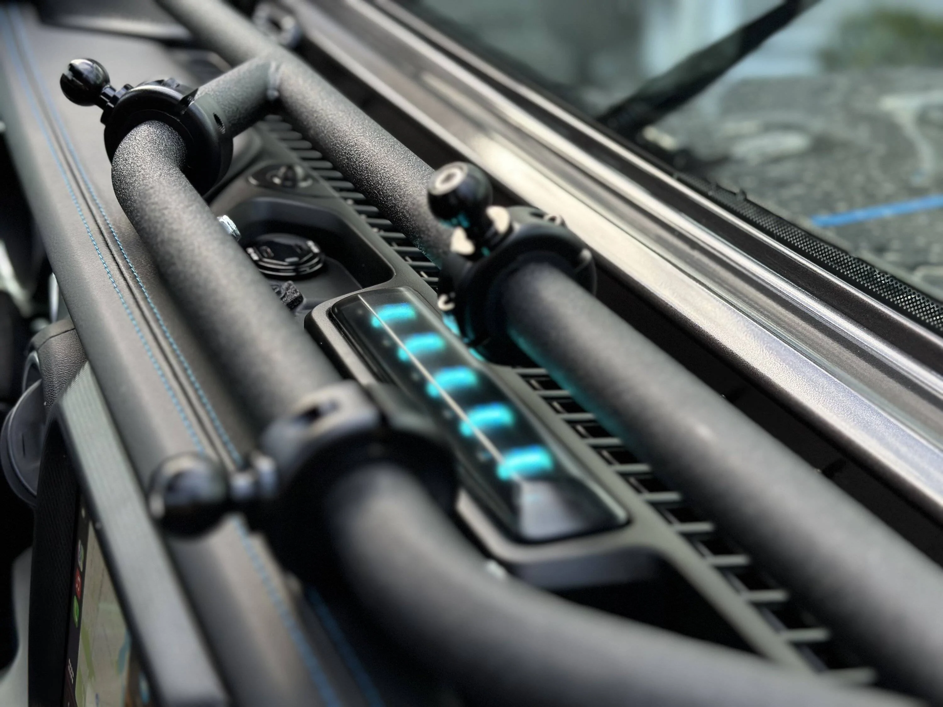

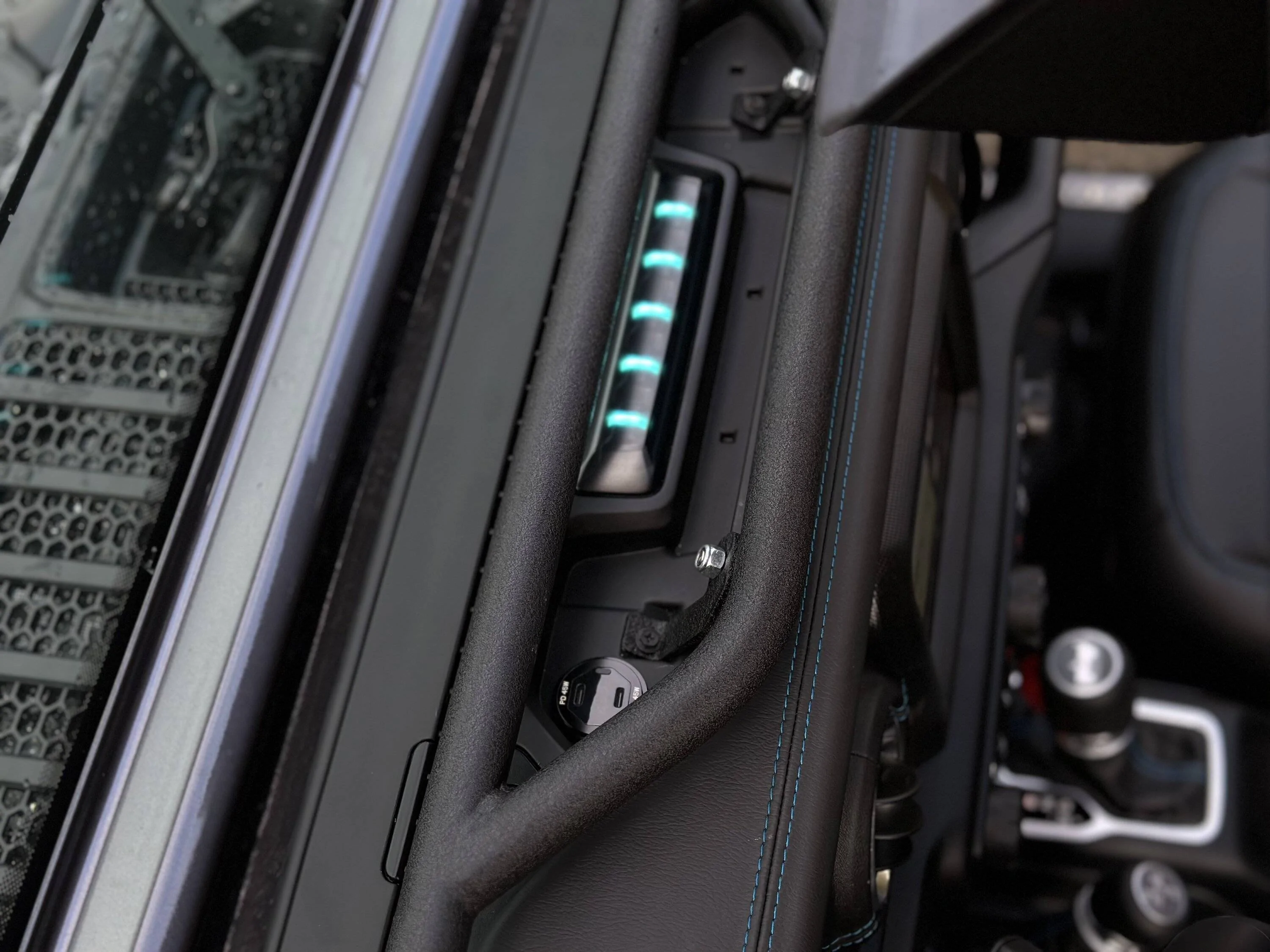

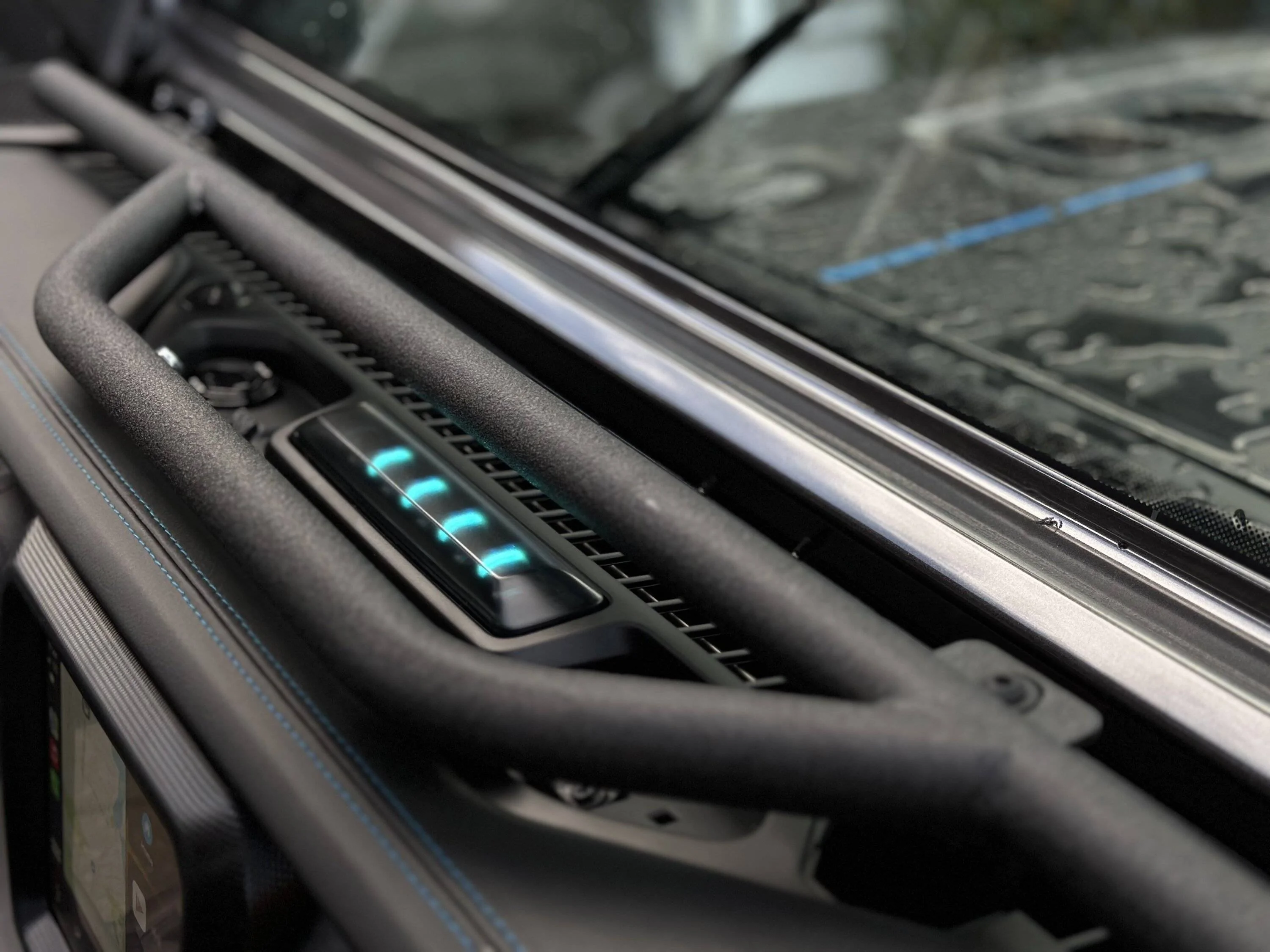

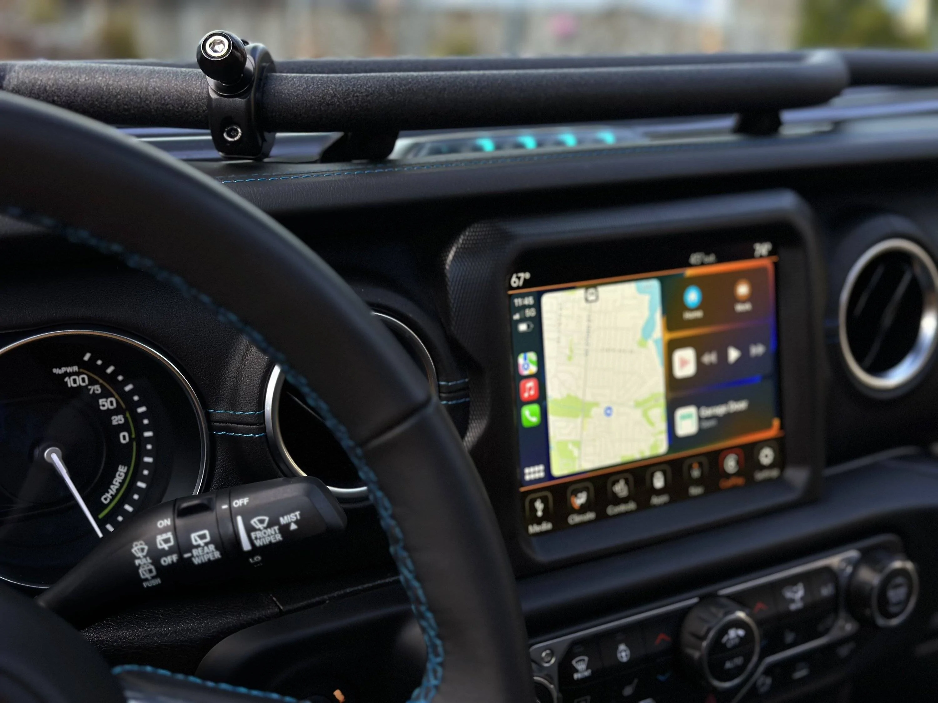

I finally got my vector e-dock for my 22 4xe Rubi. It fits great, and I am in love. My only criticism is I wish it came with all-black screws. The silver screws reflected on my windshield, and while not very noticeable, it bothered me a little. Also, the silver screws in the middle did not look good or blend in well with the rest of the dash. Quick fix: Harley textured black spray can :) - @Vector Offroad, please take notes ;)
While at it, I installed an upper dash dual USB-C outlet, so all the cables are plugged there to keep the dash nice and clean.

Thank you. It's very simple. I used these two parts:
- Dual PD 45W USB C Charger Socket
- 12 Volt Power Adapter
The 12v power adapter plugs in behind the cigarette lighter and provides power to the dual USB-C charger socket. That's it.
You will need to take the head unit out to reach everything and drill a hole from the top to fit the USB charger. It's a lot simpler to fold the windshield so you have more room to work with.
