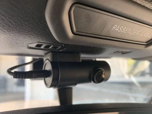

1. Is the camera holding well on the plastic behind the rearview mirror? Did you use any special tape?
2. Where did you hide all that extra wire that connects the front camera to the rear camera??
Thanks
The adhesive that came on the camera held for about 4 weeks before the camera fell and hung by the wires. I replaced the original adhesive with 3M VHB 4950 Tape. So far it is holding fine. Just be sure to clean the plastic with an alcohol prep wipe.
That long cord to the rear camera sucks. I contacted BlackVue for a shorter cord, but none is available. I tucked the excess cord under the windshield header trim.

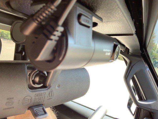

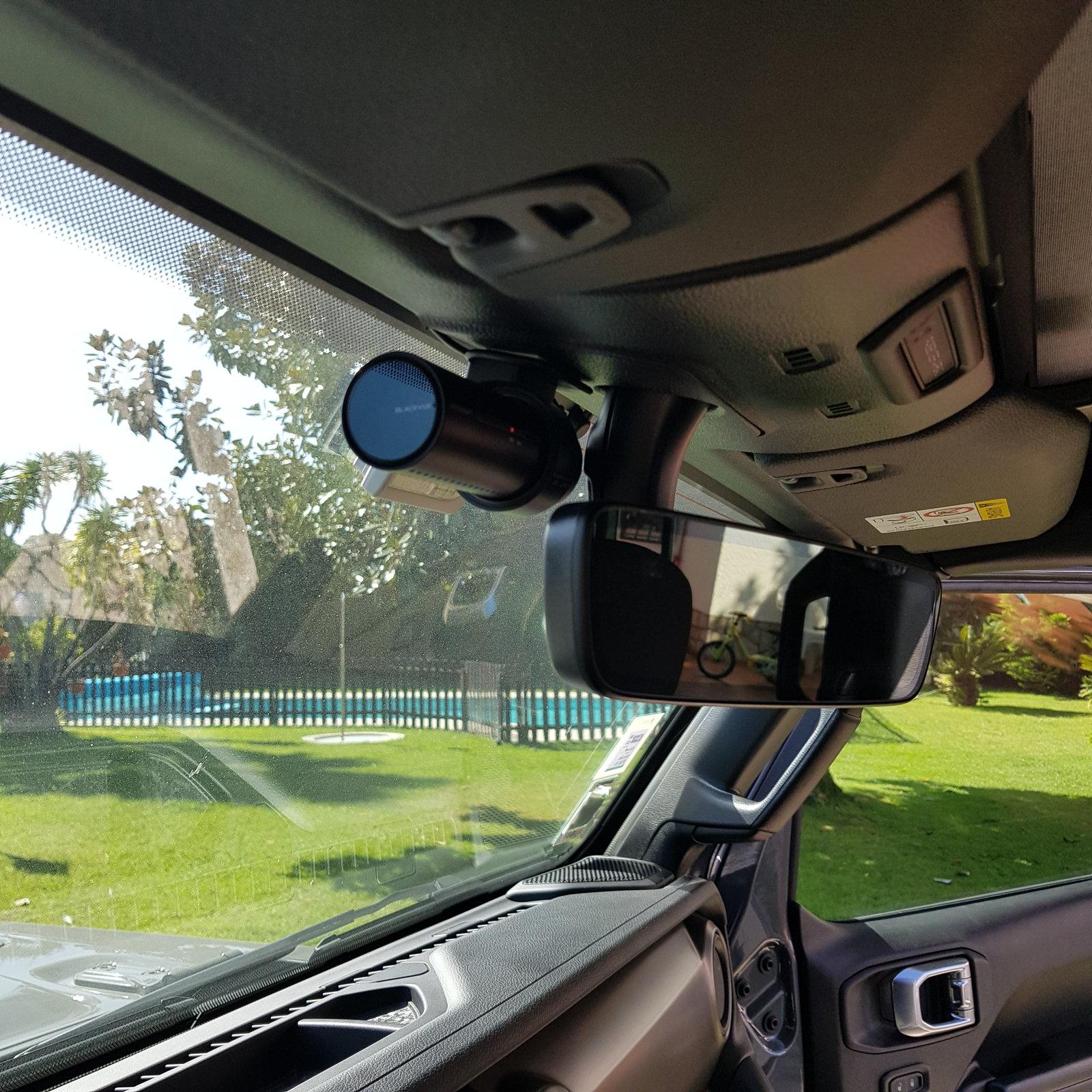

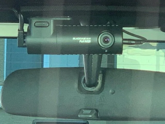

I installed a BlackVue dashcam this past weekend. Mounted the front camera just in front of the rear view mirror and mounted the rear camera just behind the rear view mirror for interior surveillance during parking mode. For power I used BlackVue's Power Magic EZ OBD2 adapter. Easy install and very happy with the results. Cameras are not effected by top removal, nor windshield folding.

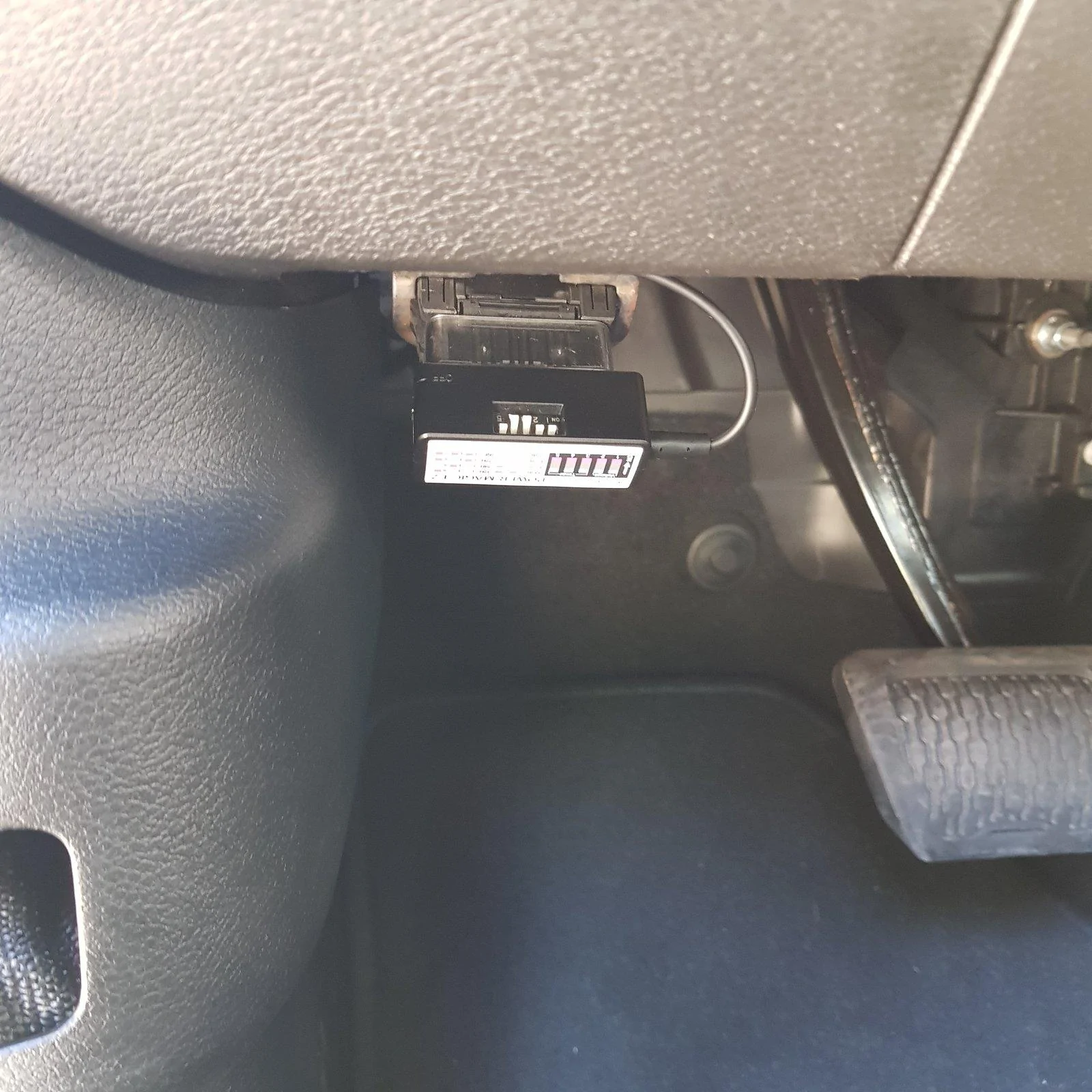

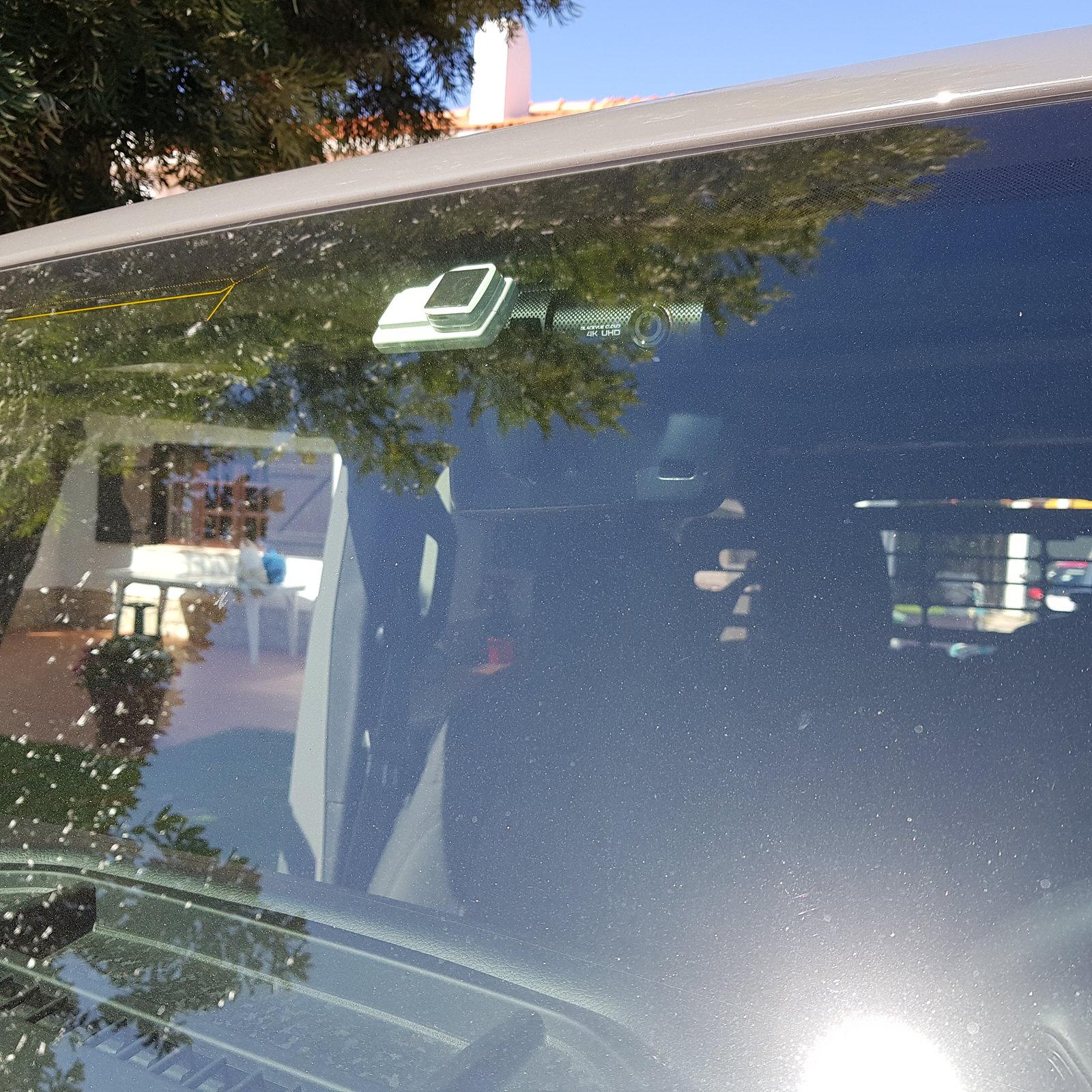

So, I finally mounted the Blackvue DR900S-2CH with the Power Magic EZ.
Setup was pretty easy and is working just fine, and is discrete enough.
I´m having a little trouble with the EZ. Just managed to get it to work with the setting on the photo. Every other combination does not power the dash cam, even with the car running. :/

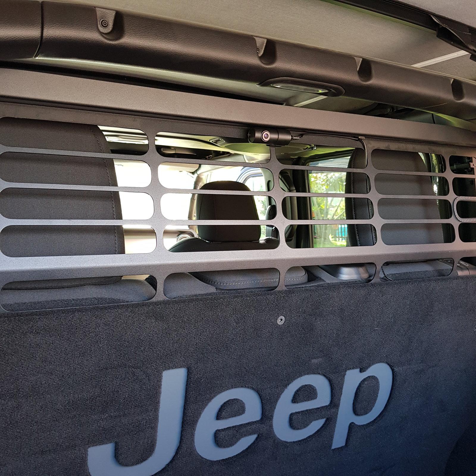

On the photo of the rear, can you tell me what that is that is metal and the Jeep Carpet?
