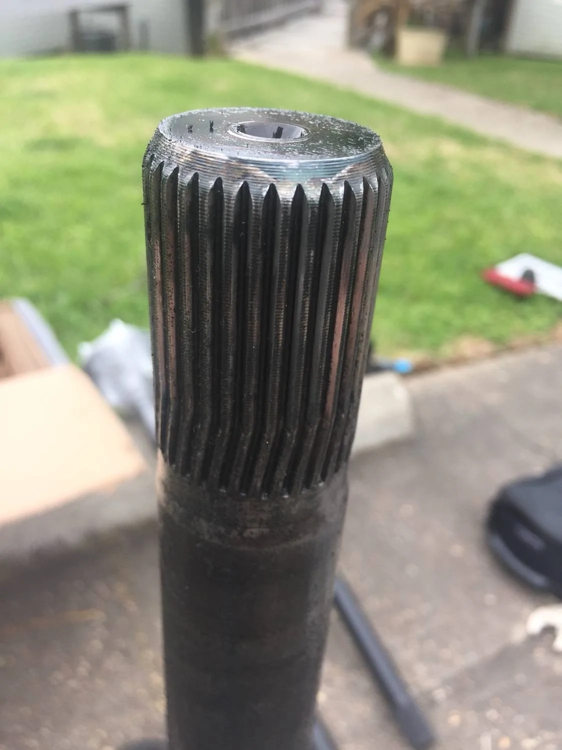

Considering you can easily do this in a V6 JK, I can only imagine what 2WD will do to various components in a 392 Wrangler over time.
