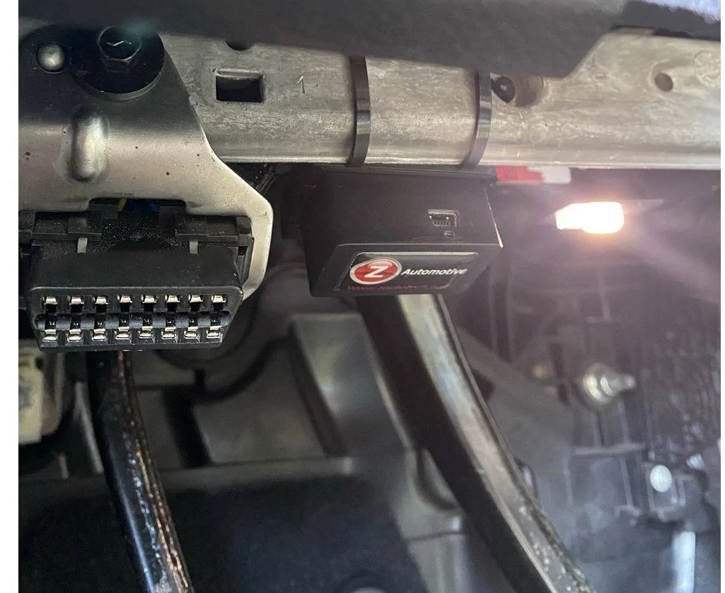

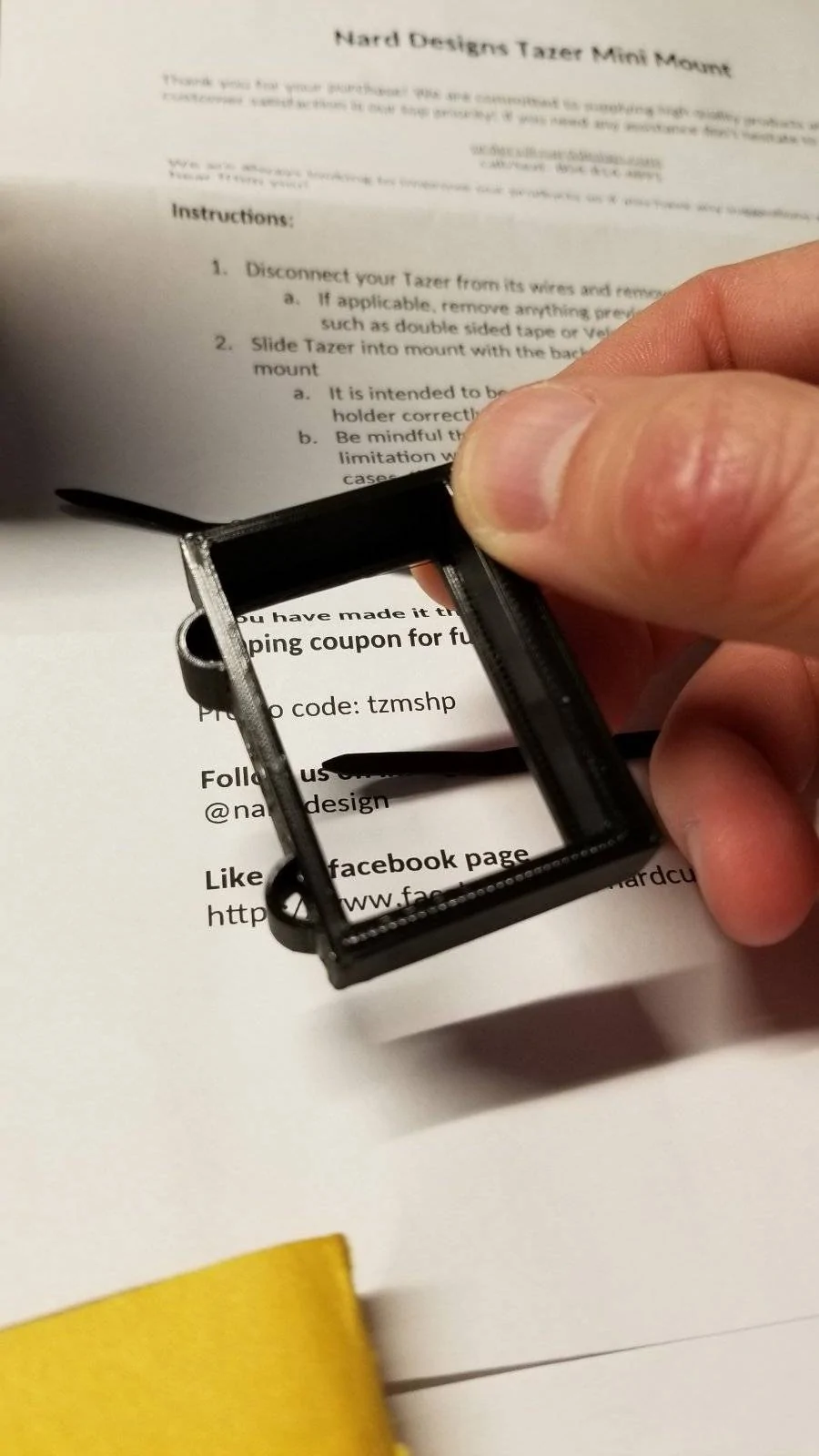

Oh, before I forget..... for those that might be interested in a nifty holder for the Tazer JL Mini.... do check this out... I came across it today......I don't know the guy, or tested driven the offering.. but his little $9.99 offering is kinda slick..
https://narddesign.com/collections/parts/products/tazer-mini-mount
I bought one and it arrived a few days ago (I have not installed it yet). It appears to be fine as far as quality and construction. I also bought the harness to prevent having to plug the OEM cables back into the security gateway to make it much easier to remove and reinstall the tazer when I have to take it into the dealer.

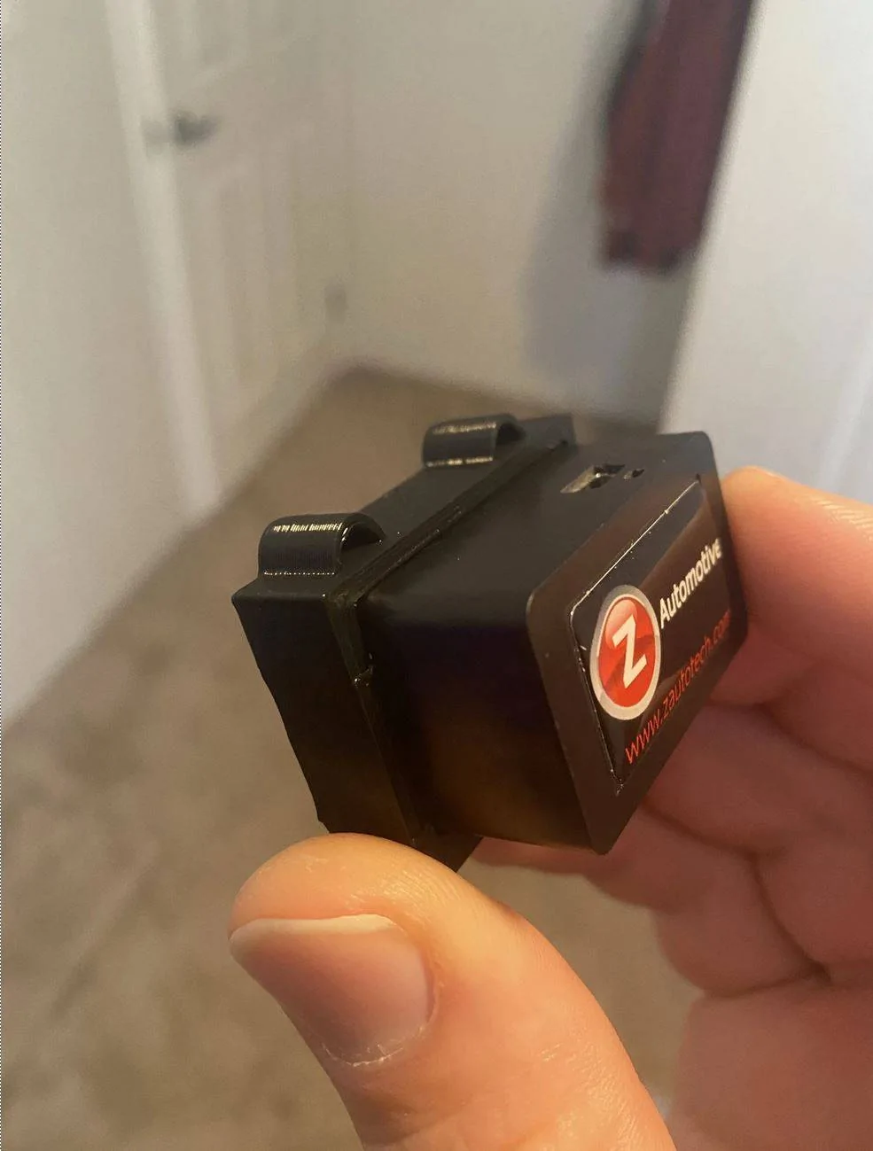

It's me, I'm the guy who makes these. Nice to meet you and thanks for helping put the word out!
I will say this, as someone that has owned and ran a 3D printing Cos Play business for a couple of years. The material he is using is PLA which starts deforms at 60c (140F) which is not hard to reach inside of a vehicle in the summer. It really should be made from ABS. Just a warning as this has the potential to fail in the summer. Just my .02 take it as you will.
Yes, PLA begins to deform at around 60c. When I came up with this I figured that, while it may get that hot on top of the dash in direct sun, it probably doesn't get that high in the footwell where this will be placed. Now that I see there is some interest in it, I have switched over to producing it in PETG which doesn't begin to deform until 170c which is nearly 400 Fahrenheit. If the interior of your JL gets that hot you have bigger issues than my mount getting a little soft ?
I haven't updated the product listing because I still have some PLA mounts in stock that I need to get rid of. If you see the listing as PLA then you have a 50/50 shot of getting PETG. I am trying to make sure to send only PETG units to hotter climates and PLA units for normal places like where I live. If you need to make sure that you get a PETG mount just drop me a note with the order or email us so we know you have that special request!
On that note, I have had one person who had trouble fitting their tazer into the mount, it appears that older models of the tazer have a slightly larger case? I'm not exactly sure. In an abundance of caution, I will say that you should make sure the logo on the front of your tazer is the same as mine to avoid any issues. I only have the one tazer you see in the picture, so that's what I designed it to fit.
Big Z in the middle: Might not fit
Z on the left side: Should work
Again, thanks for checking us out!
