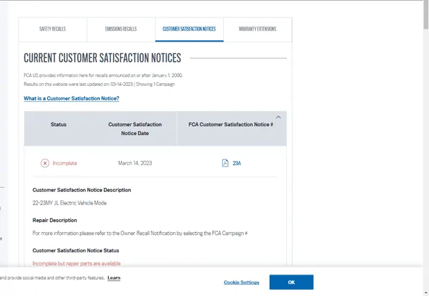

Got a message on the Jeep app about this new notice. Called local dealer and they were not aware of it but looked it up. Looks to be a software update for MY 22-23 JL Electric Vehicle Mode. They said that the software update was not ready but when it was I would get another notice. While the Notice shows as attached to the app and the website, when you try to download the file, it fails. Anyone else have any info on this?
Side note: Had to look up what defines a Customer Satisfaction Notice.
Per FCA: A customer satisfaction Notification (CSN) is preventive in nature and involves warranty or customer satisfaction issues that are non-safety related. FCA US LLC will correct the problem, at no charge, even if the vehicle is out of warranty and you are not the original owner.
Jeep Wrangler JL Customer Satisfaction Notice 23A 1678795756393

I just found this on the pdf.
The full electric vehicle mode on your vehicle may not be available due to an incorrectly
enabled engine maintenance mode designed to protect your engine from failure due to diluted
oil.
Looks like it has to do with FORM mode.

Wonder if they're only identifying this as an issue for some 4xes? It doesn't show up in my Mopar dashboard, though I was affected by the last 2 recalls and 1 customer satisfaction notification. I haven't entered FORM in over a year of ownership, so I'm not scrambling to get a "fix" I don't need ?
Here's the PDF for anyone curious: https://www.chrysler.com/universal/webselfservice/pdf/23A.pdf
"WHY DOES MY VEHICLE NEED REPAIRS? The full electric vehicle mode on your vehicle may not be available due to an incorrectly enabled engine maintenance mode designed to protect your engine from failure due to diluted oil.
HOW DO I RESOLVE THIS CUSTOMER SATISFACTION NOTIFICATION? FCA US will repair your vehicle free of charge (parts and labor). To do this, your dealer will reprogram several electronic modules. The estimated repair time is about 30 minutes. In addition, your dealer will require your vehicle for proper check-in, preparation, and check-out during your visit, which may require more time. Your time is important to us, so we recommend that you schedule a service appointment to minimize your inconvenience. Please bring this letter with you to your dealership."
