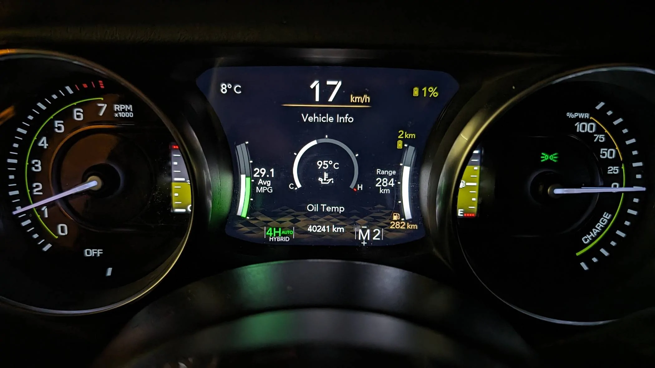

I used to do E-Save charge, now I use the manual shifter, in the city, within 30 minutes I can get the temp to 100
I hate the stop|start that's why I was using e-save charge.
Before I put it in manual, I e-save charge to get it warmed up, then shift to manual, then put it in Hybrid.
When I'm back at a charger, I'll take it out of manual, take of the HVAC, then put it back in electric before shutting down.
I find E-Save charge only gets the temperature to around 90, vs manual 95-100 range.
Jeep Wrangler JL FORM - What Can Jeep Do to Improve Customer Interface 1000016524
