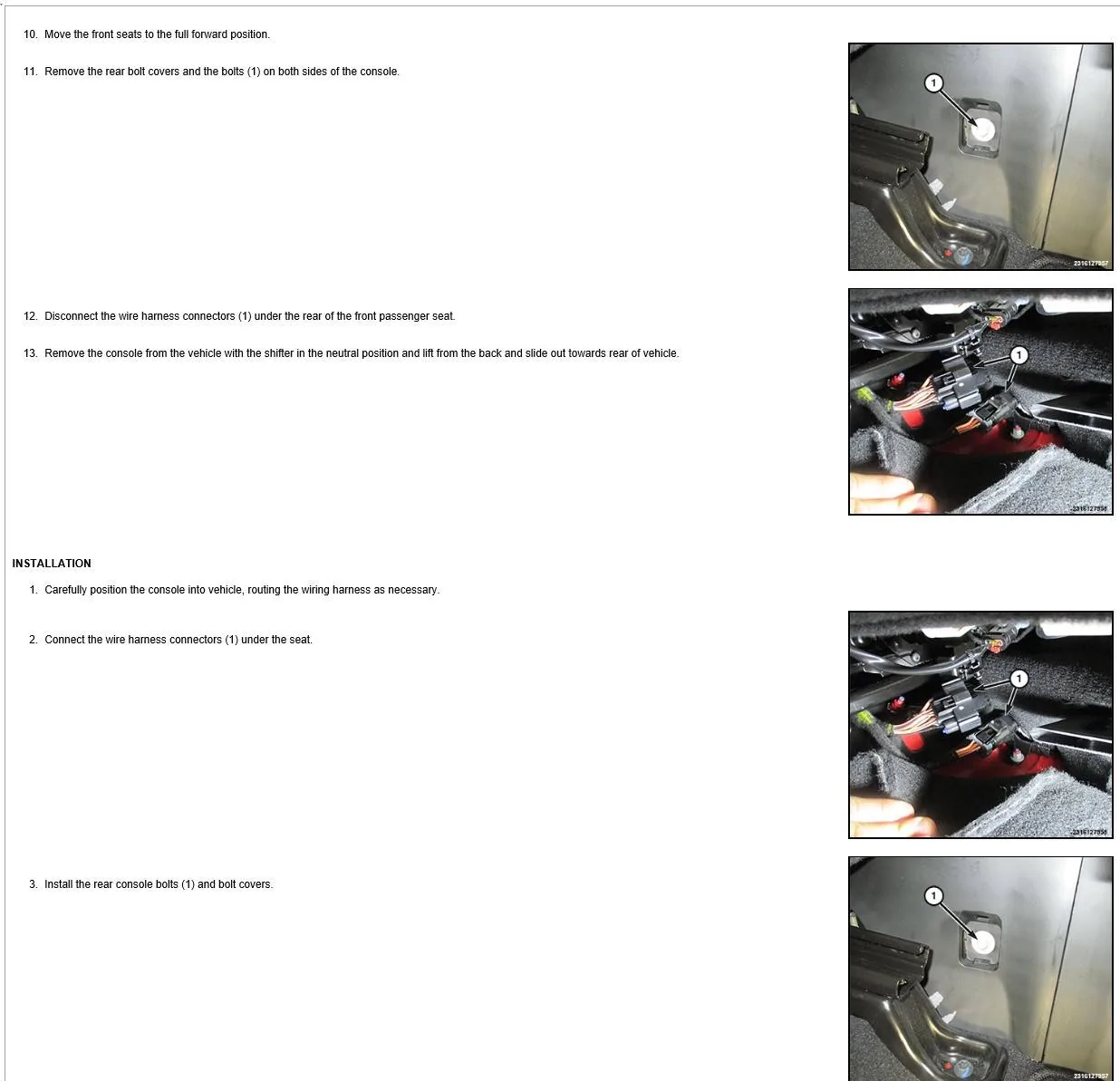

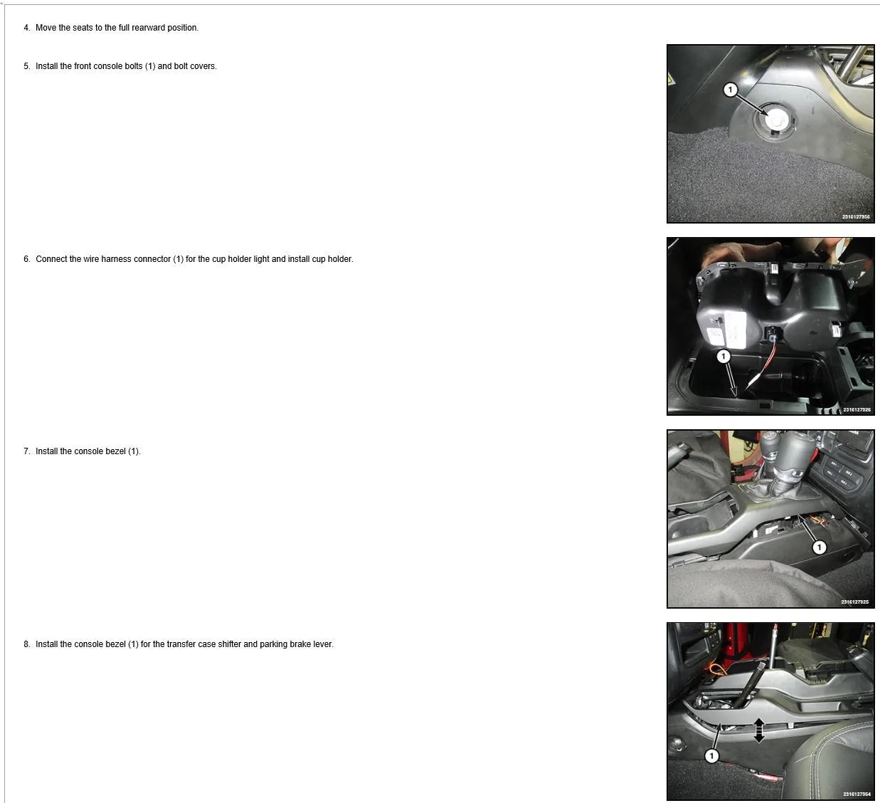

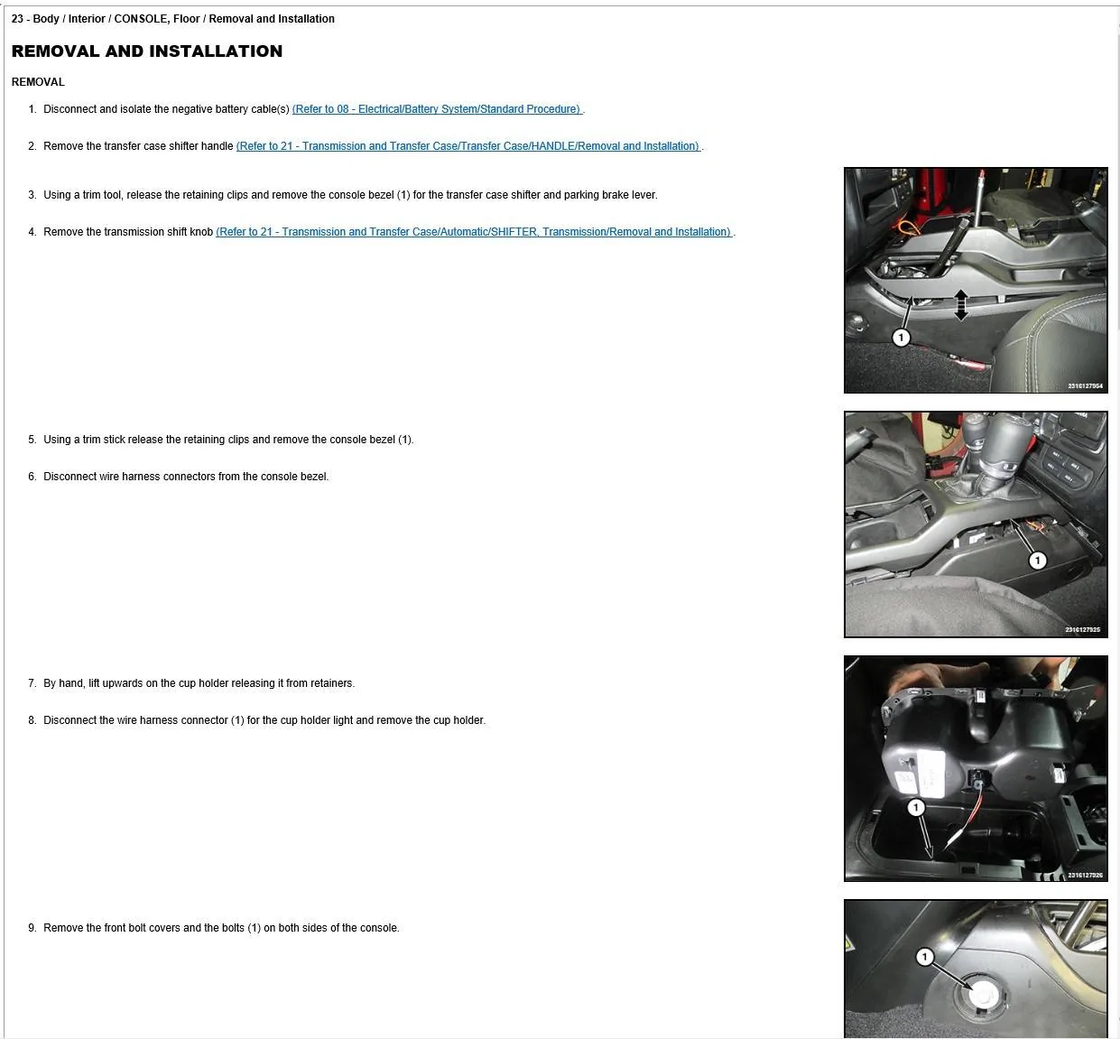

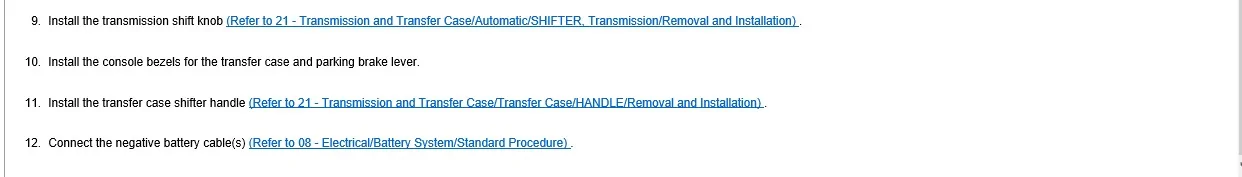

Here's what I have from my manual on the console
Jeep Wrangler JL Cup holder fuse? console 1
Jeep Wrangler JL Cup holder fuse? Console 2
Jeep Wrangler JL Cup holder fuse? console3
Jeep Wrangler JL Cup holder fuse? console4
