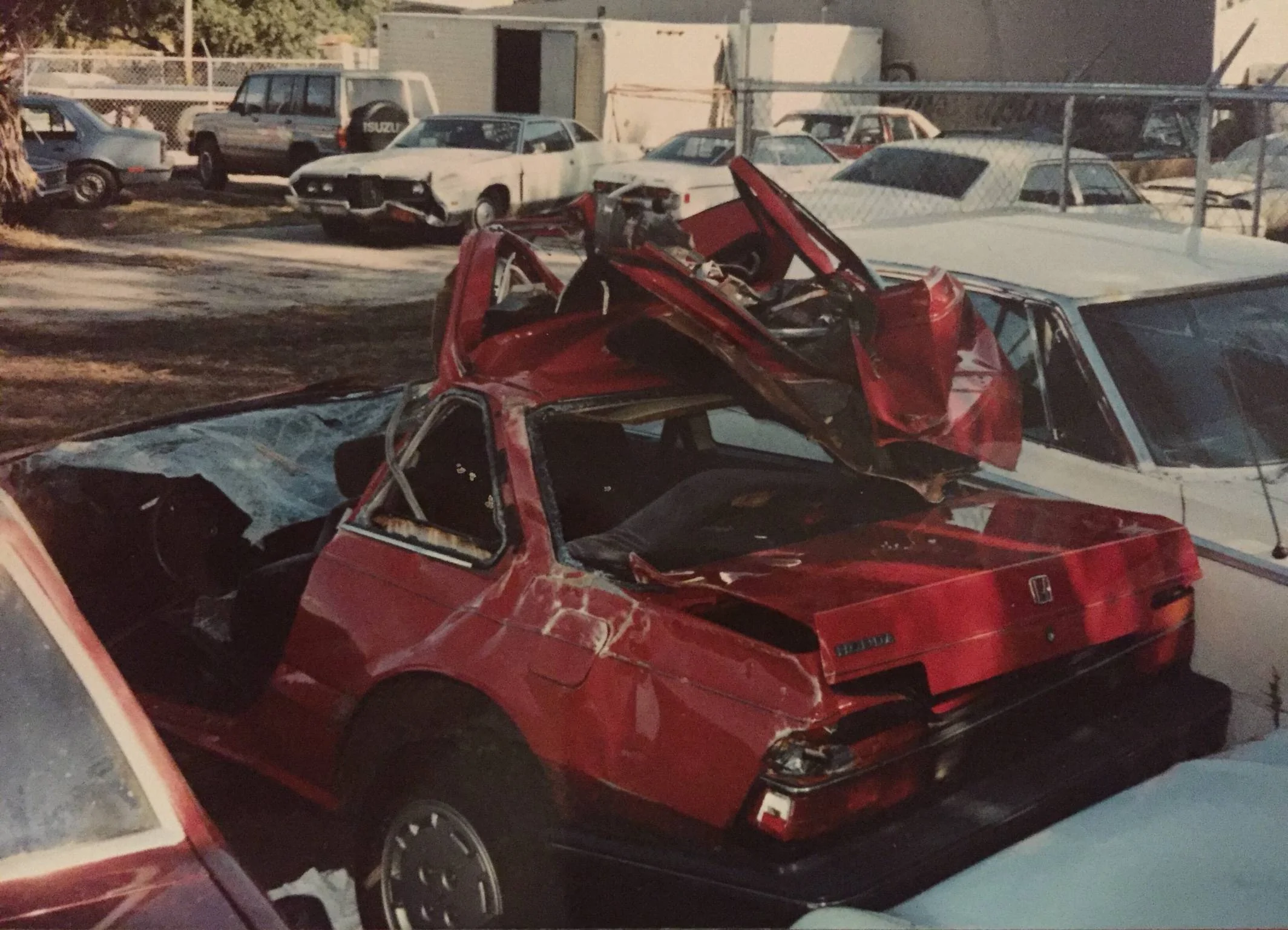

Beautiful thing brother ?? 32 yrs here. This pic was my stupidity, broke about every bone in my body being ejected through guide wires, but best thing to happen to me. Was very blessed no one else was hurt.

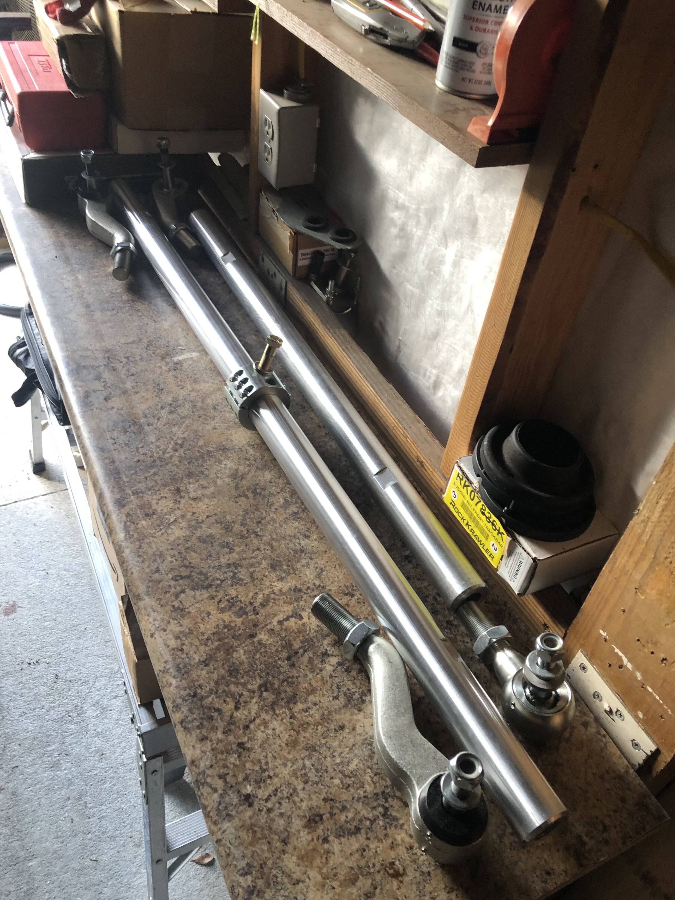

Got my steering bars…… as usual, Marcus took care of things. I ordered on Thursday, got them on Tuesday…….. if you guys need anything, check out @River City Offroad first, great customer service, never had him not pick up the phone, and forum members discount……..

Got a late start today, but me and Colby got it done. Went pretty smooth…..hardest things was getting the jamb nuts to 250 ft lbs, ( had to buy a 18” crescent wrench to hold the bar with while using crowfoot/torque wrench ) and adjusting the EC ( sometimes I can get it on the first try, other times it takes several adjustments) .:facepalm:
I was able to make the EC work, although, I might try the steersmart axle bracket at some point. I had to roll the tie rod clamp back so the EC would be parallel with the tie rod…..
Took it up on the ramp both sides to check clearances. I was most concerned about the track bar contacting the bolt on the clamp, but it seems ok…….it’s gonna take me a minute to get used to the bling ……?
Some pics……
