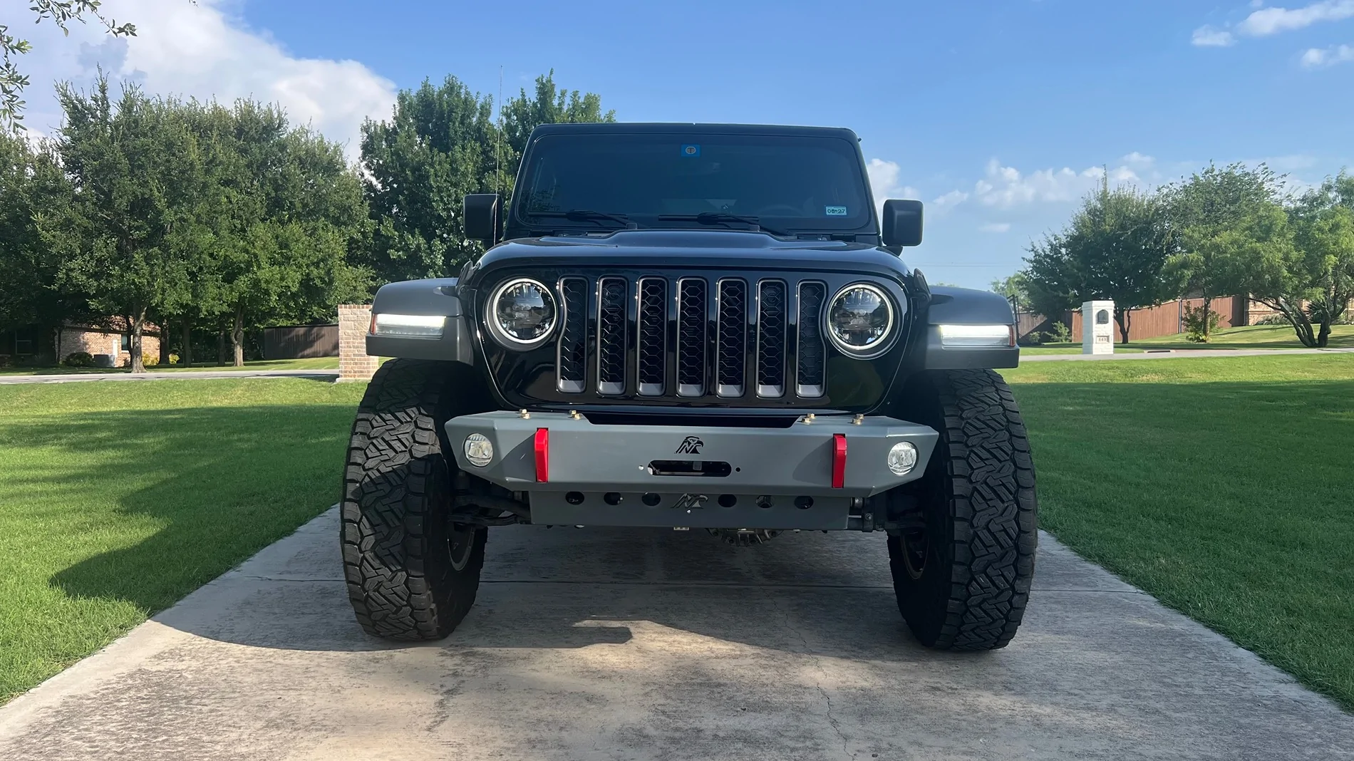

As you can see in the photo my grill is not obstructed at all, in fact it theoretically is more open than before but the results speak for themselves.
Before

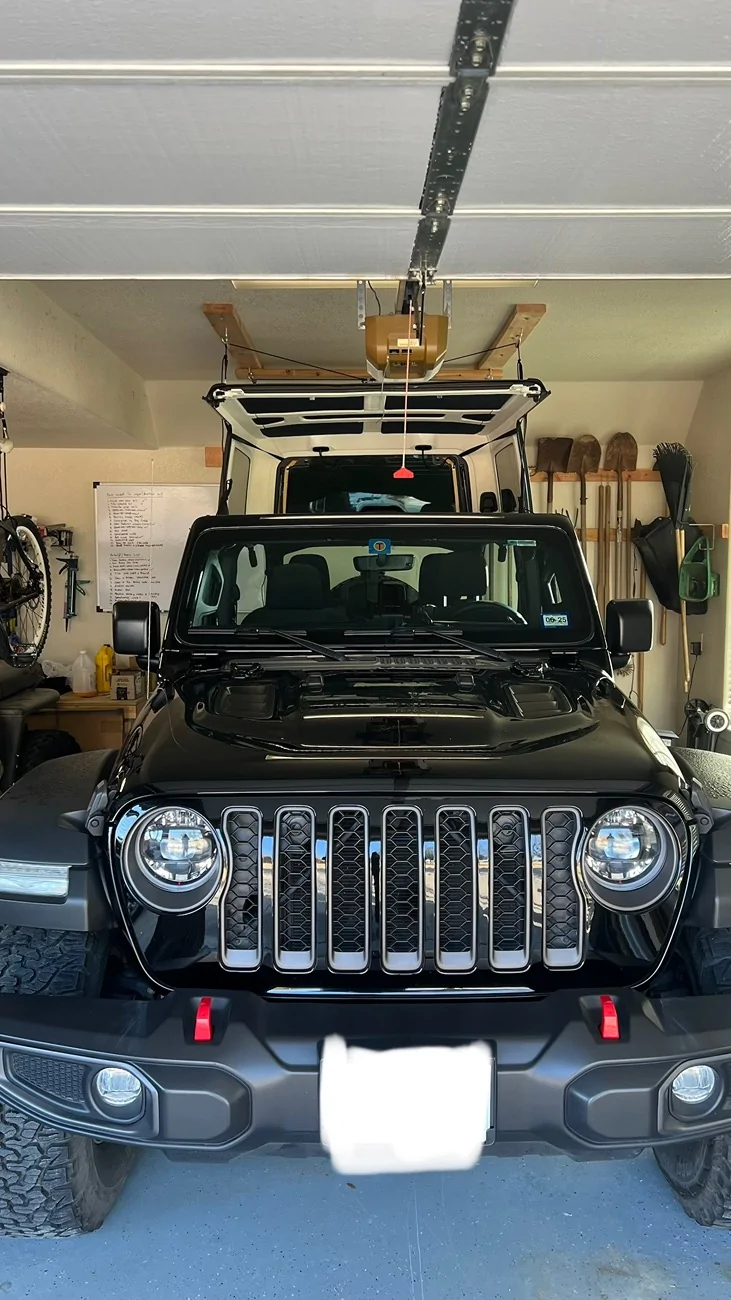

Jeep Wrangler JL Cooling System Observations IMG_7900
After

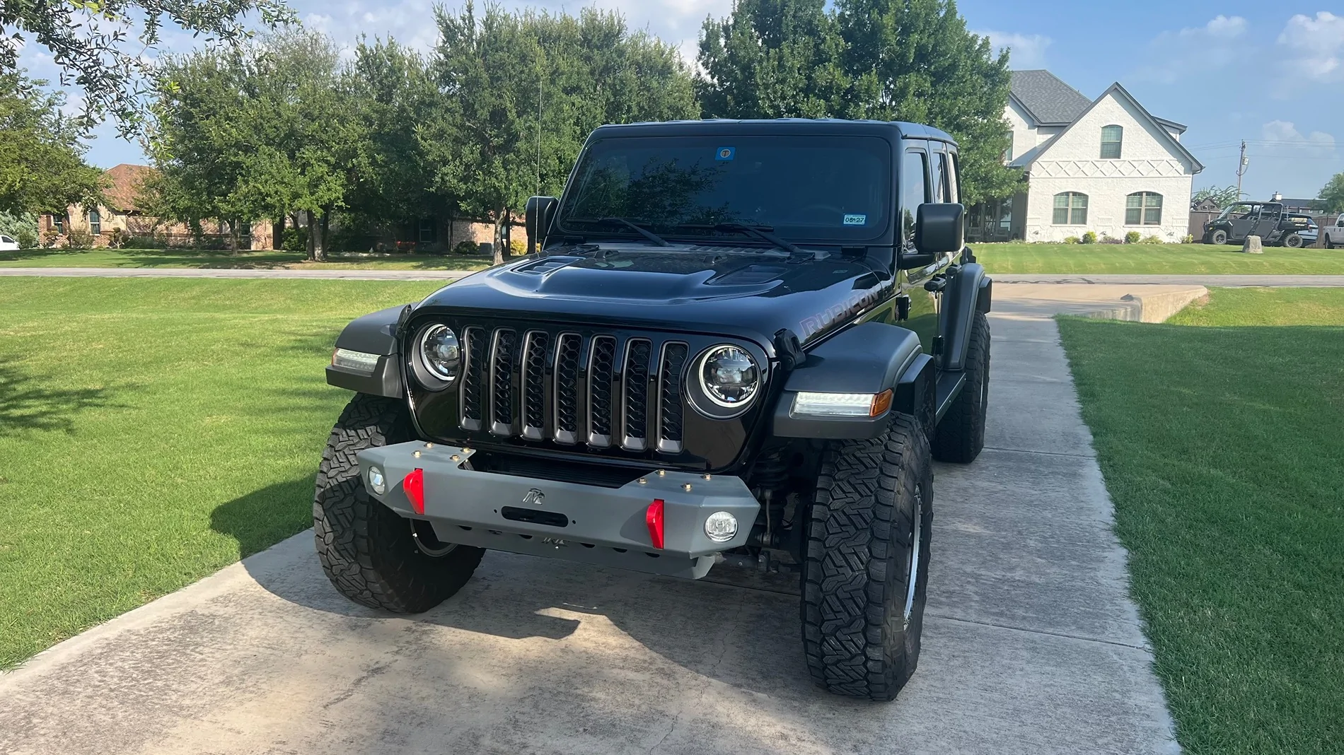

Jeep Wrangler JL Cooling System Observations IMG_0265

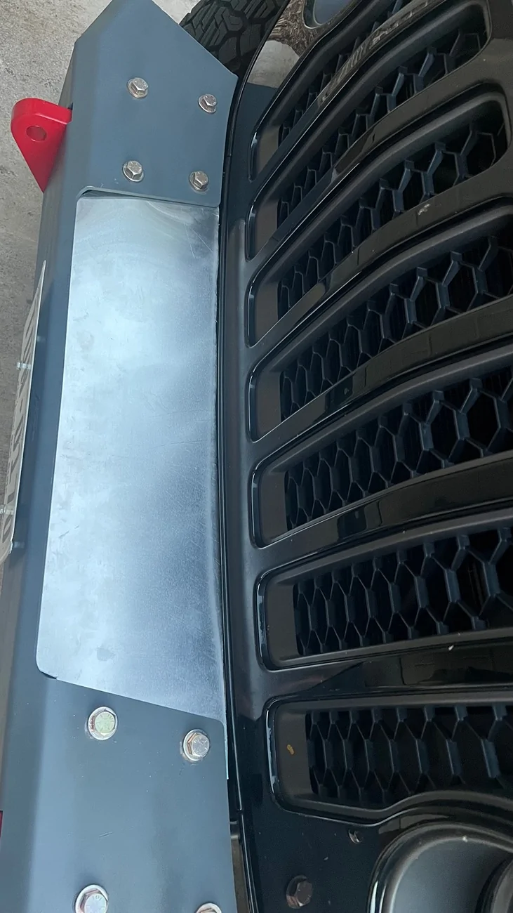

I’m going to try to create a blocking plate and see how it changes the temp behavior. Here is a photo of access where I don’t currently have a winch.
Jeep Wrangler JL Cooling System Observations IMG_0271
I’ll also try blocking the lower skid plate as well.

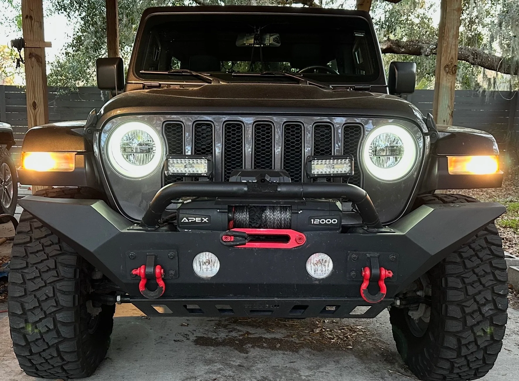

In 97-101 ambient temperatures in humid and flat Florida, at 70-80 MPH I’m at 210-215 for coolant temps. This is my front end configuration, 2.5” lifted JLUR 2.0 on 35s.
While accelerating, temps will go a few degrees higher, but then settle down quickly at cruising speed. It never goes above 197 while idling in full sunlight indefinitely.
From my research, I am comfortable with these temps.
