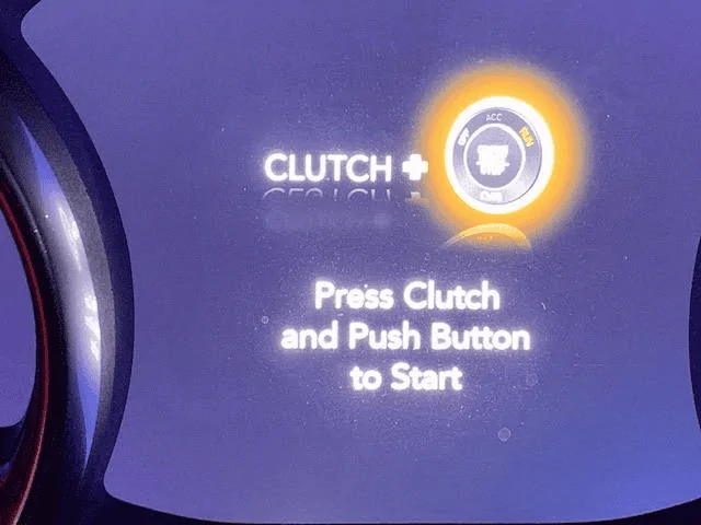

Apparently over the weekend my 2018 JLR V6/Auto received some sort of software update. It's now very confused and thinks it has a manual transmission. Went to start this AM and saw this message on the screen.
Jeep Wrangler JL Confused Jeep 1591004108978
Fortunately it was just a displayed message and not some overly integrated thing that was actually looking for input from a clutch sensor somewhere and was able to start normally. I didn't have time to dig through everything else to see what has changed, but on quick observation, in addition to the clutch message, my odometer display is gone, as is my ability to configure the instrument cluster to display the info I want.

I have the same exact issue with mine. I also have the 999999 odometer issue, but I haven’t had a chance to get it taken in for the bulletin software flash.

I think I'd actually be happy with the 999999 odometer. Mine is just gone altogether. Maybe this means my warranty will last forever.

Did you ever find a fix for this problem? My 2018 JLUR, 3.6, automatic just started doing the same thing at 44,000 miles. It's intermittent......the first thing I did was reseat the relays and made sure the fuses were seated.

Yep, there was a reflash that took care of it. Took about an hour for them to check everything and re-boot.

Thanks! Do you happen to know the TSB number? Maybe I could advise the service department.
