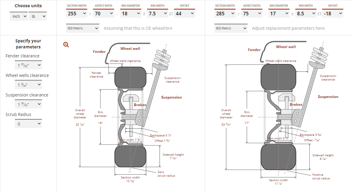

Use your own measurements, and this calculator to show you where you're poke will end up: https://tiresize.com/wheel-offset-calculator/

If you list the width and offset for each wheel, I will calculate approximately how much they will “poke” from the fender mounted with a 285/75/17 tire.

I am running the Fuel Rebel 5 wheels 20x9 with a +1 offset and 35x12.5x20 BFG K02 tire on my JLU. They extend 2.5 inches from the fender.
With that said a 285/75 tire has a width of 11.2 inches so I would expect a 285/75 tire mounted on a 17x9 +1 wheel to stick out approximately 1.2 inches. With this you now have a known to enter into the wheel offset comparison calculator to compare different wheels too. So the KMC KM544 Mesa is a 17x8.5 +0. When compared to a 17x9+1 it retracts the outer position by 5mm (.19 inches) from the 17x9+1. So with a 285/75 it would stick out approximately 1 inch. Hope this makes sense.
