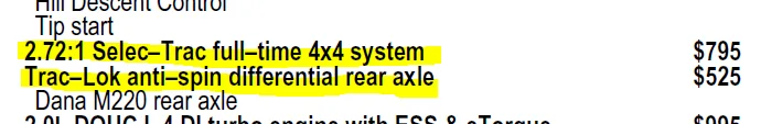

If you are looking at the JLs,
LSD (trac-lok) is available on Sahara trim when you option in Selec-Trac feature. (Which also gives you the beefier M220 axle)
Yea, my daughter's 02 Grand Cherokee has Selec-Trac with open diffs. The build on this one says Command-Trac with no mention of LSD. The dealer printout they put on the side of the window says Brake Actuated LSD which yes, it does act like a
lsd but it's not a true LSD which I prefer and would be a plus if it has Command-Trac with LSD.
