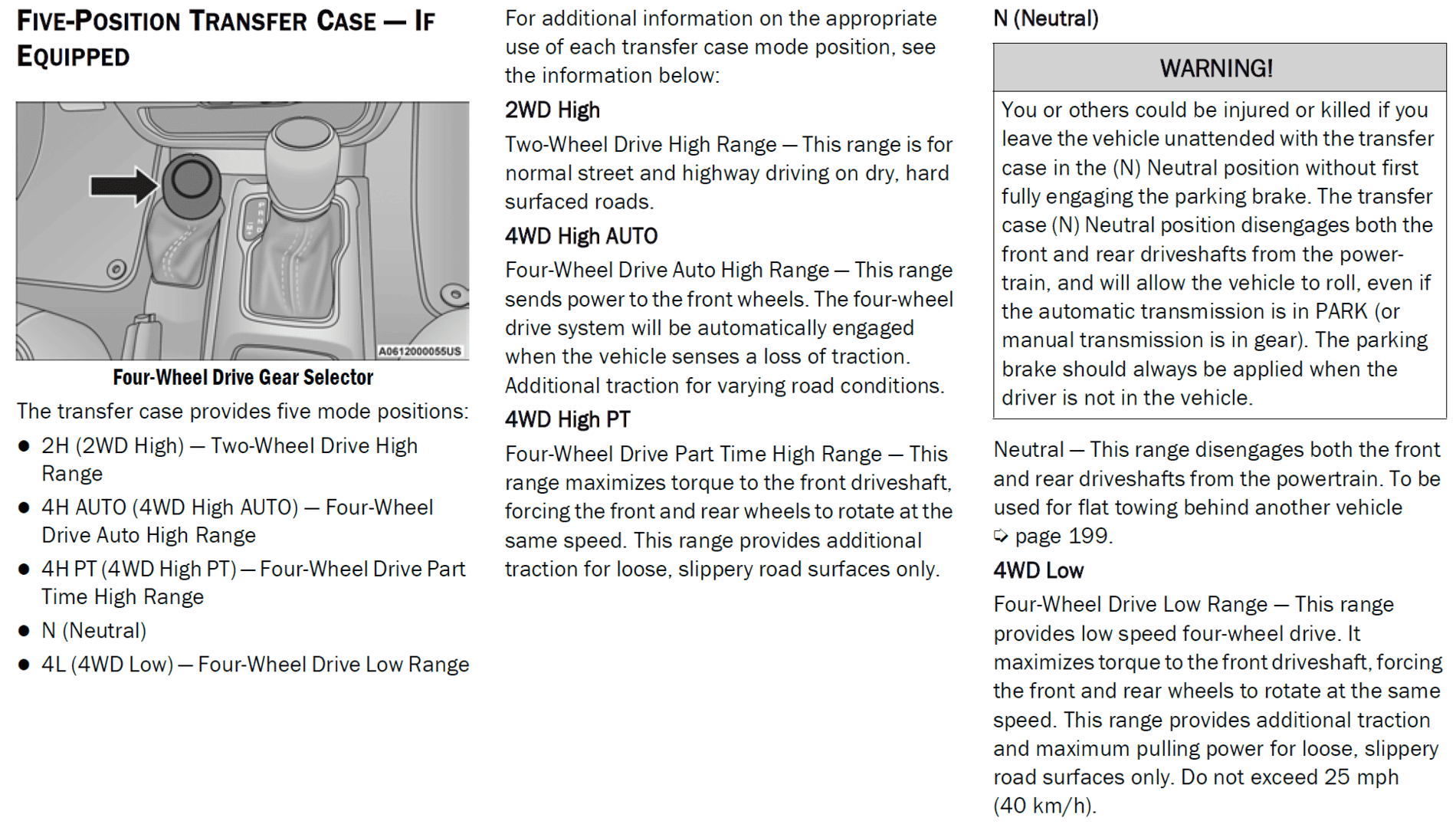

The standard transfer case in (almost) all wranglers has a part time 4HI configuration. That locks the front to rear inside the transfer case. The low range in the Rubicon is different than the others but they all have the same shift modes.
There is an optional transfer case that gives you a full time 4HI option. I don't know if that comes standard on any trim level for sure. Even the Rubicon has the optional full time transfer case. From what I read (and anyone correct me if I'm wrong), you get an extra shift position. You still have 2hi/4hi part time/Neutral/4lo like the standard case but it adds one so you get 2hi/4hi part time/4hi full time/neutral/4lo.
I don't know how often people buy the full time transfer case. But for the most part, you will find the part time (front locked to rear) as standard.

I have a '19 Rubicon now. I am thinking of buying a new Rubicon. I see a new option.
What's this 4:1 Rock-Trac Heavy-Duty Full-Time 4 wheel-drive system? Any advice or opinions on this option?
