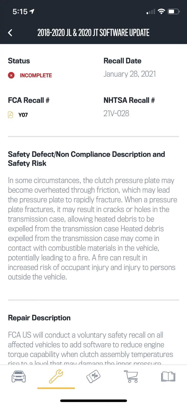

Dealers don’t know details like these. If you read through the gazillion pages of the thread dedicated to this recall you can see JeepCares chimes in a few times. It’s confirmed to be a software fix and its number is Y07.
I bet we see it at the end of this month or early next. Just my guess.
Taken from my Jeep phone app just now:

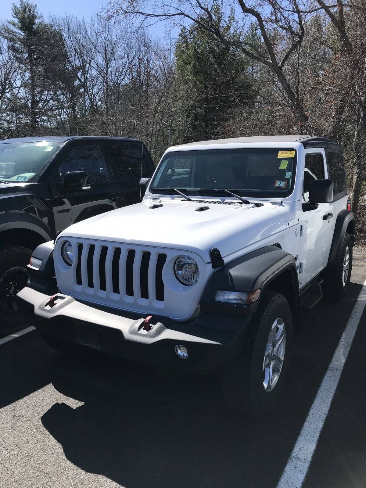

I hope your guess is right. This Wrangler was a rare find, having the few must haves - 2 door S with anti slip and soft top. The bonus being low miles (22K). Worth waiting for, I think.

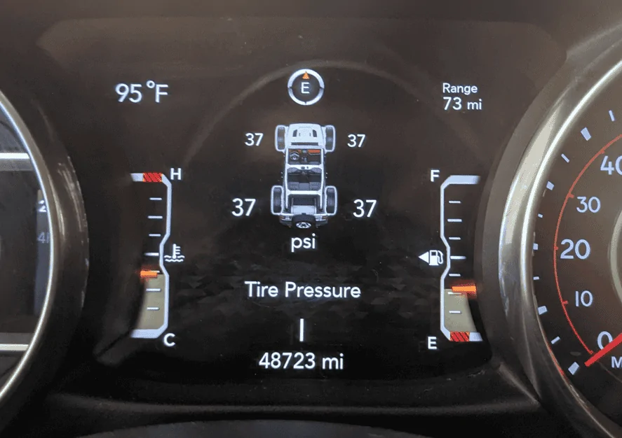

I have a 2018 (very early build, for a 2 door) manual Rubi. I got the letter for the recall about a month ago. I'm not new to clutch issues, I've been complaining to my dealer about the clutch vibration (Relevant thread) since day one. I guess the consensus is that this is rev hang? That's still happening. Anyway, I didn't think much of it and didn't even read the explanation about de-powering and torque management.
I scheduled the work and I've had it back for about a week now. I haven't noticed any difference in power or torque at all. I run 35" Patagonia's, so I figure I should have noticed something. Now that I know my torque could be throttled I'll be looking for it, but so far nothing.
The only thing I have noticed is that now I have an indicator to tell me what gear I'm in. Really confused me when I first saw it driving home from the dealer. "3? what does 3 mean?" Pulled up to the stoplight to run through my dash settings and it was reading "N". That's when I figured it out. As far as I can tell, there is no way to turn this off. Not a big deal, I guess it could remind me to shift into 6th on the highway. Very strange that this wasn't always there. Clearly the hardware is in place to read the gear, the software was just suppressing it for the last three years. Really makes you wonder what else our Jeeps COULD do.
Jeep Wrangler JL Clutch recall and fix question 1628262960751
Other than the unpleasant clutch vibration, everything has worked fine all this time. 35k miles before the recall for the exploding pressure plates, and nearly 50k miles before this software update. I'm guessing mine would have been fine without either of these recalls. They're free, whatever. FCA is just casting nets to catch intermittent failures, which is a good thing in my opinion.
This is expected. It will only go into limp mode if you are a phenomenally bad driver and slip the clutch like crazy, *or* if your clutch is failing and slipping on its own.

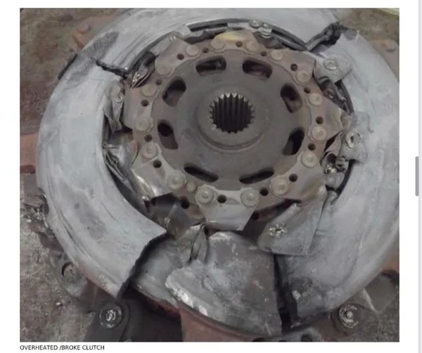

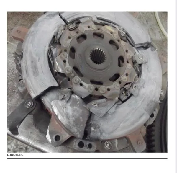

I was ready to join your club when I purchased a low mileage 2018 2 door manual last weekend. Because it was a CPO, the dealer needed to go through it thoroughly to make sure it was worthy of the extended warranty offered in that program. Well, it turns out there is a stop sale order on it until Jeep comes up with a fix for the clutch plate recall. Everyone talks about a flash that de-powers or reduces torque under extreme circumstances, which does not sound like a viable solution.
They killed our deal and the Jeep will sit on the lot until they have a repair plan in late June. So my question is, do the manuals shipping out to dealers now have a similar band aid fix or has Jeep installed an improved clutch on those units? My dealer has no idea how to answer this because he deals in "very few, if any, manuals". In other words, he doesn't really care.

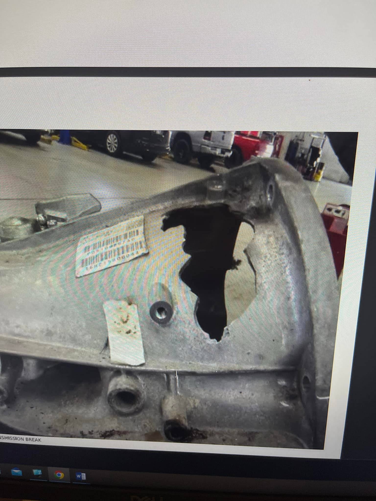

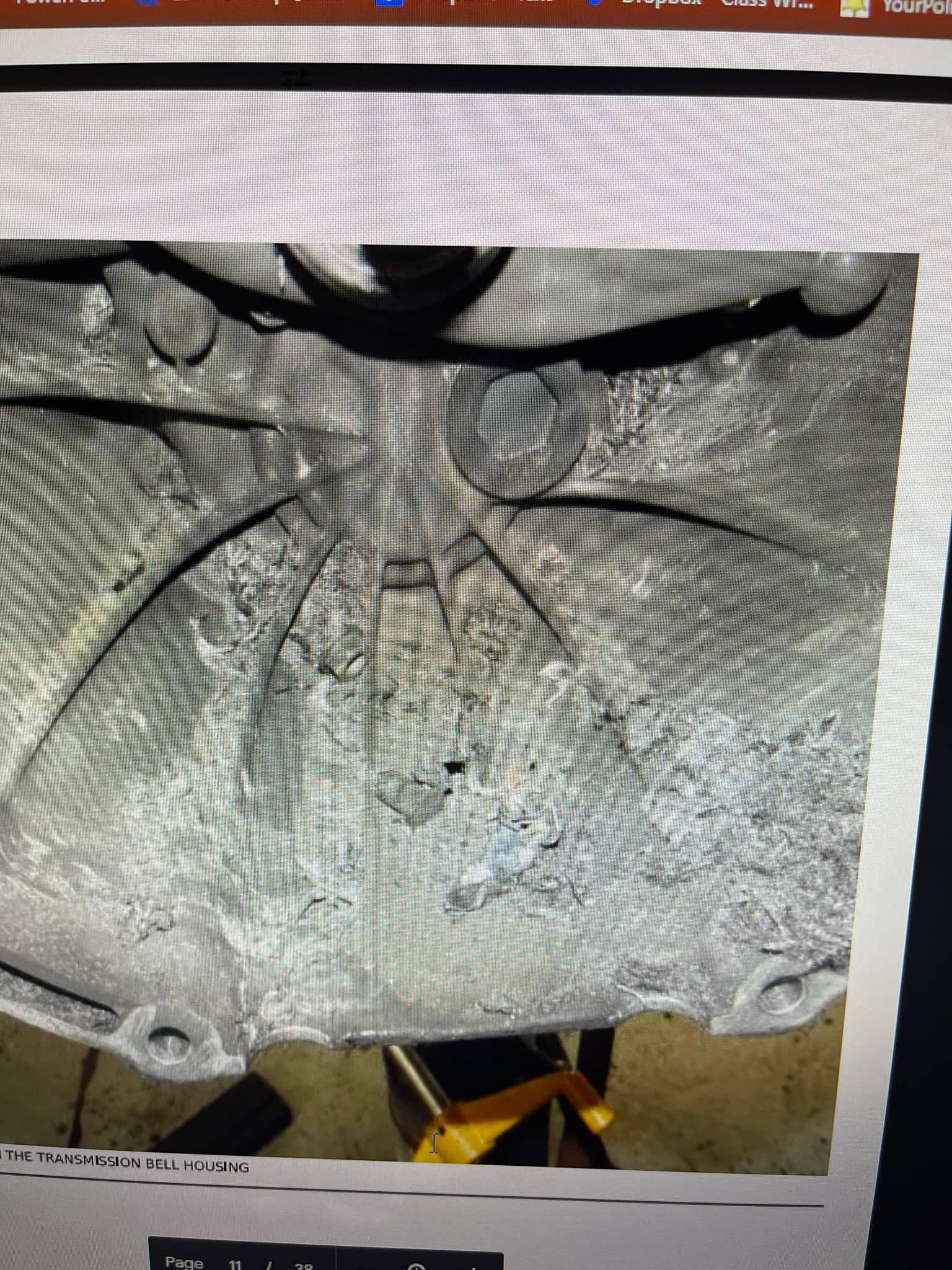

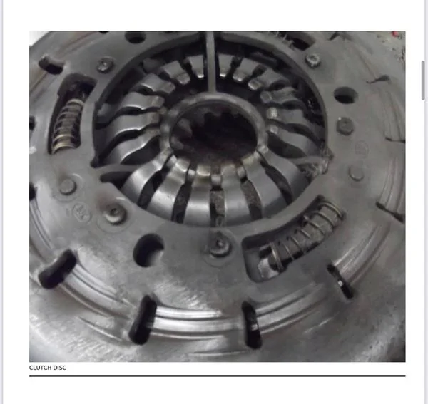

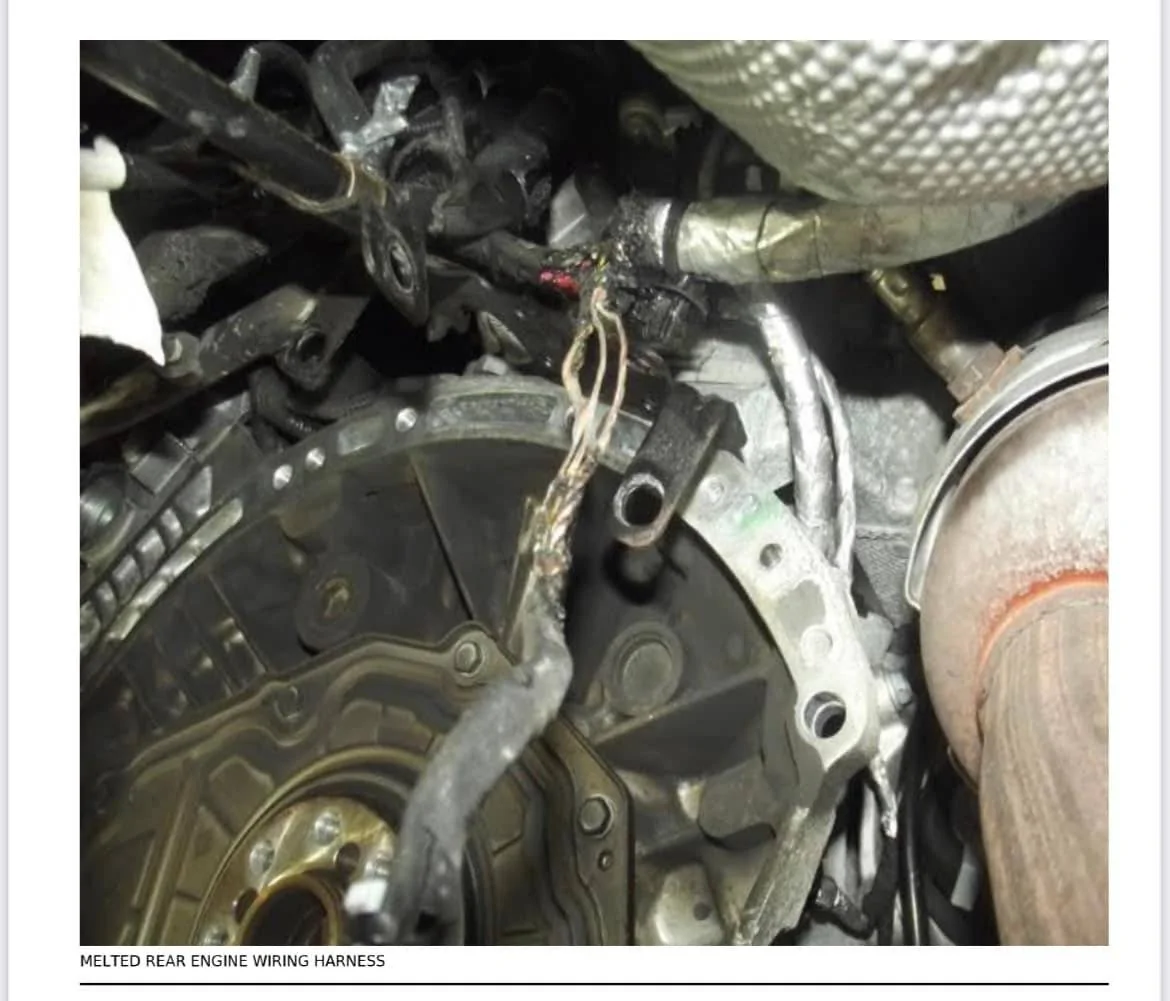

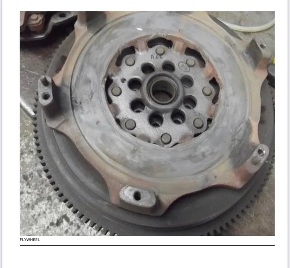

The 2018 - 2020 Jeep clutches that replace damaged clutches when they fail are the exact same clutch - no changes have been made to any components. My clutch plate overheated and exploded in my 2018 Jeep Wrangler JL Sahara Unlimted and their fix (not covered by the Powertrain warranty) is to simply replace the clutch. It's been a nightmare!

Very obviously a defective clutch design and/or manufacturing defect. Even an abused clutch should not grenade like that.
How many miles on your Jeep?
