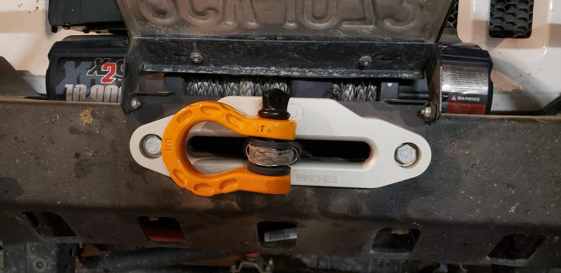

Thoughts on this set up versus a Factor 55?
Jeep Wrangler JL Closed Winch Set Up 20200609_204525
Seems fine as long as you have some soft shackles and some other rigging straps. I’m no pro though.

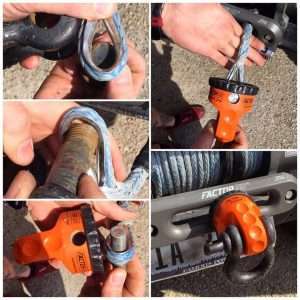

I remember Factor55 had this question on their FAQ:
Q; Why cant I just run a shackle through the end of my winch line?
A: Most thimbles are designed to collapse under hard pulls. When this happens trying to run a standard 3/4 shackle pin through the end of your winch line is impossible.
Jeep Wrangler JL Closed Winch Set Up factor55

it is fine, it gets you the same benefits for a fraction of the cost
looks like factor 55's argument against it is more you might not be able to use our product then so use a 3/4" shackle

that will work just fine. it just a simpler and cost effective way in winching. also by going that route you dont have to worry about the line falling off the hook, etc.
