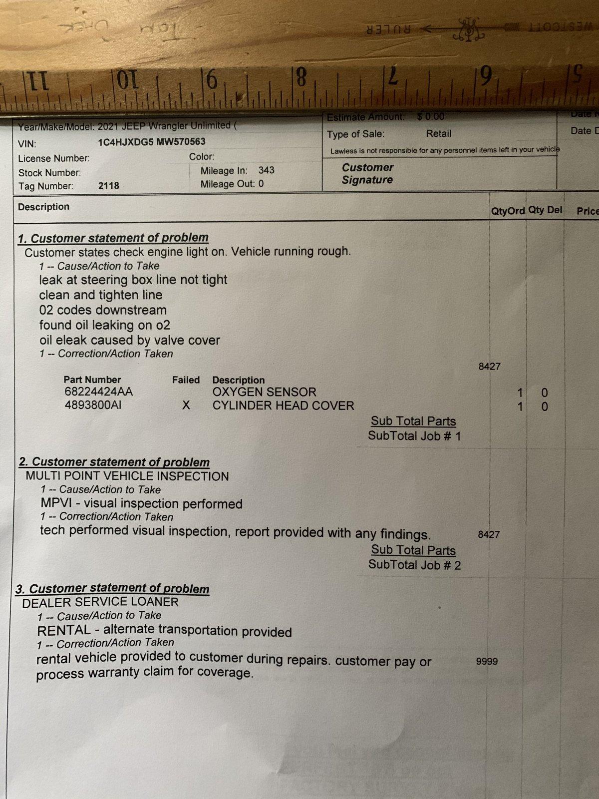

Here is the work order for my Jeep at the dealership.
On a related note, my Jeep is at the dealer for almost a month now as the new valve cover (part number 4893800AI) was put on backordered through the supplier.
Jeep Wrangler JL Check Engine Light - Code p0137 8528EEF4-3681-4490-98F7-1EFC37B11B18
This is unlikely to fix the running rough issue, but it may.

Why wouldn’t it run rough if the oxygen sensor fail and throw a code?
Oxygen sensors, especially the downstream sensor, monitor cat converter efficiency. Of course it’s possible that for emissions regulations purposes, the new engine is programmed to read them and adjust fuel input. Do you know which specific codes you had when you went in?

P219B was the code when it went in. Oxygen sensor bank 2 fail.
that would be a bank 2 air fuel ratio code, further diagnosis needed to confirm the failure being the sensor.
the more obvious “sensor failure” codes are circuit related, open or short circuits bring readings outside of normal bands and it sets codes.
