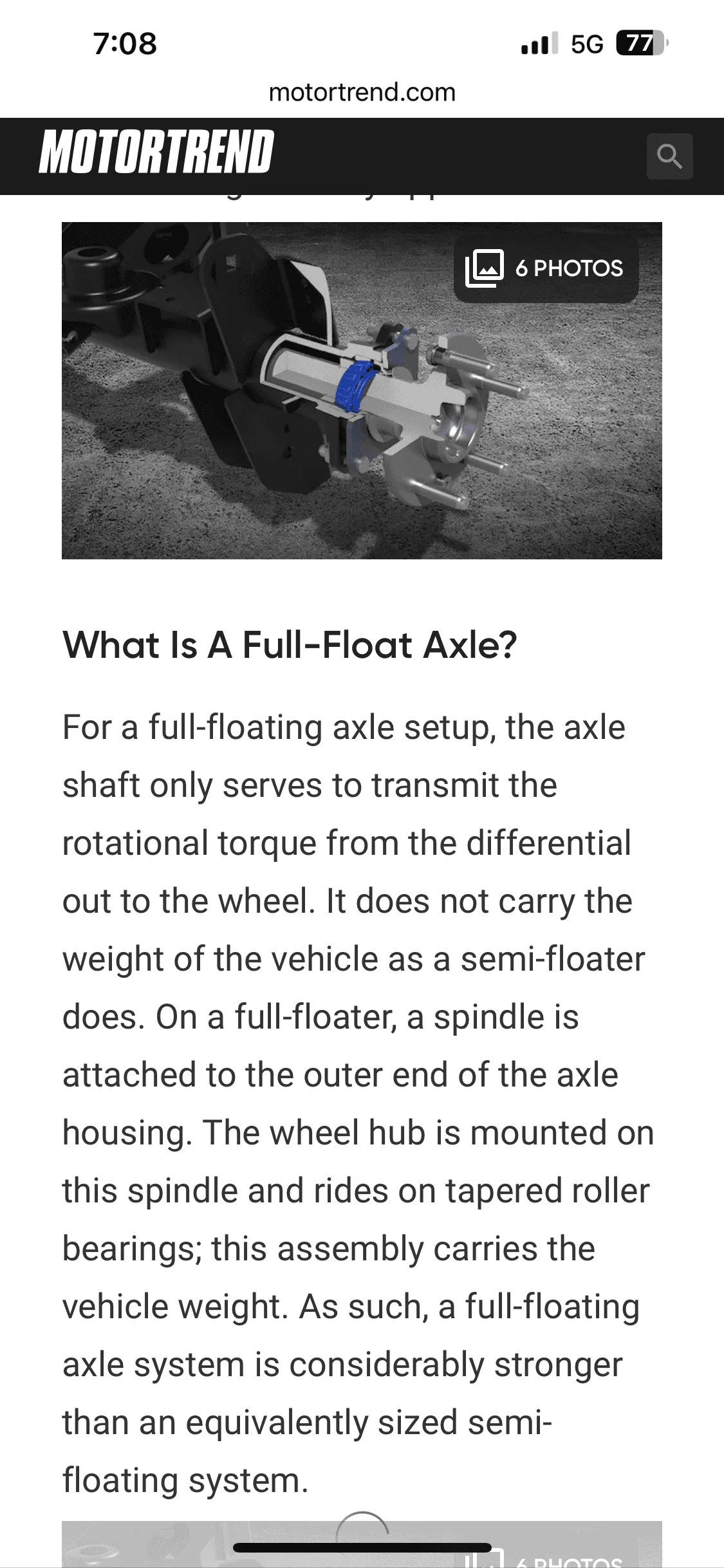

First of all, an Axel is a figure skating move. The full-float axle is in the rear. There are no changes to the 2024 front axle. The FAD delete people are talking about is on the models with the auto transfer case. The FAD cutout is still there, so the tube isn’t any stronger.
